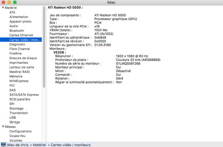

chris1111 Posted September 23, 2017 Share Posted September 23, 2017 For those who are interested I just bought a great little Graphics Card on KIJIJI Saphire Radeon 5570 For the modest sum of $ 45 This card is native any version of OS X from 10.6 to 10.13 on Delll Optiplex 790 Very Silent in addition, Working plug in play with my SSDT Patch I just put out my 5450 and put in the 5570 et Voila EDIT*** I have just made a test without SSDT patch with only Inject Ati and the card works natively NO Fake ID Clover Original Device ID is 0x68D9 Sleep and wake works natively and HDMI AppleALC EDIT *** I remove the <key>FBName</key> <string>Cedar</string> and now its show the exacte name EDIT*** but to have my two screens on my two GPU I have to add the FB and sacrificing the name Link to comment Share on other sites More sharing options...

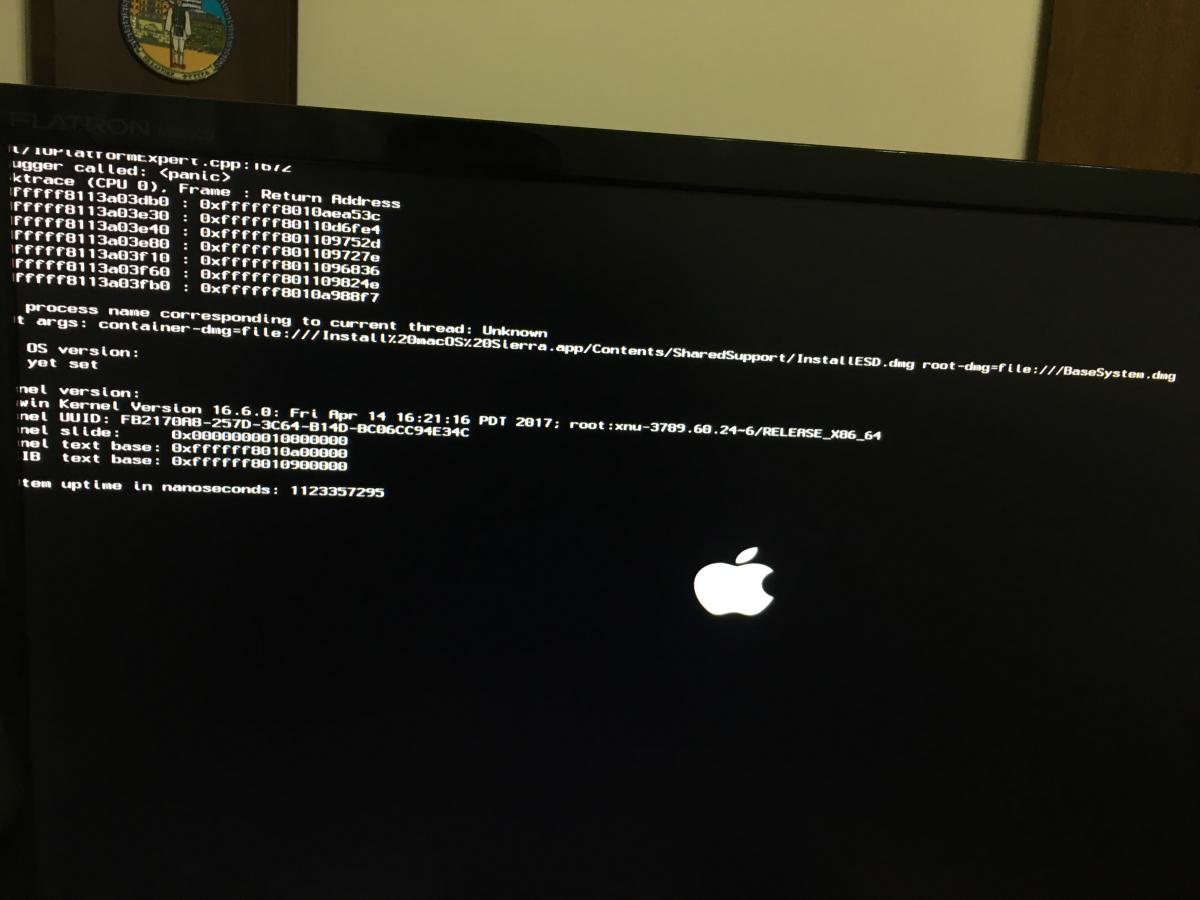

sakis6977 Posted September 26, 2017 Share Posted September 26, 2017 New error. I boot from usb and i see this error now. In clover i just install all drivers64 and rc on target. update: F***....... This error was without my config.plist and kext 10.12. If i put my config.plist and kext as the guide said i see the same error with red letters. What i'm doing wrong????? Please help.... Link to comment Share on other sites More sharing options...

MacPeet Posted September 27, 2017 Author Share Posted September 27, 2017 @nguyendj audio works now? You can better switch to AppleALC method. If you need help, please contact me. @ sakis6977 Install Sierra or High Sierra? Link to comment Share on other sites More sharing options...
