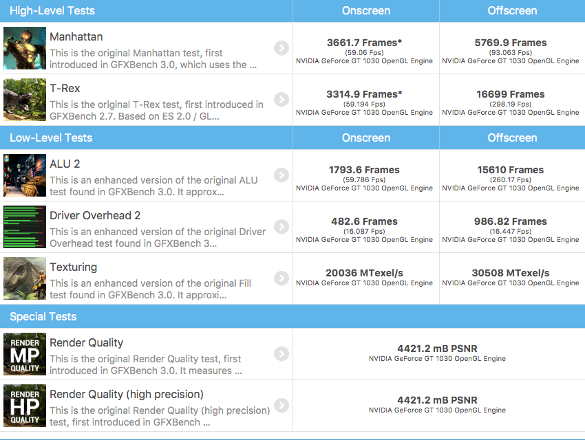

marsil.novitio Posted September 10, 2017 Share Posted September 10, 2017 @MacPeet I reinstalled all from begin! Used your DSDT and tried ur config.plist Now audio works, but only behind and front (detected when plug in headphones)...no HDMI My DSDT and config.plist Archive.zip I think the rest works well! My 780: Core 2 Quad Q9550 8gb Ram Gt 1030 Gigabyte Here Usb WiFi Edimax EW-7811Un GFXBench GL Next step: install windows 7 pro on Free Partition! Link to comment Share on other sites More sharing options...

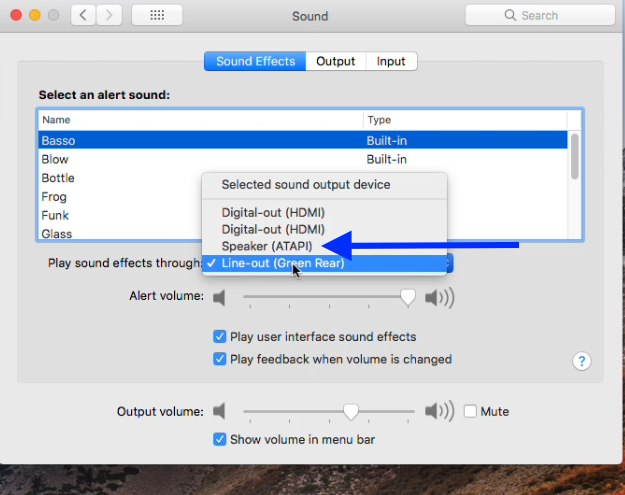

Goldfish64 Posted September 12, 2017 Share Posted September 12, 2017 Does anyone have the internal speaker working? Link to comment Share on other sites More sharing options...
chris1111 Posted September 12, 2017 Share Posted September 12, 2017 Does anyone have the internal speaker working? You have this with VoodooHDA 2.9.0 Speaker (ATAPI) 1 Link to comment Share on other sites More sharing options...
