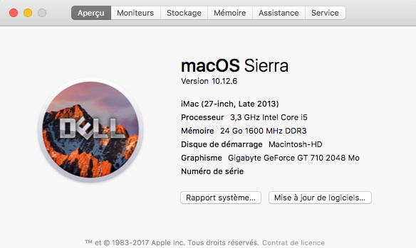

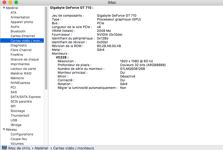

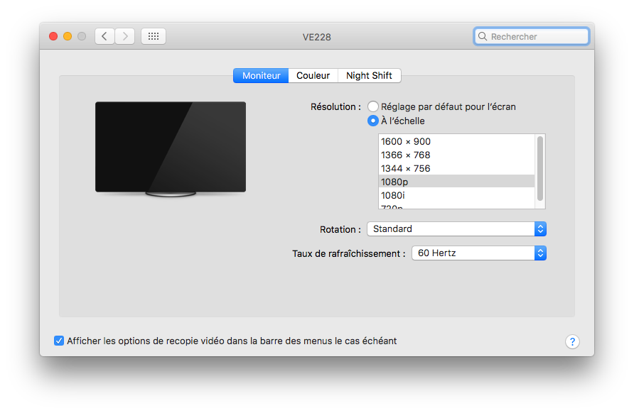

chris1111 Posted August 31, 2017 Share Posted August 31, 2017 I was try it before but again i didnt have full hd resoloution. So i buy the randeon! I will try it again and i will tell you. I have this one also @ricoc90 have this card Works OOB Geforce GT 710 Gigabyte Link to comment Share on other sites More sharing options...
Guest ricoc90 Posted August 31, 2017 Share Posted August 31, 2017 The GT 710 indeed works OOB. Both my Optiplex 755 and Optiplex 790 are working great with this card. Link to comment Share on other sites More sharing options...

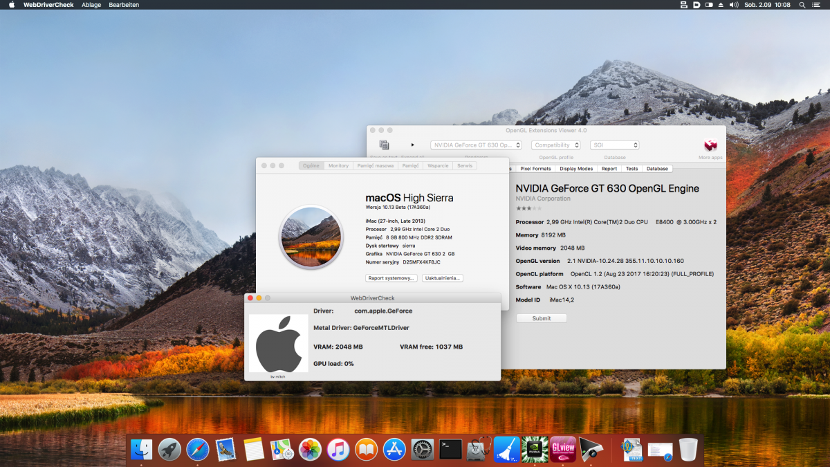

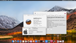

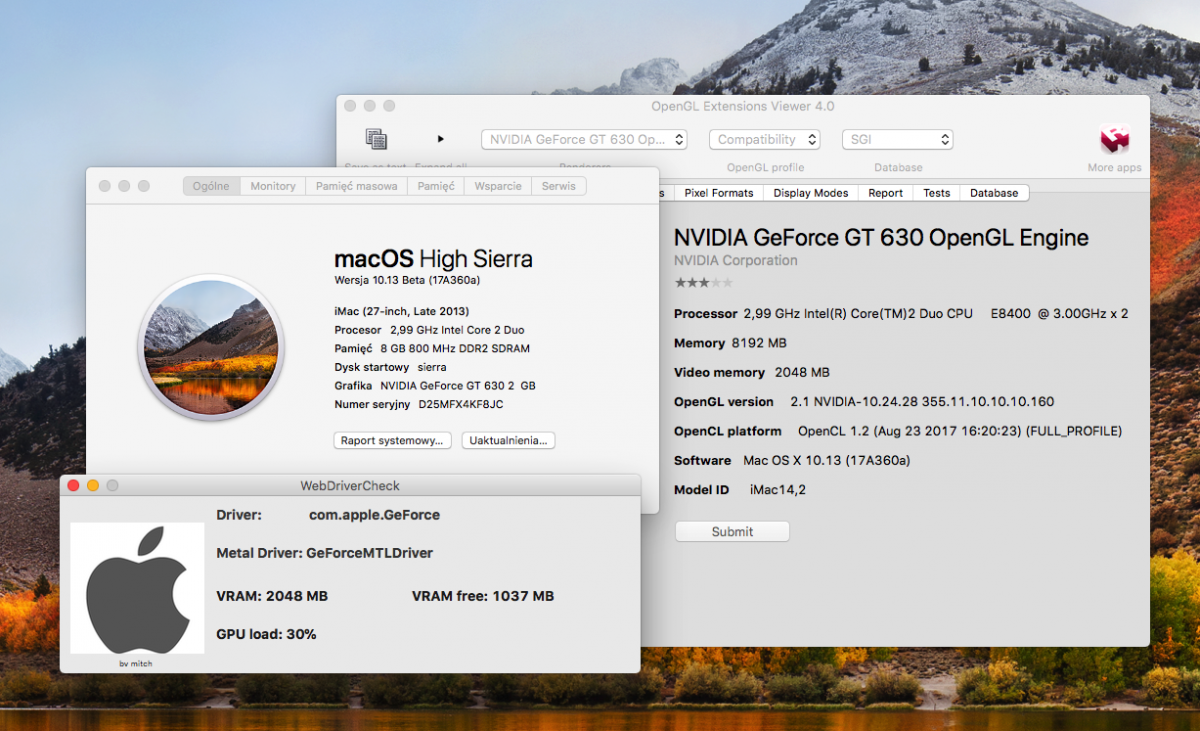

rtvkris1 Posted September 2, 2017 Share Posted September 2, 2017 Gt630 work very fine,,,755 Optiplex SFF, OS HighSierra is very speed,,sleep ok,,night shift works 1 Link to comment Share on other sites More sharing options...
lucsansag Posted September 2, 2017 Share Posted September 2, 2017 Gt630 work very fine,,,755 Optiplex SFF, OS HighSierra is very speed,,sleep ok,,night shift works Does shutdown work for you? I'm using 10.12.6 but can't get it to work in my 755 SFF Link to comment Share on other sites More sharing options...

rtvkris1 Posted September 3, 2017 Share Posted September 3, 2017 Działa zamykania dla Ciebie? Używam 10.12.6 ale nie może zmusić go do pracy w moim 755 SFF yes ,,,my dsdt is ok,,only nvidia DSDT.aml.zip Link to comment Share on other sites More sharing options...

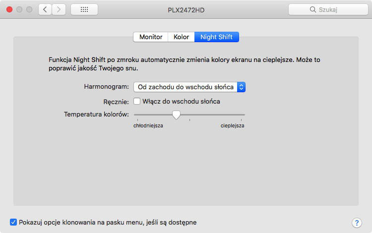

HazemTarek Posted September 4, 2017 Share Posted September 4, 2017 Gt630 work very fine,,,755 Optiplex SFF, OS HighSierra is very speed,,sleep ok,,night shift works i have 755 Optiplex SFF but night shift didn't work , can you upload your dsdt file and config.plist Link to comment Share on other sites More sharing options...

Guest ricoc90 Posted September 5, 2017 Share Posted September 5, 2017 i have 755 Optiplex SFF but night shift didn't work , can you upload your dsdt file and config.plistNight shift isn't related to dsdt, but smbios. Either choose a natively supported smbios or download MacPeet's patched framework (see #1 for the download link) Verstuurd vanaf mijn E5533 met Tapatalk Link to comment Share on other sites More sharing options...

rtvkris1 Posted September 7, 2017 Share Posted September 7, 2017 i have 755 Optiplex SFF but night shift didn't work , can you upload your dsdt file and config.plist dsdt you have at the top of the post ,, config has nothing to do night shift,(dsdt nvidia card) Night shift isn't related to dsdt, but smbios. Either choose a natively supported smbios or download MacPeet's patched framework (see #1 for the download link) Verstuurd vanaf mijn E5533 met Tapatalk my smbios imac14.2 ,nightshift is ok CoreBrightness.framework.zip Link to comment Share on other sites More sharing options...
Guest ricoc90 Posted September 7, 2017 Share Posted September 7, 2017 my smbios imac14.2 ,nightshift is ok Yeah, Night Shift requires iMac13.x as a minimum, so iMac14,2 works natively. With MacPeet's Night Shift patch it will work on iMac10,x iMac11,x and iMac12,x as well Link to comment Share on other sites More sharing options...
