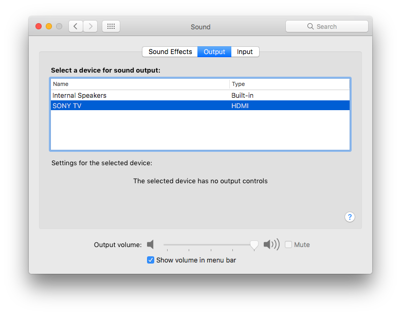

window Posted August 29, 2017 Share Posted August 29, 2017 don't see options but speakers are working on hdmi Link to comment Share on other sites More sharing options...

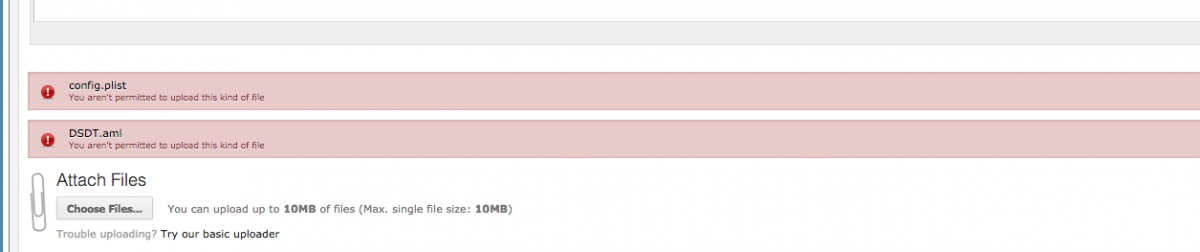

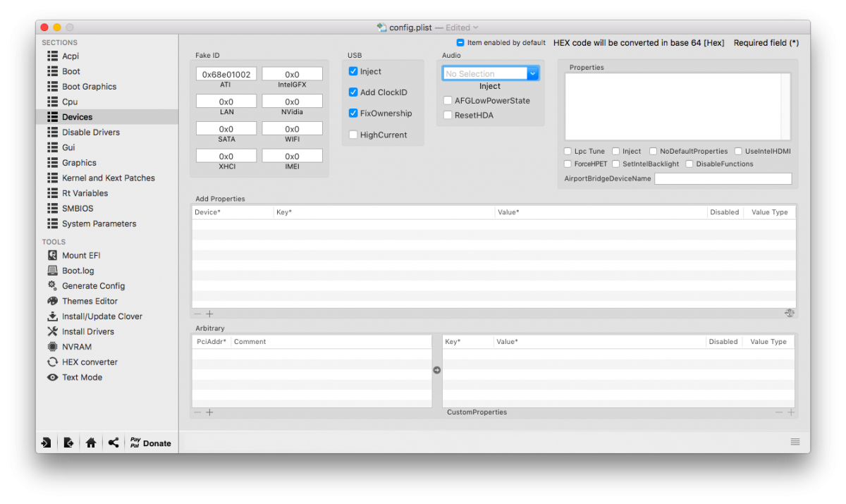

sakis6977 Posted August 29, 2017 Share Posted August 29, 2017 @sakis6977 Try with FakeID 0x68e01002 AND with FixDisplay_0100 @Shaheerahm You'll also need to edit the DSDT and change layout to 13 (OD) in device HDEF : Device (HDEF) { Name (_ADR, 0x001B0000) // _ADR: Address Method (_DSM, 4, NotSerialized) // _DSM: Device-Specific Method { Store (Package (0x08) { "built-in", Buffer (One) { 0x00 }, "layout-id", Buffer (0x04) { 0x0D, 0x00, 0x00, 0x00 }, … And make sure there's nothing in Device > Audio > Inject in the config.plist. Where can i find this????? If you have also patch Radeon 5450 in DSDT, so remove the patch config.plist looks like this <key>FakeID</key> <dict> <key>ATI</key> <string>0x68E01002</string> Graphics <key>Graphics</key> <dict> <key>ATI</key> <true/> yes i already do this!!!! But not work. How can i post photo anyway? 1 Link to comment Share on other sites More sharing options...
chris1111 Posted August 29, 2017 Share Posted August 29, 2017 Where can i find this????? yes i already do this!!!! But not work. How can i post photo anyway? Use More replay Option and Upload image See here http://www.insanelymac.com/forum/topic/312656-guide-macos-sierra-1012-dell-optiplex-780-760-755-790-990/?p=2484500 Link to comment Share on other sites More sharing options...

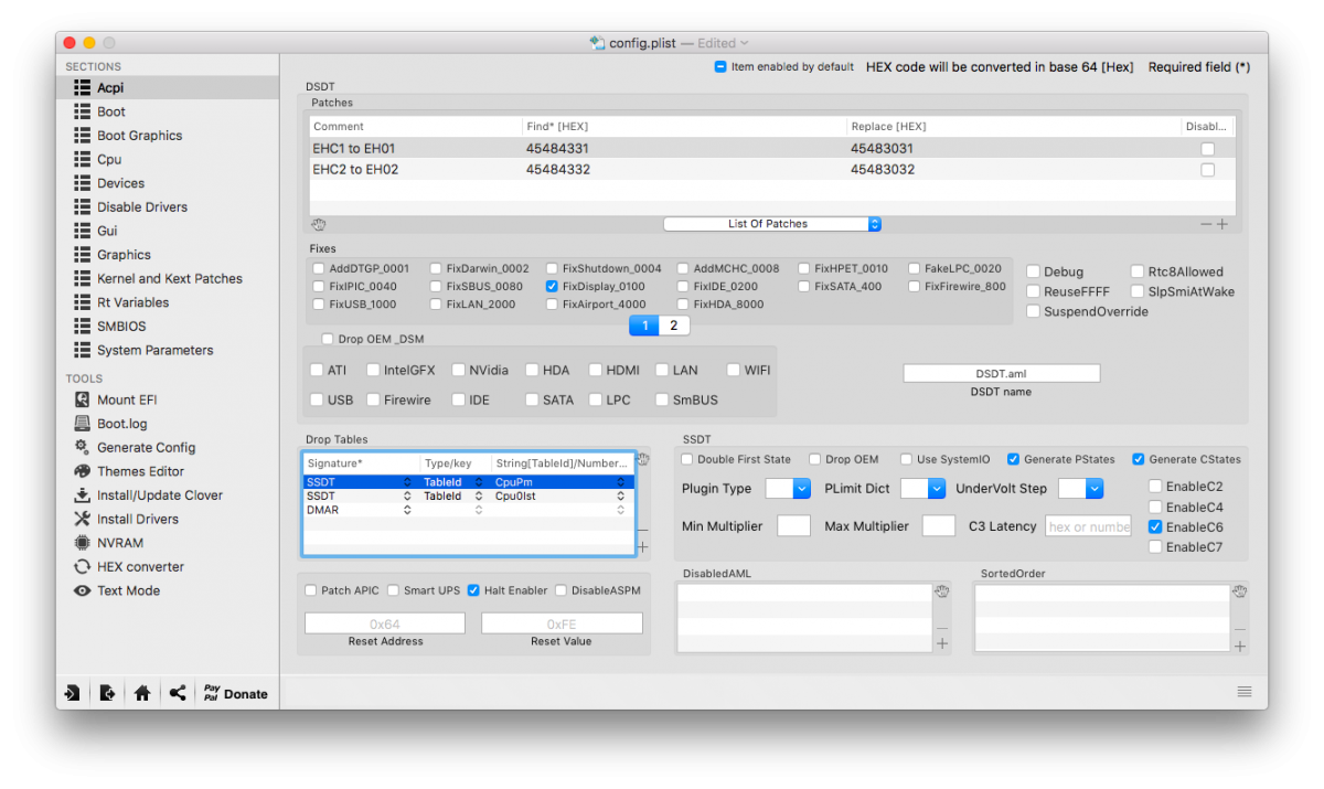

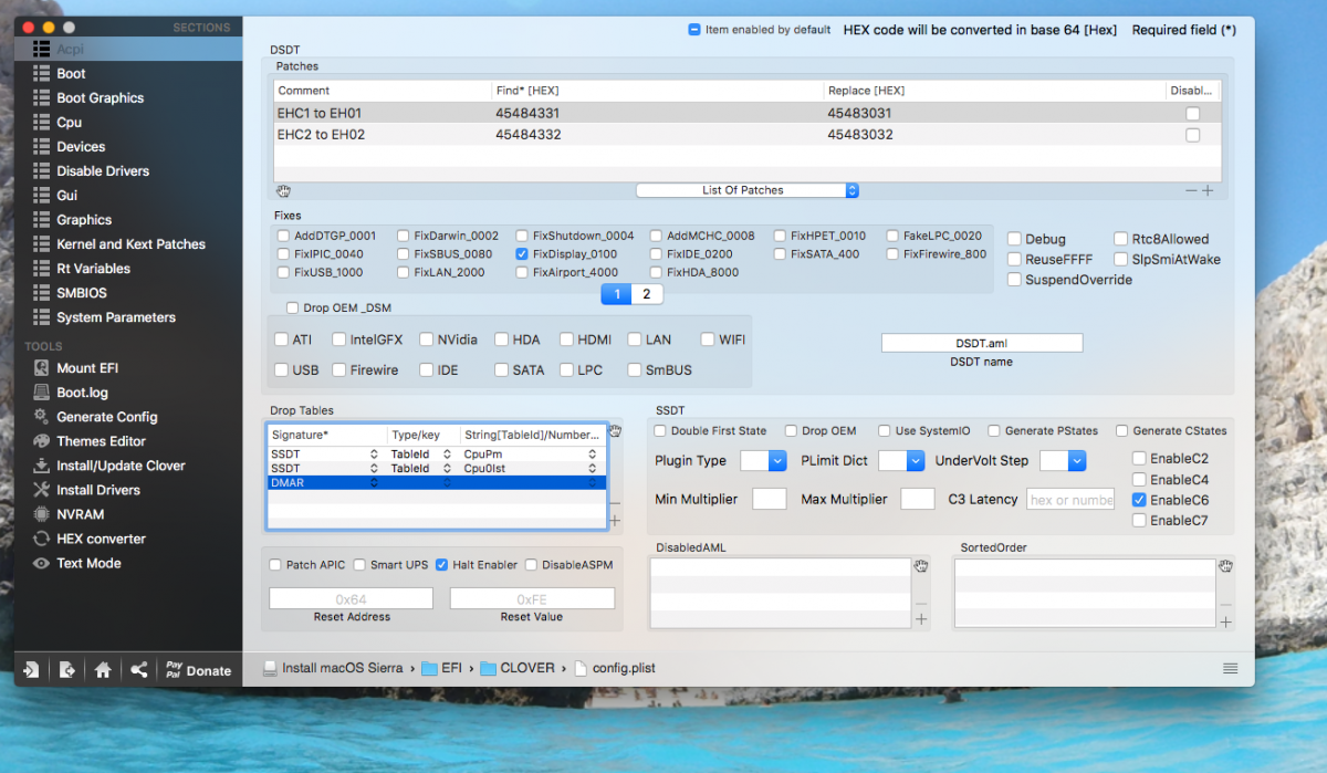

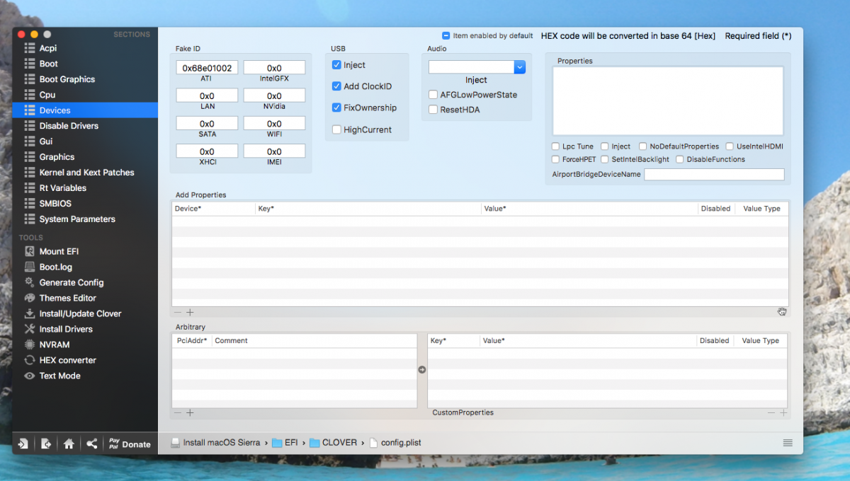

polyzargone Posted August 29, 2017 Share Posted August 29, 2017 Where can i find this????? ACPI & Devices as shown in screenshots. PS : Do not Inject ATI when using this! Link to comment Share on other sites More sharing options...
chris1111 Posted August 29, 2017 Share Posted August 29, 2017 ACPI & Devices as shown in screenshots. PS : Do not Inject ATI when using this! I always used Inject ATI with 5450 Fake ID clover Needs to disable patch ATI 5450 DSDT Link to comment Share on other sites More sharing options...

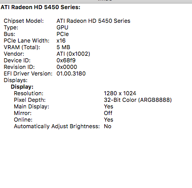

sakis6977 Posted August 29, 2017 Share Posted August 29, 2017 Ok im doing this but no... Nothing happend. still 1280x1024 and no sound... I always used Inject ATI with 5450 Fake ID clover Needs to disable patch ATI 5450 DSDT is it hepl this?? When i add the DSDT file they does not boot my system. If i deleted i boot normaly Link to comment Share on other sites More sharing options...

sakis6977 Posted August 29, 2017 Share Posted August 29, 2017 Post your DSDT and config.plist here I have no permission to upload this kind. I upload to dropbox https://www.dropbox.com/sh/scwh83tezyy1usf/AAC0yIGSMW5s4caaTZdDPWxVa?dl=0 Link to comment Share on other sites More sharing options...

sakis6977 Posted August 29, 2017 Share Posted August 29, 2017 Ok try this config.plist NO DSDT If the graphics card works with this config, you can test the Generic DSDT in the first post Nope.... Still the same... 1080x1024 and no sound! If i put the dsdt file again i dont boot. Link to comment Share on other sites More sharing options...

sakis6977 Posted August 30, 2017 Share Posted August 30, 2017 @sakis6977 Test this please : Nope... It takes a loop with restart. When i see the apple logo it restart. If i delete the DSDT file it boot normaly but with 1280x1024 not Full HD Link to comment Share on other sites More sharing options...
chris1111 Posted August 30, 2017 Share Posted August 30, 2017 Nope... It takes a loop with restart. When i see the apple logo it restart. If i delete the DSDT file it boot normaly but with 1280x1024 not Full HD May be you need to change the Graphics card, some ATI Radeon HD 5450 not working correctly I suggestion to you the Geforce GT 710 Gigabyte 2 Gig working OOB Sierra and High Sierra No DSDT patch Link to comment Share on other sites More sharing options...
