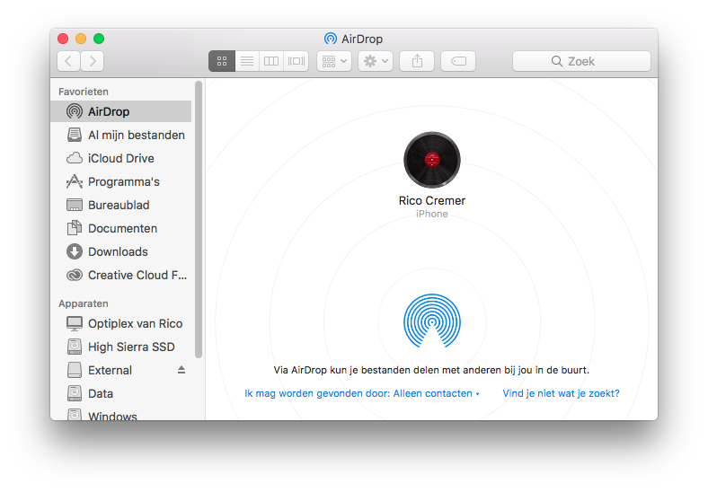

Guest ricoc90 Posted July 29, 2017 Share Posted July 29, 2017 So I've read some more about getting handoff and continuity to work.I'm planning on buying the TP-Link archer T6E wifi-card which uses a broadcom chip and *should* work OOB in macOS.I have the Asus BT400 USB bluetooth dongle and there happens to be a patch by RehabMan to make it support handoff and continuity, so I'm pretty hopeful The bad thing is that it won't work on my 755, since it has only 1 pci-e slot which is used by the graphics card but I guess you can't have it all Link to comment Share on other sites More sharing options...

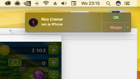

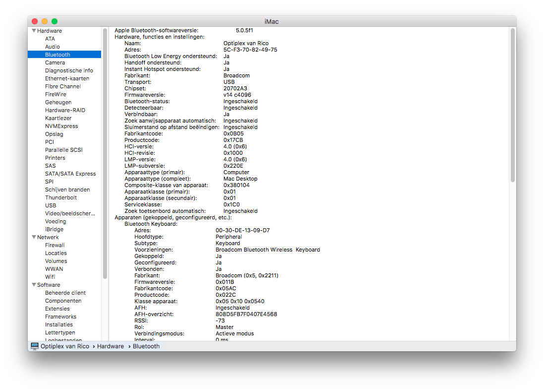

Guest ricoc90 Posted August 2, 2017 Share Posted August 2, 2017 For the ones that are interested Handoff, Airdrop to iPhone etc is working with the TP-Link Archer T6E + Asus BT400 USB Bluetooth dongle. It does not work in High Sierra though, because the Archer T6E needs a little patch in the AirPortBrcm4360.kext, which High Sierra does not use for my device id anymore (it's using AirPortBrcmNIC-MFG.kext instead). Or well, the WiFi works OOB in High Sierra, but Handoff is not enabled. Handoff works under High Sierra too when removing AirportBrcmNIC-MFG.kext and replacing AirPortBrcm4360.kext with the one from Sierra. It's a nice solution for SFF users, due to the few number of PCI-E ports and, in my case, the lack of internal USB headers Does anyone know any other (broadcom) pci-e cards that work? Patches I've used:To enable handoff support on the Asus BT400 (by RehabMan, based on Dokterdok patch) name: IOBluetoothFamily find: 4885ff74 47488b07 replace: 41be0f00 0000eb44 And to make the WiFi work (the-darkvoid patch) name: AirPortBrcm4360 Find: 81f952aa 00007529 Replace: 41be0f00 0000eb44 Link to comment Share on other sites More sharing options...
