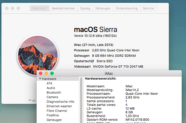

I'm having a problem with my Dell Optiplex 990 installation. I read that NVIDIA GT 710 is work OOB in Sierra so I purchased one and install it. The problem is I now can boot with nvdia_drv=1 via Clover but got no graphics acceleration. NVDIA Web Driver on Menu Bar is checked but nothing got detected in ECC tab and it only display 1280 x 720. I'm using iMac 14.2 in SMBIOS and enable EMUVariableUEFI-64 on Clover. There's also glitch on login screen.
I connect my Dell via HDMI, so could this be a problem?
Any help?

I just tried iMac14,2 and it works fine here without web drivers
I am on DVI, I can't test HDMI at this moment...
The GT 710 does not support ECC by the way.

@ricoc90: I also using iMac 14.2 but couldn't get it to work. On About This Mac, My NVIDIA show only 3MB VRAM when actually my card has 2GB.
Are you injecting the card in any way? When I did that I had the same problem
