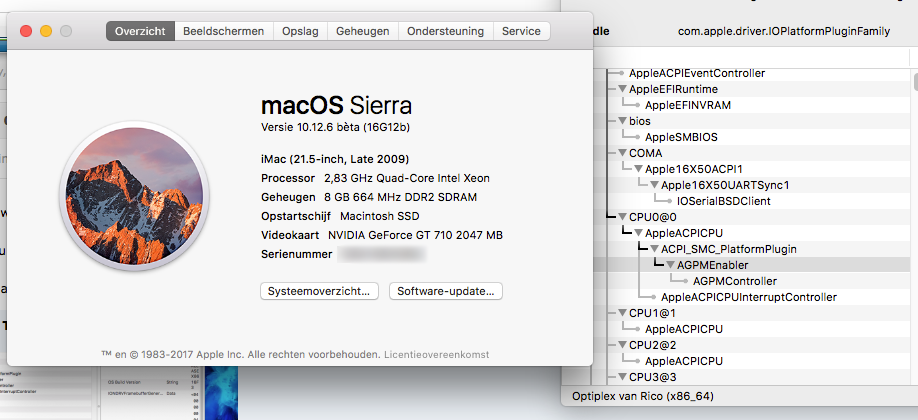

Since there were a couple of people here reporting the same issue, I'll post this here:
Since 10.12.5 I was having the issue that my GT 710 would boot into a black screen if using SMBios imac10,1, so I was using macpro3,1 instead.
In another topic user @KWS pointed out that he got behind that black screen by changing his Board-ID rather than his system definition.
User @snobrd4life confirmed that it is working and I can confirm it too.
I'm currently using imac10,1 SMBios again with the Board-ID from macpro3,1
No black screen and most importantly AGPM (which I did not get using SMBios macpro3,1)  :thumbsup_anim:
So alternatively, instead of switching your SMBios, you can change your Board-ID

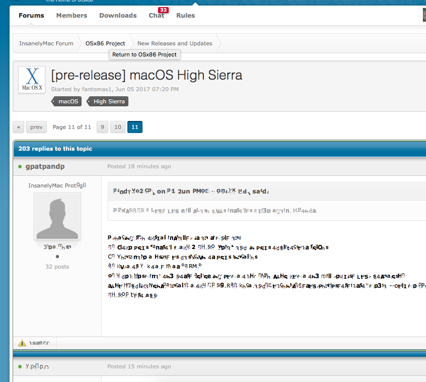

I was wondering, since 10.12.6 beta 2 WebKit crashes on me alot, whereas it worked fine up to 10.12.6 beta 1
