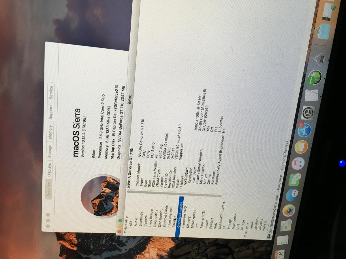

teolotec Posted April 16, 2017 Share Posted April 16, 2017 I've updated from el capitan to sierra 10.12.1 and got black screen with nvidia GT710 2gb. Updated latest driver on web driver same problem. I'm only able boot with nv_disable=1 but graphic card show only 6mb. Any idea? Updated: I've update to 10.12.4 then uninstalled and reinstalled nvidia web driver. Now I can boot to desktop and Mac OS sierra has regconized graphic GT 710 2047mb. I'm using smbios 10,1 though. Link to comment Share on other sites More sharing options...
MaLd0n Posted April 16, 2017 Share Posted April 16, 2017 GT 710 fail in Sierra, dont work. 730 work with Video Ports=02 Link to comment Share on other sites More sharing options...
vdubbus77 Posted April 16, 2017 Share Posted April 16, 2017 My GT 710 works fine with a 14,2 smbios in sierra. Link to comment Share on other sites More sharing options...
teolotec Posted April 16, 2017 Share Posted April 16, 2017 My GT 710 works fine with a 14,2 smbios in sierra. Are you using dell 780? I can boot to desktop after changed to smbios 14,2 but mouse and keyboard are not response. It's seem like all usb port not working. Any idea? Link to comment Share on other sites More sharing options...
polyzargone Posted April 16, 2017 Share Posted April 16, 2017 Are you using dell 780? I can boot to desktop after changed to smbios 14,2 but mouse and keyboard are not response. It's seem like all usb port not working. Any idea? You must edit the info.plist of USB_Injector.kext and change every occurrence from iMac10,1 to iMac14,2. Link to comment Share on other sites More sharing options...
