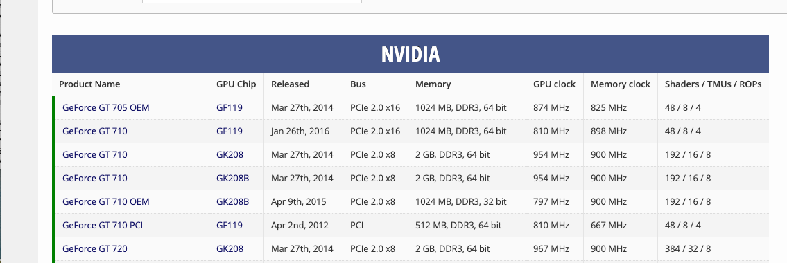

Slice Posted July 27, 2020 Share Posted July 27, 2020 On 7/18/2020 at 11:19 PM, BEINGRATUL said: I want to ask whether GT 710 DDR5 version works OOB in Catalina or not? See the table If GK208 then it will work in Catalina. If GF119 then it will not work in system higher then ElCapitan. Link to comment https://www.insanelymac.com/forum/topic/312609-geforce-gt-710/page/2/#findComment-2732197 Share on other sites More sharing options...
