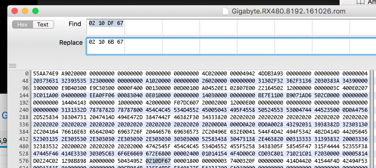

Matthew82 Posted April 4, 2017 Share Posted April 4, 2017 Thank you. I'm willing to try flashing a new .rom on my card. Can you point me to the rom and flashing app? Also, can I dual boot to windows? Why wouldn't you be able to use your 1st pcie slot? Thanks for the info 1. Find your bios on techpoweup.com. For example this is me https://www.techpowerup.com/vgabios/188335/gigabyte-rx480-8192-161026 2. Find your device id in hex editor 02 10 DF 67 and replace with something not existing 02106B67 (This id is in two place in bios hex code) 3. Save your new bios and find in google how to flash rx 480 in window 2 Link to comment Share on other sites More sharing options...

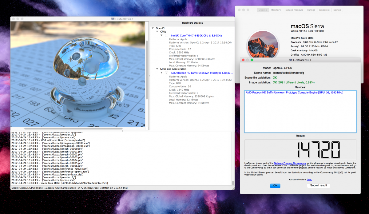

Matthew82 Posted April 24, 2017 Share Posted April 24, 2017 Flashed RX 480 to 580 - 4% performance boost 3 Link to comment Share on other sites More sharing options...
