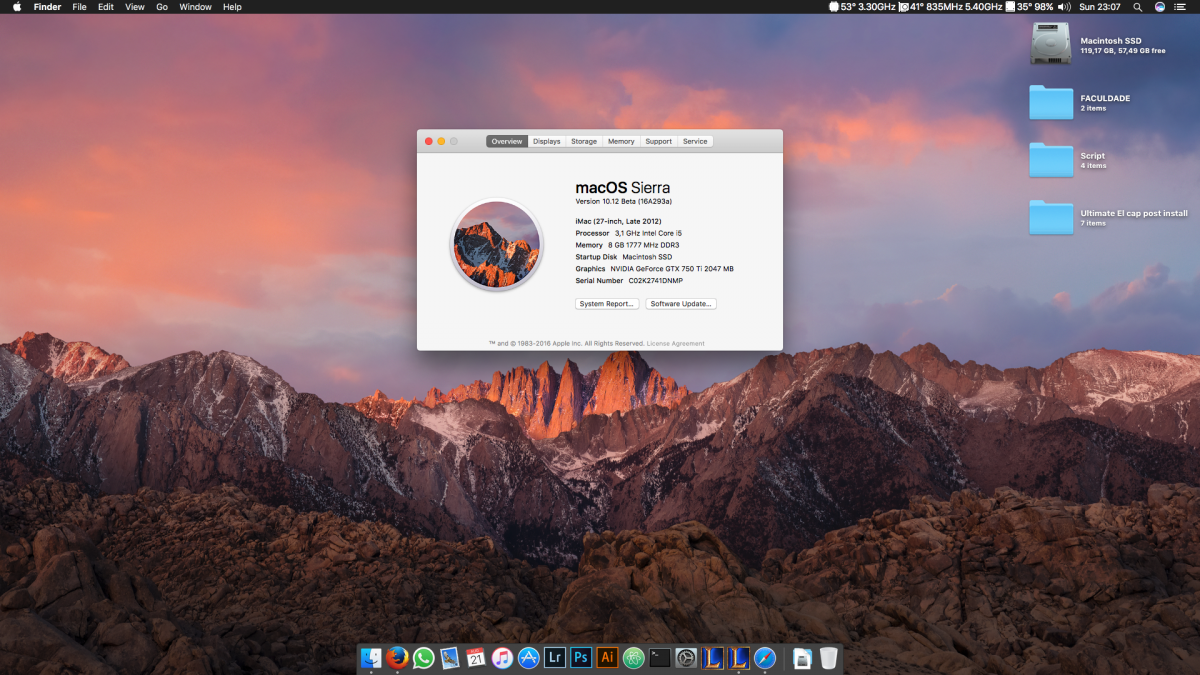

I can confirm Working Gigabyte 750TI but with some remarks:
1 - I think we should all back to using kext-dev-mode=1 and roothless=0
2 - remove Emuvariable-64 from EFI it will cause system to never load your video kext
3 - Nvidia webdriver should be enabled using it's settings panel under system preference
4 - transparency is buggy as hell so reduce it under Accessibility panel.
5 - Clover Configurator won't mount EFI so do it manually
6 - no messed up colors on my end*
7 - reset your NVRAN after removing Emuvariable (sudo  nvram -c)
