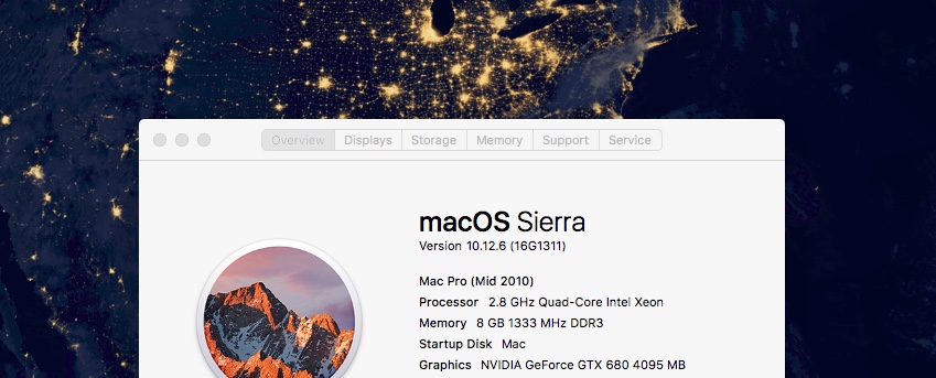

Qwels Posted March 11, 2018 Share Posted March 11, 2018 After updating Mac OS can't find Nvidia Web Driver for Sierra 10.12.6 (16G1311) (or haven't upgraded?) who has more accurate information? Link to comment Share on other sites More sharing options...
fantomas Posted March 11, 2018 Author Share Posted March 11, 2018 1 hour ago, Qwels said: (or haven't upgraded?) This one Link to comment Share on other sites More sharing options...
Qwels Posted March 12, 2018 Share Posted March 12, 2018 On 11.03.2018 at 12:43 PM, fantomas1 said: This one I just stupidly-can't find firewood under (16G1311) it used to be (16G1211) Link to comment Share on other sites More sharing options...
fantomas Posted March 12, 2018 Author Share Posted March 12, 2018 I guess it is just a matter of time before they post 16G1311 webdriver version. Link to comment Share on other sites More sharing options...
Qwels Posted March 12, 2018 Share Posted March 12, 2018 3 minutes ago, fantomas1 said: I guess it is just a matter of time before they post 16G1311 webdriver version. So I asked-about it: shorter is not zapilili. Link to comment Share on other sites More sharing options...

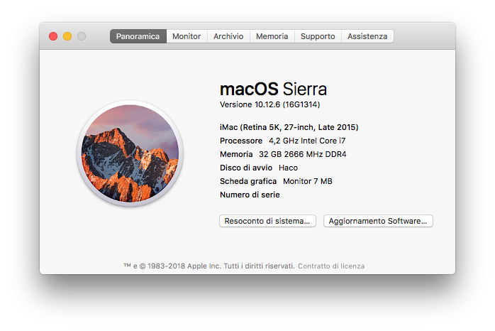

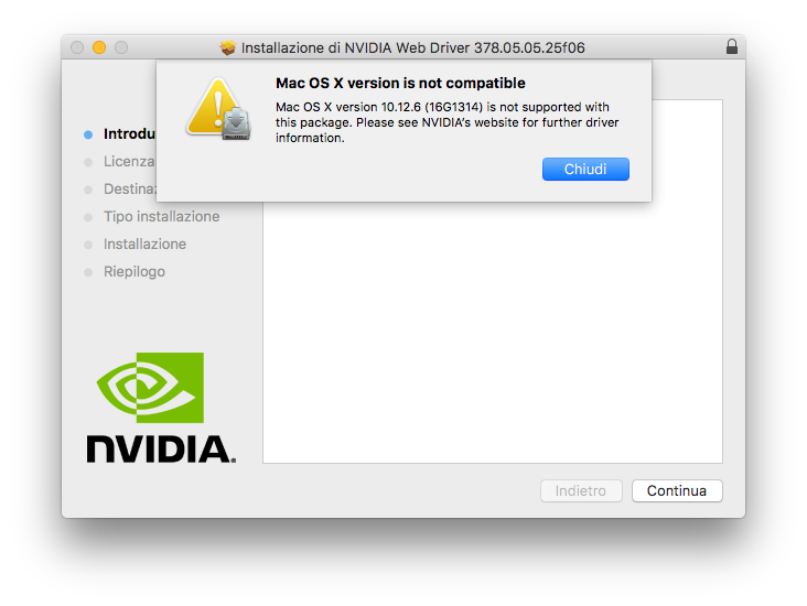

haring Posted March 30, 2018 Share Posted March 30, 2018 10.12.6 16G1314 Nvidia webdriver doesn't works? Link to comment Share on other sites More sharing options...
haring Posted March 30, 2018 Share Posted March 30, 2018 Solved with a little modification: S/L/E > NVDAStartupWeb.kext > Contents > info.plist Change (lines 45-46) <key>NVDARequiredOS</key> <string>16G1212</string> with <key>NVDARequiredOS</key> <string>16G1314</string> I copied the kext on the desktop, I duplicated it, modified it, put it back into S/L/E and updated the cache. hope it helps 1 Link to comment Share on other sites More sharing options...

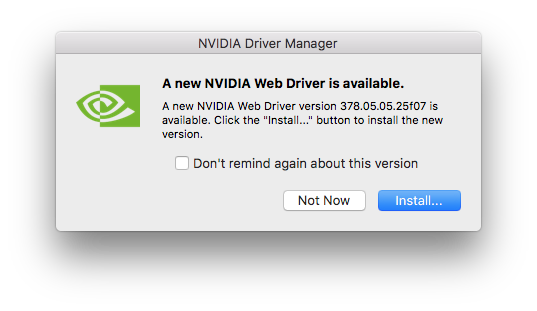

haring Posted March 31, 2018 Share Posted March 31, 2018 (edited) Nvidia web driver 378.05.05.25f07 is out. Quote Thank you for purchasing an NVIDIA® graphics card for the Mac Pro. This software package contains: ● A driver designed for your NVIDIA graphics card. ● A preference pane in System Preferences that includes options to: ◦ Switch between the NVIDIA Web Graphics Driver or Default OS X Graphics Driver. ◦ Enable Error Correcting Codes (ECC) on supported graphics cards. ◦ Automatically check for NVIDIA software updates for your graphics card. ● An optional menu bar item that provides easy access to the most common preferences. If, for any reason, you are unable to boot your system to the desktop and wish to restore your original drivers, you can do so by clearing your Mac’s NVRAM. To clear NVRAM, power on your Mac and hold down Command (⌘), Option, P, and R simultaneously before the gray screen appears. Keep the keys held down until you hear the startup chime for the second time. The system will now boot with the original drivers restored. Edited March 31, 2018 by haring 1 Link to comment Share on other sites More sharing options...
Funky frank Posted April 3, 2018 Share Posted April 3, 2018 https://images.nvidia.com/mac/pkg/378/WebDriver-378.05.05.25f07.pkg Does it change anything for you? Link to comment Share on other sites More sharing options...
haring Posted April 3, 2018 Share Posted April 3, 2018 For me? Nothing, it works without special effects. In the "patched" version I didn't do any particular tests. Honestly I'm not satisfied with this video card both with "real" and "forged" drivers... ps, CUDA has also been updated. Latest version: 387.178 for GPU Driver Version 378.05.05.25f07. Link to comment Share on other sites More sharing options...

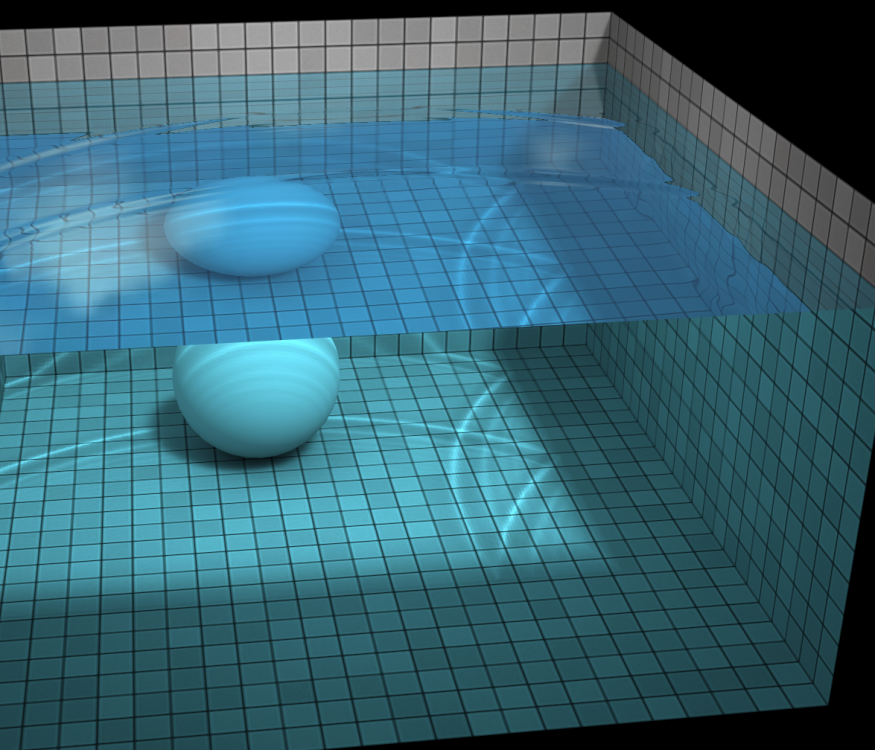

Funky frank Posted April 3, 2018 Share Posted April 3, 2018 Maybe I am hallucinating, but either the recent f07 driver or the recent nvidiagraphicsfixup anti-lag patch (also working for sierra??) seems to make the desktop feel a bit snappier now. But microstuttering in webgl water still is there... Hm. Link to comment Share on other sites More sharing options...
haring Posted April 3, 2018 Share Posted April 3, 2018 I see that (without fixup), I didn't understand what you mean: Link to comment Share on other sites More sharing options...

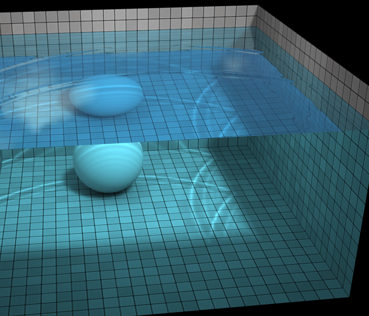

Funky frank Posted April 3, 2018 Share Posted April 3, 2018 I see microstutters in the water webgl animation, like sometimes there is a short freeze, every 1-2 seconds or so. I also tested this on High Sierra, there the animation runs butter smooth, without any lags. Link to comment Share on other sites More sharing options...
haring Posted April 3, 2018 Share Posted April 3, 2018 No freeze, interruptions or lags in my case. System in signature is up to date. Never tried before. Link to comment Share on other sites More sharing options...

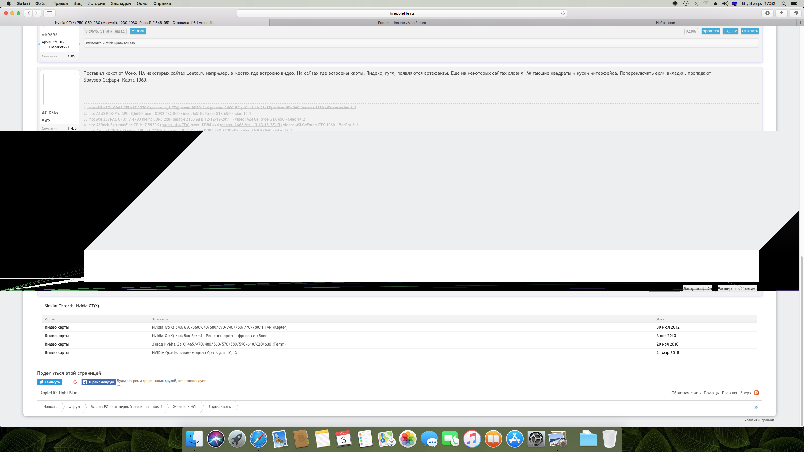

ACIDSky Posted April 3, 2018 Share Posted April 3, 2018 (edited) With the new fix kext appeared artifacts on some sites in Safari. In places where the video is embedded. Or a Google maps frame. 1060 GTX Edited April 3, 2018 by ACIDSky Link to comment Share on other sites More sharing options...

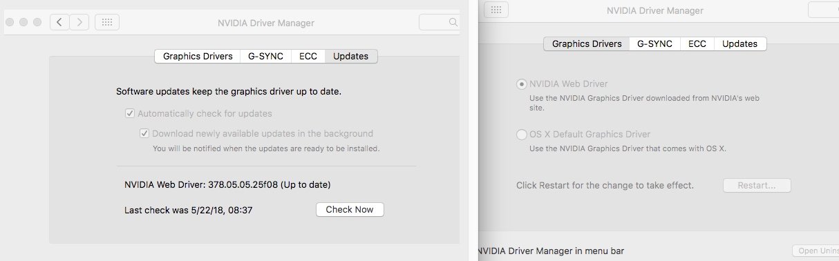

Qwels Posted May 22, 2018 Share Posted May 22, 2018 On 5/13/2018 at 1:59 PM, brousseau6933 said: Any improvements or changes vs build 25f07? I don't want to update if there isn't any bugfix or added value. Thanks... 10.12.6 build-16G1314 GTX-680 Works great with me, auto update. Link to comment Share on other sites More sharing options...
deeveedee Posted June 2, 2018 Share Posted June 2, 2018 After I applied Security Update 2018-003 to Sierra 10.12.6, NVidia Web Driver 378.05.05.25f08 is now "incompatible" and has been disabled by NVidia Driver Manager (automatically switched to OSX Default Graphics Driver). Tried uninstalling and reinstalling web driver with same result. Link to comment Share on other sites More sharing options...
