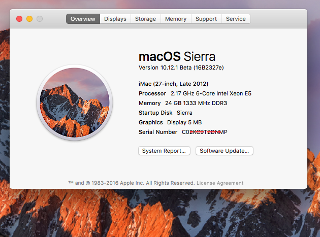

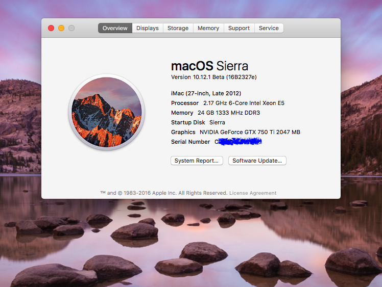

oskr66 Posted September 22, 2016 Share Posted September 22, 2016 (edited) Unable to get graphics card working  it says " version no compatible"  GPU is an Nvidia  750Ti Edited September 22, 2016 by fantomas1 Link to comment https://www.insanelymac.com/forum/topic/312525-nvidia-web-driver-updates-for-macos-sierra-update-sept-27-2019/page/16/#findComment-2281861 Share on other sites More sharing options...
polyzargone Posted September 22, 2016 Share Posted September 22, 2016 (edited) Unable to get graphics card working  it says " version no compatible"  GPU is an Nvidia  750Ti  As usual : sudo nano /System/Library/Extensions/NVDAStartupWeb.kext/Contents/info.plist Then change NVDARequiredOS to this (assuming you're indeed on 16B2327e) : <key>NVDARequiredOS</key> <string>16B</string> Repair permissions, rebuild kernel cache and reboot.         Edited September 22, 2016 by fantomas1 2 Link to comment https://www.insanelymac.com/forum/topic/312525-nvidia-web-driver-updates-for-macos-sierra-update-sept-27-2019/page/16/#findComment-2281875 Share on other sites More sharing options...
oskr66 Posted September 22, 2016 Share Posted September 22, 2016 (edited) it works , thanks Polizargone, now graphic are working. Edited September 22, 2016 by fantomas1 Link to comment https://www.insanelymac.com/forum/topic/312525-nvidia-web-driver-updates-for-macos-sierra-update-sept-27-2019/page/16/#findComment-2281887 Share on other sites More sharing options...

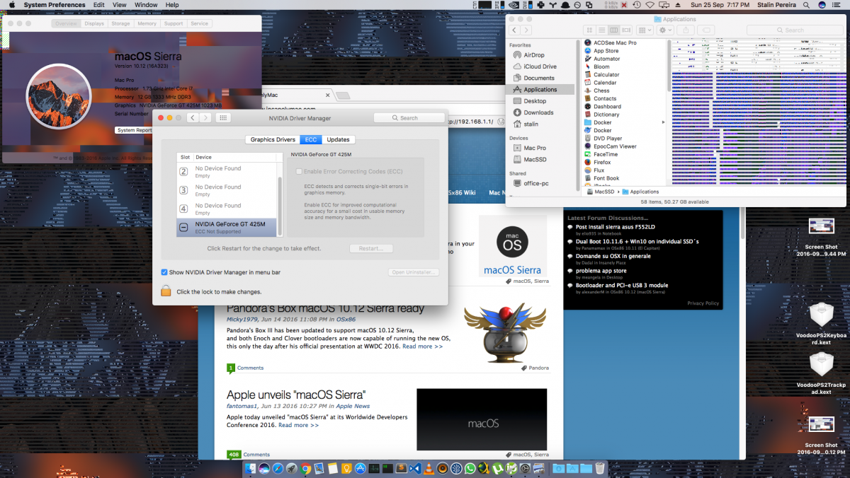

imatefx Posted September 26, 2016 Share Posted September 26, 2016 Can someone give me a hint of what could be wrong   My screen is all distorted with pixels but resolution is correct, even the model number is correctly identified by Nvidia  It is distorted only for some windows and Desktop background, finder, etc... chrome gives be correct rendering most of the time.  But the RAM is only 1023 MB instead of 1024 MB  Using NVIDIA Web Driver : 367.15.10.05f01  System Information :   Hardware Overview:   Model Name: Mac Pro  Model Identifier: MacPro5,1  Processor Name: Intel Core i7  Processor Speed: 1.73 GHz  Number of Processors: 1  Total Number of Cores: 4  L2 Cache (per Core): 256 KB  L3 Cache: 6 MB  Memory: 12 GB  Bus Speed: 533 MHz  Boot ROM Version: MP51.007F.B03  SMC Version (system): 1.39f11  Graphics :  NVIDIA GeForce GT 425M:   Chipset Model: NVIDIA GeForce GT 425M  Type: GPU  Bus: PCIe  PCIe Lane Width: x16  VRAM (Total): 1023 MB  Vendor: NVIDIA (0x10de)  Device ID: 0x0df0  Revision ID: 0x00a1  ROM Revision: VBIOS 70.08.19.00.5f  Metal: Supported  Displays: BenQ GW2760HS:  Resolution: 1920 x 1080 @ 60Hz (1080p)  Pixel Depth: 32-Bit Color (ARGB8888)  Display Serial Number: CAE00316SL0  Main Display: Yes  Mirror: Off  Online: Yes  Rotation: Supported  Automatically Adjust Brightness: No  Television: Yes Display:  Resolution: 1920 x 1080  Pixel Depth: 32-Bit Color (ARGB8888)  Mirror: Off  Online: Yes  Rotation: Supported  Automatically Adjust Brightness: No  Link to comment https://www.insanelymac.com/forum/topic/312525-nvidia-web-driver-updates-for-macos-sierra-update-sept-27-2019/page/16/#findComment-2285616 Share on other sites More sharing options...
sl0wtarget Posted September 26, 2016 Share Posted September 26, 2016 The last time I experienced glitches like that my GPU needed replacing. Link to comment https://www.insanelymac.com/forum/topic/312525-nvidia-web-driver-updates-for-macos-sierra-update-sept-27-2019/page/16/#findComment-2285643 Share on other sites More sharing options...
imatefx Posted September 26, 2016 Share Posted September 26, 2016 I was not using nvidia web drivers on el capitan Link to comment https://www.insanelymac.com/forum/topic/312525-nvidia-web-driver-updates-for-macos-sierra-update-sept-27-2019/page/16/#findComment-2285644 Share on other sites More sharing options...
phi777 Posted September 26, 2016 Share Posted September 26, 2016 you don't have two block of pins with nothing in the middle of your dvi cable? you have just one block of connector pins?? Good is 2nd or 4th of the http://cdn.overclock.net/f/ff/ffd2a16b_DVI.jpeg Link to comment https://www.insanelymac.com/forum/topic/312525-nvidia-web-driver-updates-for-macos-sierra-update-sept-27-2019/page/16/#findComment-2285676 Share on other sites More sharing options...
imatefx Posted September 26, 2016 Share Posted September 26, 2016 you don't have two block of pins with nothing in the middle of your dvi cable? you have just one block of connector pins?? Good is 2nd or 4th of the http://cdn.overclock.net/f/ff/ffd2a16b_DVI.jpeg I dont have dvi port, i use hdmi, I have only nvidia graphics card, no intel cards Link to comment https://www.insanelymac.com/forum/topic/312525-nvidia-web-driver-updates-for-macos-sierra-update-sept-27-2019/page/16/#findComment-2285679 Share on other sites More sharing options...
phi777 Posted September 26, 2016 Share Posted September 26, 2016 I dont have dvi port, i use hdmi, I have only nvidia graphics card, no intel cards You don't have a display port or dvi you could try?? maybe switching the connector, mine, next to mainboard, works best, some ports work better than others... Edit: Oh, I just saw you have a mobile grafic card, sorry Link to comment https://www.insanelymac.com/forum/topic/312525-nvidia-web-driver-updates-for-macos-sierra-update-sept-27-2019/page/16/#findComment-2285682 Share on other sites More sharing options...
