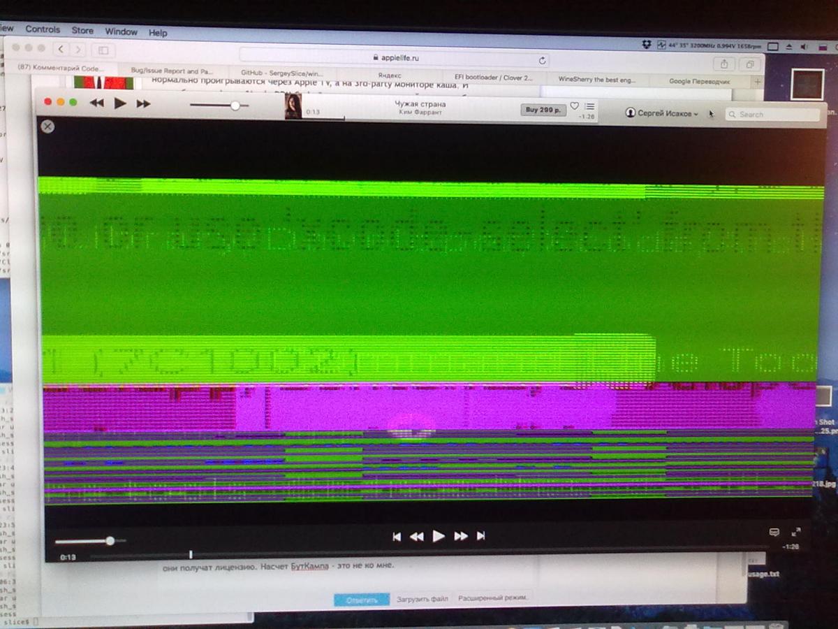

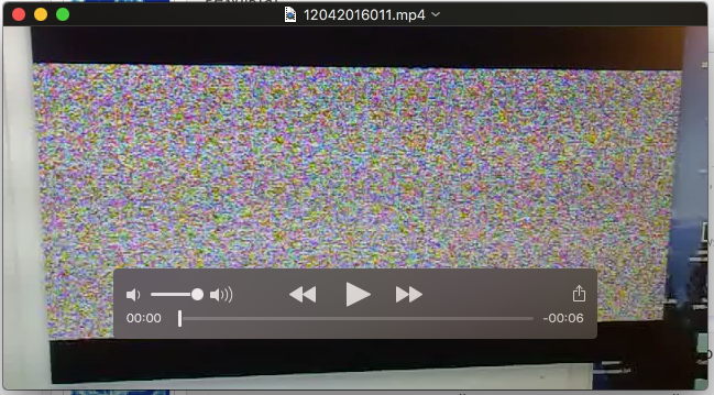

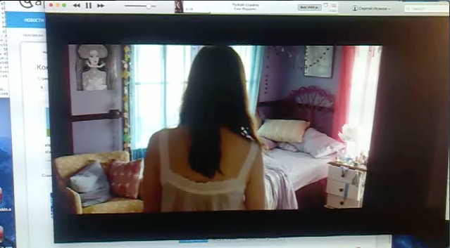

Slice Posted April 14, 2016 Share Posted April 14, 2016 I want to share my success with other users. 1. Initial state. Just a noise 2. Register to Appstore with valid credit card. It is the same key as for iMessage. there is a picture but bad drawn. 3. Remove AppleIntelHD3000GraphicsVADriver.bundle because it correspond my builtin IntelHD3000 which I don't use as it bad for OSX. My main adapter is Radeon HD6670 but it set as secondary in BIOS to resolve wake problem. Now iTunes uses AMDRadeonVADriver.bundle and the picture is good Best! 10 Link to comment Share on other sites More sharing options...
