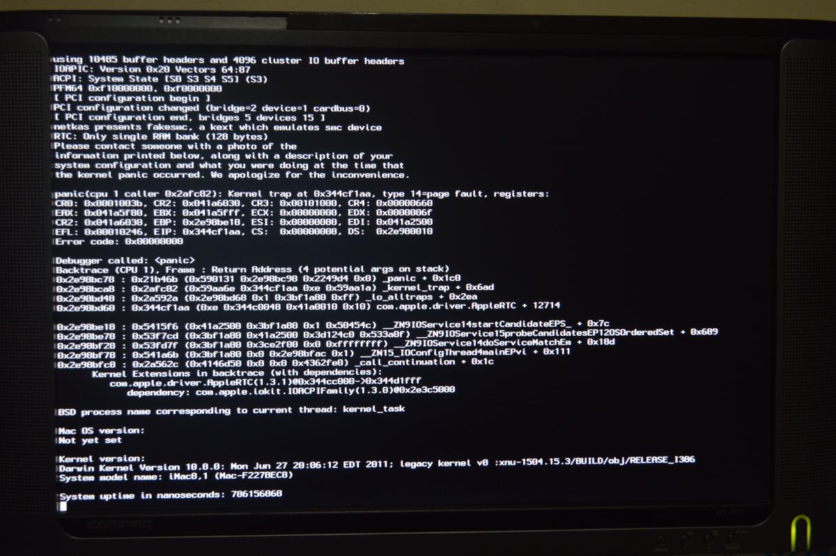

Warmach1ne Posted April 13, 2016 Share Posted April 13, 2016 After I updated to 10.6.8, I was unable to boot properly. I booted my machine in verbose mode, and this showed up. I used the boot flags PCIRootUID=1, npci=0x3000 and GraphicsEnabler=Yes. Link to comment https://www.insanelymac.com/forum/topic/311816-wont-boot/ Share on other sites More sharing options...
mendietinha Posted April 13, 2016 Share Posted April 13, 2016 did you update the legacy kernel for this version? Link to comment https://www.insanelymac.com/forum/topic/311816-wont-boot/#findComment-2231982 Share on other sites More sharing options...
Warmach1ne Posted April 13, 2016 Author Share Posted April 13, 2016 did you update the legacy kernel for this version? I'm sure I did. I installed the 10.6.8 nawcom kernel. Link to comment https://www.insanelymac.com/forum/topic/311816-wont-boot/#findComment-2232125 Share on other sites More sharing options...
spakk Posted April 14, 2016 Share Posted April 14, 2016 Use this kernel, it will also work with your CPU: Full 64-bit 10.6.8 kernel with SSSE3 emulator for 64-bit kernel space on non-ssse3 CPUs. Compiled by Sinetek. 1 Link to comment https://www.insanelymac.com/forum/topic/311816-wont-boot/#findComment-2232309 Share on other sites More sharing options...

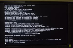

naquaada Posted July 6, 2016 Share Posted July 6, 2016 I also have this problem with 'Not yet set' on Snow Leopard and Leopard. My system has a Xeon E5450 CPU, socket 771 modified for 775. I'm using Clover 3577. There are a lot of weird combinations: - The Snow Leopard installation I used was unmodified from an Core i7 system where it boots perfectly with clover. - I tried kernels Snow Leopard 10.6.3, 10.6.8, Mountain Lion 10.8.0 (yes, this is possible) and this kernel. No success. - With the kernel above and Clover optition 'busratio=9' it loads kerne and kexts and then ends with a lot of +++++++++ signs. - Booting from an USB stick with an Chimera setup designed for this system, I'm getting lots of 'Invalid processor op 0x5c...' - Booting Installation from USB works, so I made a fresh installation - I copied neccessary kexts to the Snow Leopard, ends again with 'Not yet set'. Leopard has the same issue, but is booting fine from Chimera with vanilla kernel (except the missing HD4870 driver). Because it is partially working with Chimera, so it must be somewhere a Clover settings problem. I also would like to use a vanilla kernel for Snow Leopard again. Link to comment https://www.insanelymac.com/forum/topic/311816-wont-boot/#findComment-2248110 Share on other sites More sharing options...
