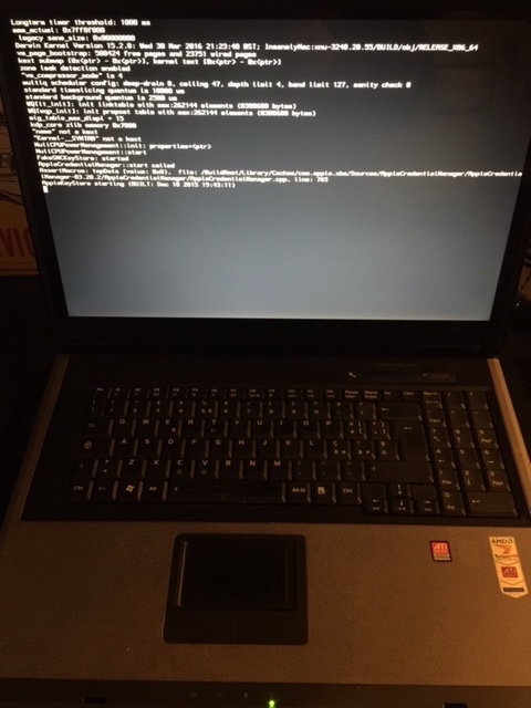

JahStories Posted March 31, 2016 Share Posted March 31, 2016 Hi guys, I'm trying to boot el capitan (I know it's a challenge ) on an old Turion 64 x2 laptop I had forgotten on a bag, the Asus K7Fr... (I'm trying to boot from a cloned tested on another machine 10.11.3 clean install, not the installer) Specs: CPU: AMD Turion 64 X2 Chipset: AMD M690G GPU: ATI Mobility Radeon HD 2400 Memory: 2GB DDR2 SDRAM HDD: 250GB 5400RPM I'm booting using latest Enoch (It seems that this laptop don't digest Clover, I wasn't able to make it load) and using this kernel (S/L/K) + system.kext (S/L/E) as suggestions from spakk! (thx ) and tried booting using these flags at boot: npci=0x2000 idelhalt=0 cpus=1 usekernelcache=No GraphicsEnabler=Yes PCIRoot=1 the kexts I'm injecting from E/E: FakeSMC, NullPowermanagement.kext, VoodooPS2Controller, AppleNForceATA.kext, AppleVIAATA.kext, SuperViaATA.kext, Patched_10.7_AppleRTC.ext, VoodooTSCSyncAMD.kext but the system always get stuck on: Applekeystore Starting (built...) Here a screenshot! Thanks for every kind of help! Link to comment https://www.insanelymac.com/forum/topic/311646-my-2%C2%B0-amd-attempt-asus-f7kr-turion64-x2/ Share on other sites More sharing options...

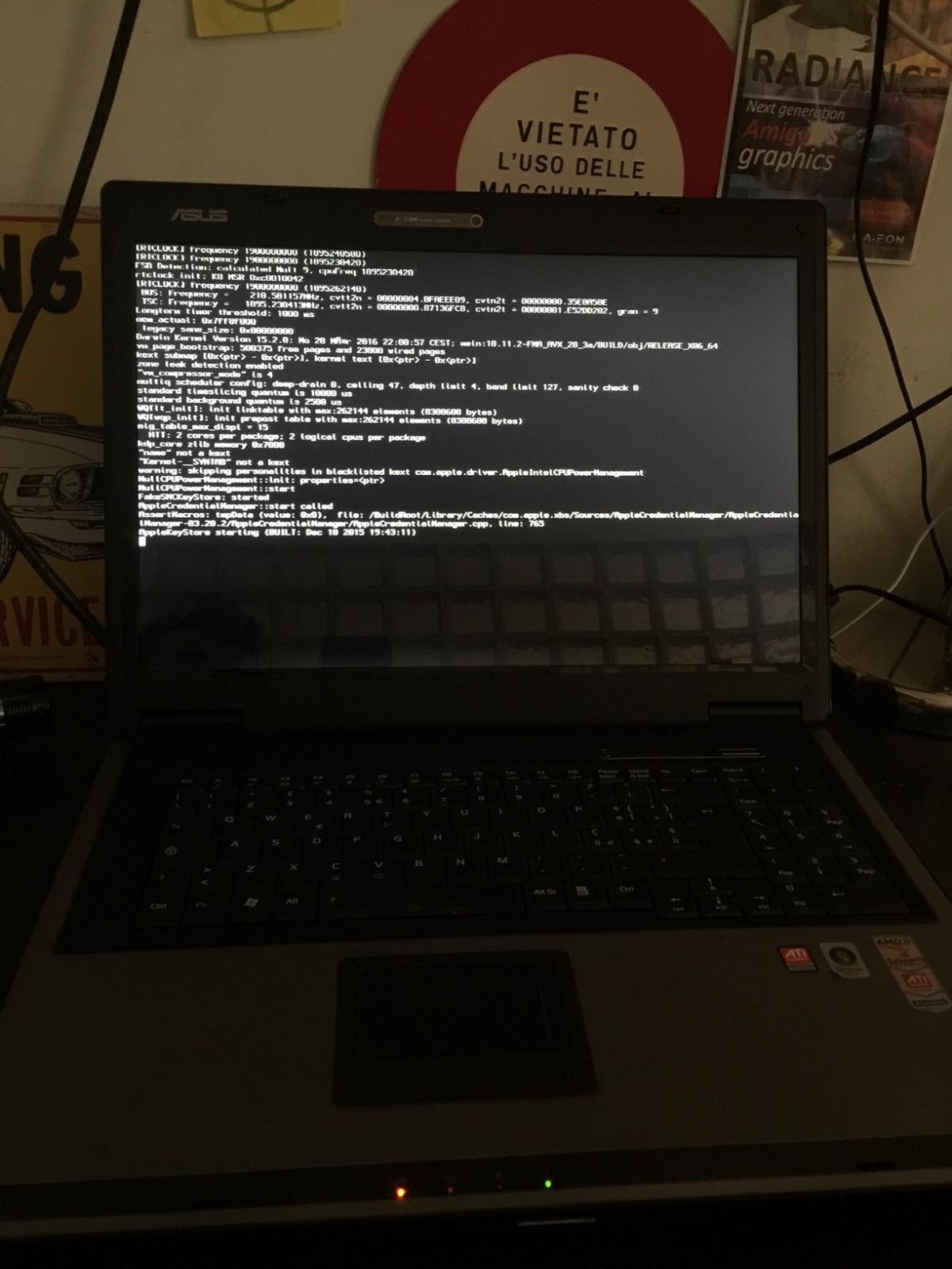

spakk Posted March 31, 2016 Share Posted March 31, 2016 @spakk I tried, and it still hangs there... I'm not so lucky. Can you upload an picture Link to comment https://www.insanelymac.com/forum/topic/311646-my-2%C2%B0-amd-attempt-asus-f7kr-turion64-x2/#findComment-2229160 Share on other sites More sharing options...
JahStories Posted March 31, 2016 Author Share Posted March 31, 2016 ok I'll post it later, but that's almost 1 to 1 the one posted Link to comment https://www.insanelymac.com/forum/topic/311646-my-2%C2%B0-amd-attempt-asus-f7kr-turion64-x2/#findComment-2229163 Share on other sites More sharing options...
JahStories Posted April 2, 2016 Author Share Posted April 2, 2016 here it is... I've to say that the mobo is having issues with the cmos battery that's not recognized, but windows boots. Link to comment https://www.insanelymac.com/forum/topic/311646-my-2%C2%B0-amd-attempt-asus-f7kr-turion64-x2/#findComment-2229687 Share on other sites More sharing options...
Shaneee Posted April 2, 2016 Share Posted April 2, 2016 Try removing the Caches. First remove /System/Library/PrelinkedKernels/prelinkedkernel then empty the following folder and reboot, /System/Library/Caches/com.apple.kext.caches/Startup Link to comment https://www.insanelymac.com/forum/topic/311646-my-2%C2%B0-amd-attempt-asus-f7kr-turion64-x2/#findComment-2229759 Share on other sites More sharing options...
spakk Posted April 2, 2016 Share Posted April 2, 2016 try to boot with: -x -f npci=0x2000 cpus=1 usekernelcache=No GraphicsEnabler=Yes /NO PCIRoot=1 (idelhalt=0) Link to comment https://www.insanelymac.com/forum/topic/311646-my-2%C2%B0-amd-attempt-asus-f7kr-turion64-x2/#findComment-2229797 Share on other sites More sharing options...
