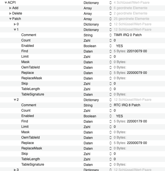

@devillived666
again, IRQ fixes !!!
When using SSDTTime script number 1 (HPETFix), the IRQ conflicts and the patches are also displayed in the terminal. Note these patches and integrate them into OC config.plist.
Example from my laptop:

1 hour ago, MacPeet said:
@devillived666

I got mine working by adding an aml for codec commander . I did merge those irq fixes when using the ssdt script (did option c ) but it didn't get the microphone working. Also redid device properties. One of the two things I did worked. Thanks!
