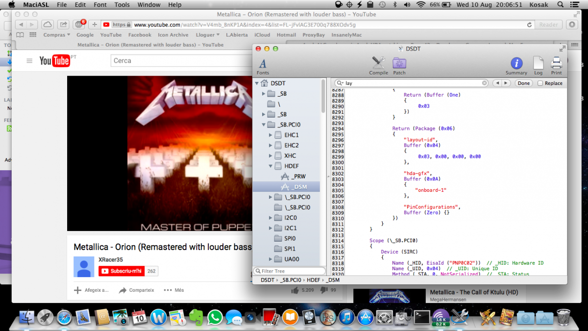

I have inserted the layout id 3 in my DSDT, is there a way to edit that to 4, just for a test??
Here are my ACPI files, if you have any suggestion.
patched.zip

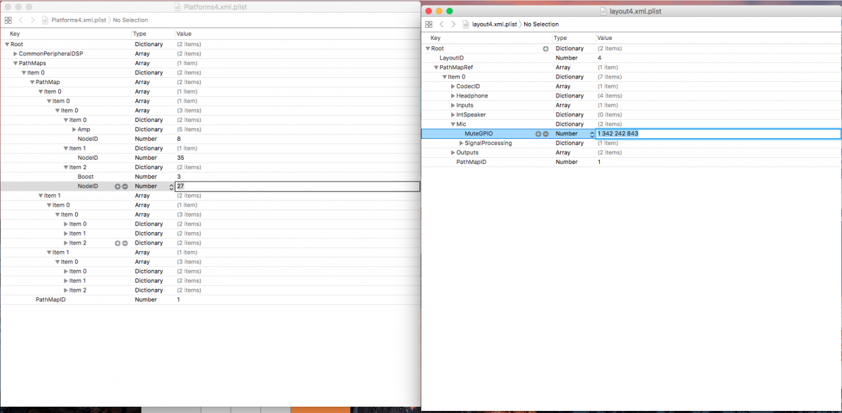

I think the edit for that layout should be in this area,
but i don't know what to modify, help please???

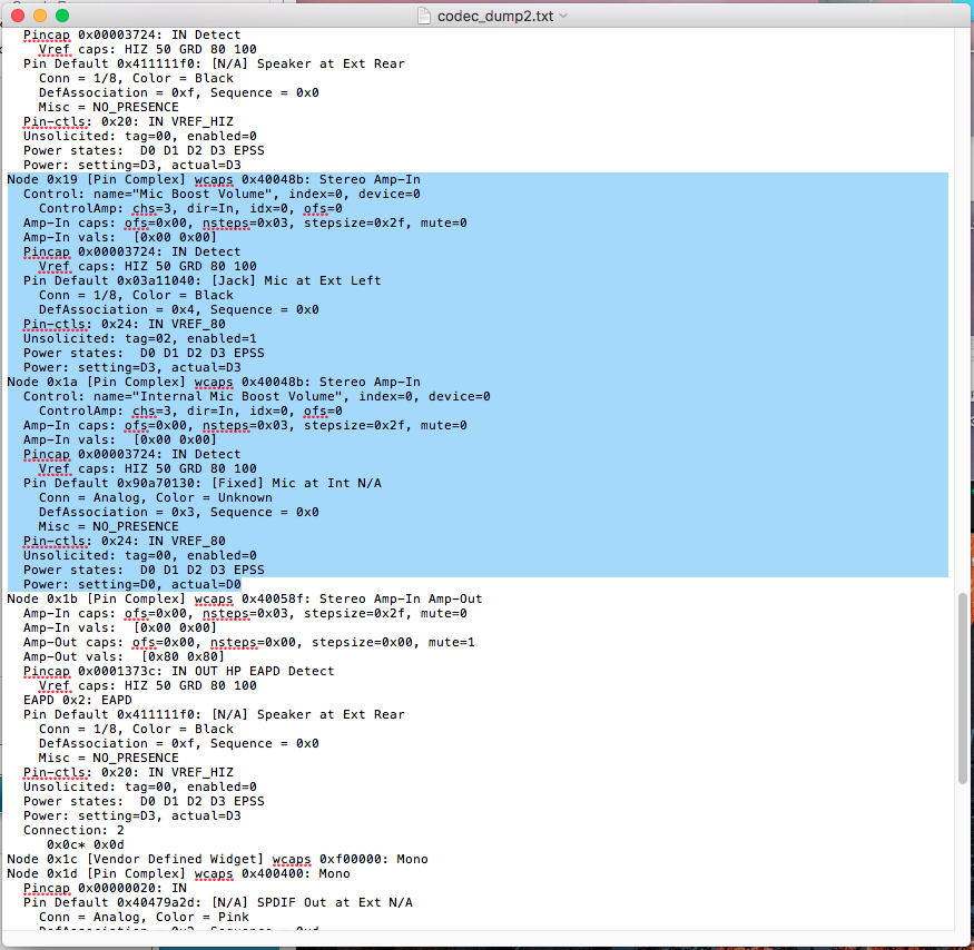

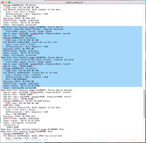

Here is the codec dump directly from Linux, for the HDMI and for the ALC 3236
Microphone really catches no sound at the moment, only static noise
Btw, i am using the layout id 4, which seems to be the best one for this codec
Thanks in advance for helping
codec_dump.txt
codec_dump2.txt

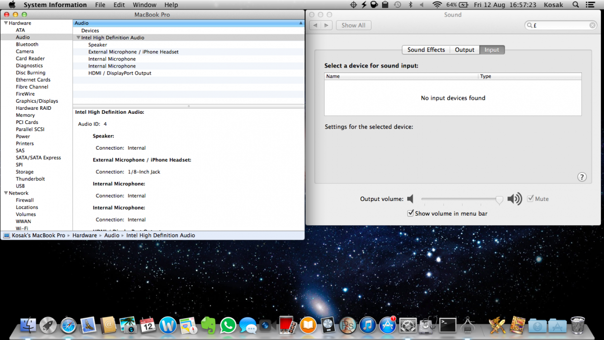

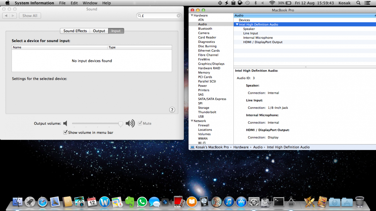

No devices found, bet result as of now is layout id 4 with the original AppleALC, anybody have ideas?

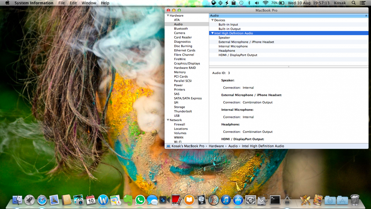

this is with the testing kext and layout id 3

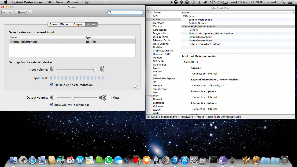

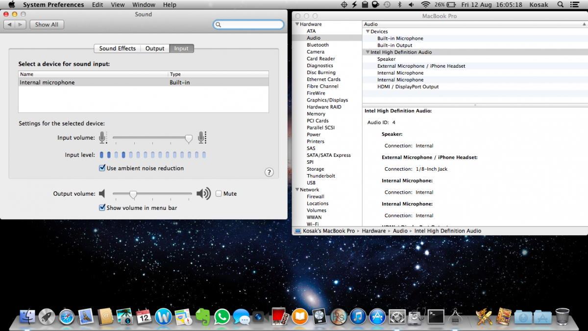

this is with layout id 4 and original AppleALC... any idea why two Internal Microphone entries appear??
The layout 4 seems to be the correct one, since I have a microphone/headphone port, an Internal Mic, HDMI port and Speakers

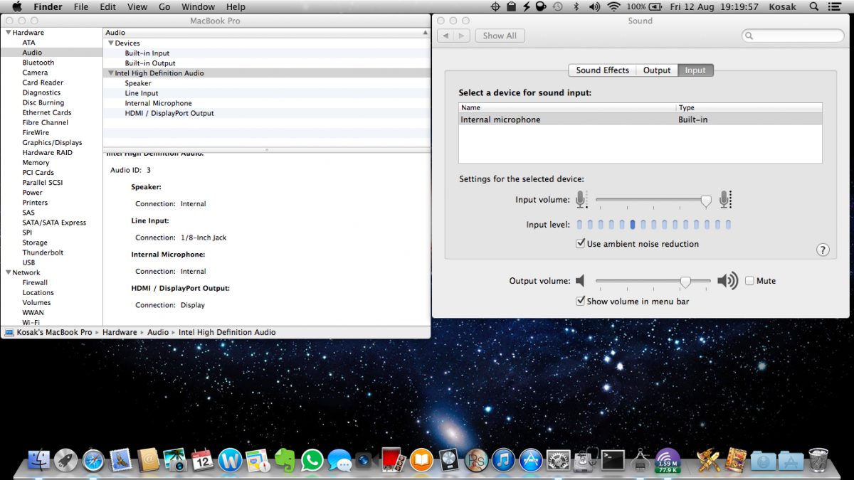

It works now :D but it only captures a hearable sound when I whistle, microphone volume is very very low.
Is there any way to boost it so it records the things in a louder volume?
