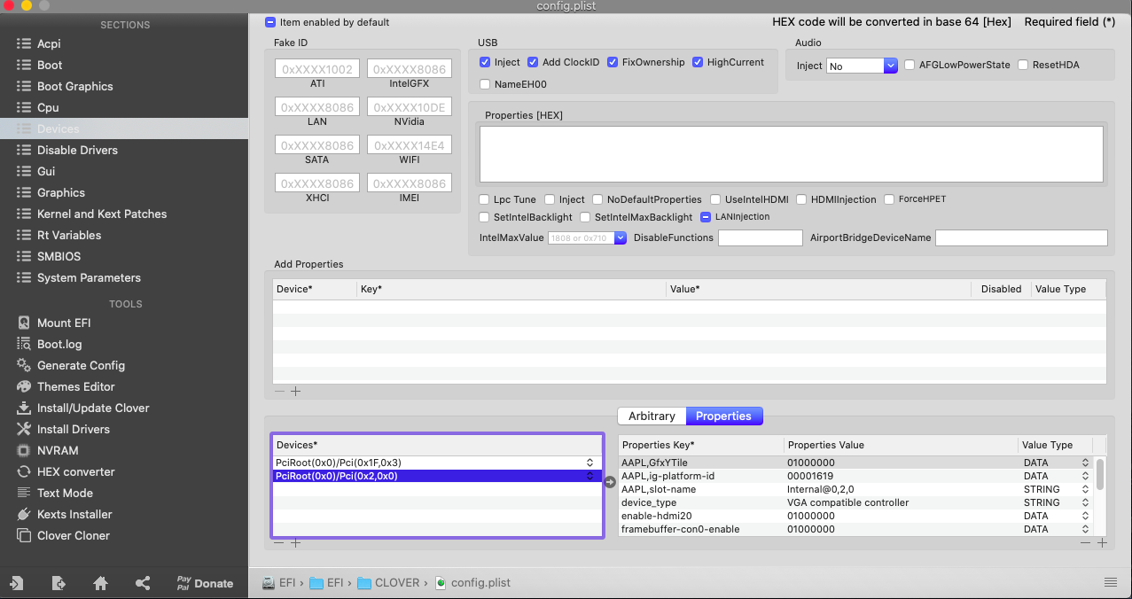

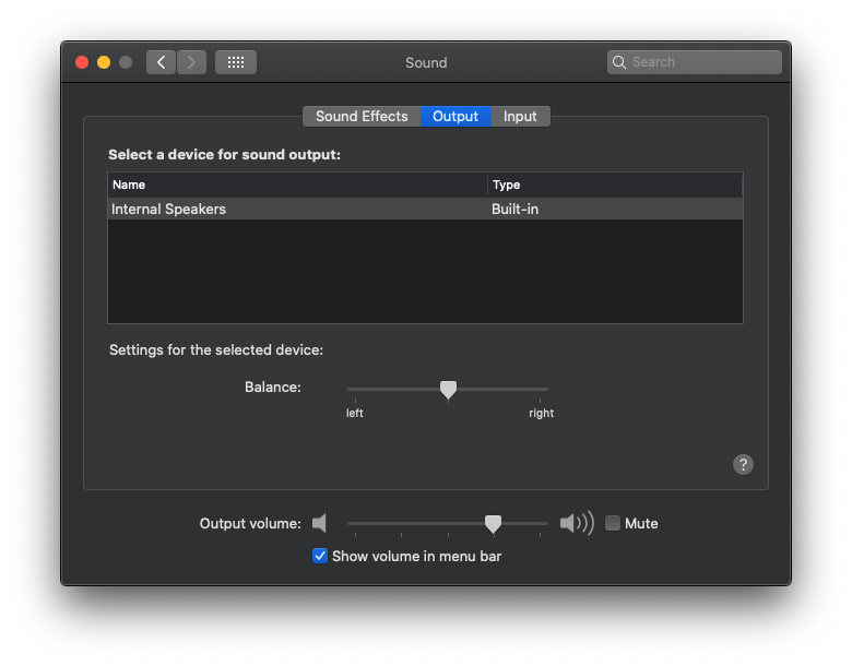

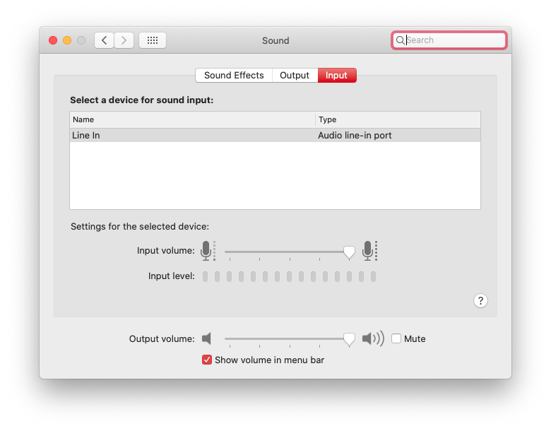

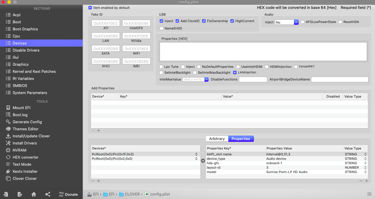

I can't use my microphone with Apple ALC. I'm using AppleALC 1.4.8 Release with Lilu 1.4.3 Release in macOS 10.15.3 (a Vanilla fresh installation, there is no other patchers such a VoodooHDA or cloverALC). My Codec is the VIA VT1705 chip, which is supported by AppleALC with only the layout 21. Interestingly enough, the patch was made for the Motherboard ECS H81H3-M4, which is exactly the one I'm using.
This is my OC config in DevicesProperties:
<key>PciRoot(0x0)/Pci(0x1B,0x0)</key>
			<dict>
				<key>layout-id</key>
				<data>FQAAAA==</data>
			</dict>
The Kext loads successfully and I have audio out working. Line Out works well, with no noises and great quality. Line In is also detected but I cannot hear the microphone. I can see on the Input Level bar that there is noise when I plug in the Microphone, but when I speak, there is no activity. I tried with a different Microphone but there is still no sound as you can see in the video below, only when you plug in it and remove it.

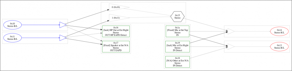

@mengshi
this ID 7:
this is ID 99:
Both have configured SPDIF-Out with nodes 30-6.
Maybe ID 7 has a conflict with two "orange" ?!
Please do a codec dump with a Linux Live version (example Ubuntu) for more details! This is better for a new codec for you.

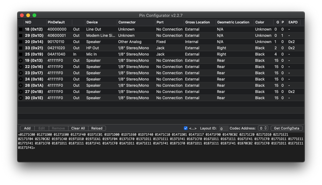

question to help matebook 13 users
https://github.com/Edoardo001/Matebook-13-Hackintosh and it's team leader : Edoardo001
ALC256
To make audio jack working
Open Clover>Config.plist and in Device>Properties>PciRoot(9x9)/Pci(0x1f,0x3)>layout-id and insert value "28" Download AlcPlugFixx.zip from download section and extract it Launch "sudo mount -uw /" in terminal Open "AlcPlugFixx" and launch "autoinstall.command", wait 10 second, click "enter", close terminal and reboot laptop
To make internal mic working
Open Clover>Config.plist and in Device>Properties>PciRoot(9x9)/Pci(0x1f,0x3)>layout-id and insert value "13" reboot laptop
can someone help to make jack and mic work togheter work together?

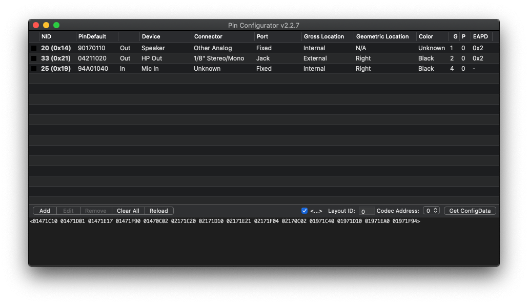

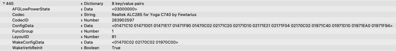

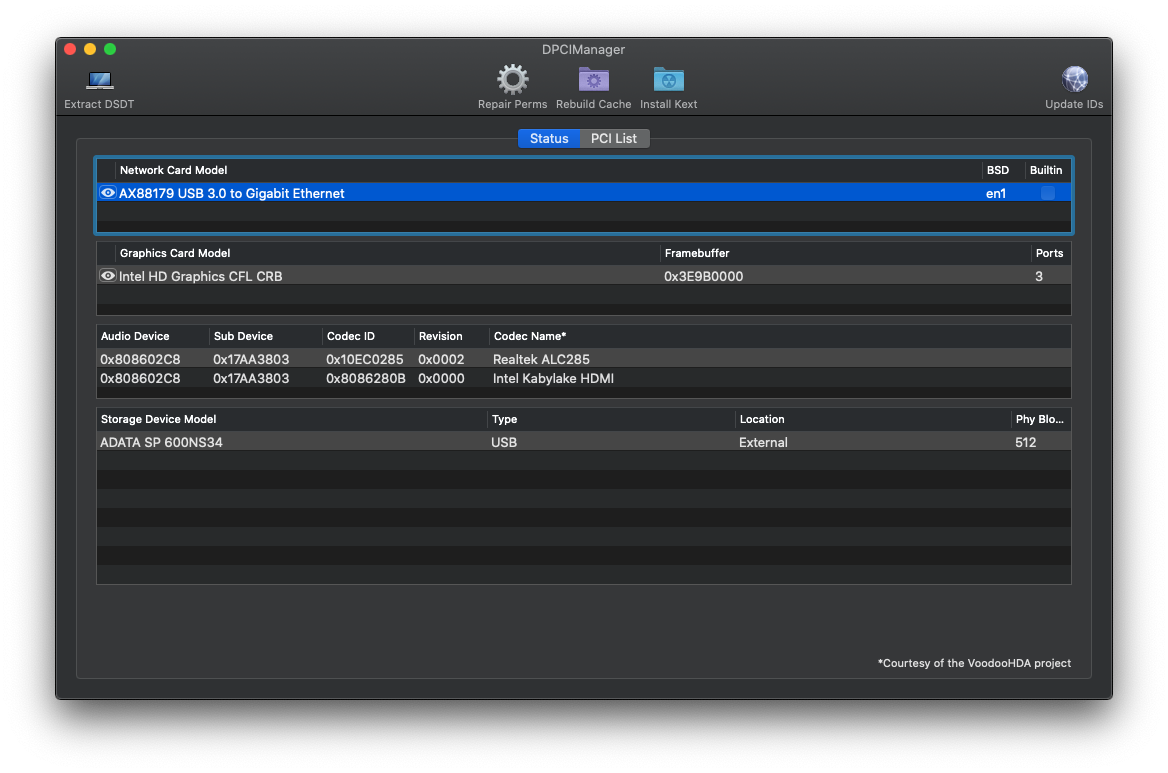

On 4/9/2020 at 5:05 PM, fewtarius said:
Howdy!  I posted a while back and still haven't been able to resolve my problem so I thought I'd try again as this is the last mile of my 10th Gen Hackintosh laptop build.  It's going to be a fairly long post, so I'll start with the TL;DR version which is that there is 400 series support in AppleALC and I can get my audio device to appear in macOS but I'm not getting any sound out of it.  I've been working on a custom layout but have thus far been unsuccessful.  I recognize that I won't have any mic support as the microphone array is Intel SST and that's completely fine.
Now to the more detailed part.  In Windows this is my device tree:
The microphone array won't be supportable from what I've learned, but the speakers are connected to the Realtek Audio device, so there seems to be hope here.
My codec is recognized on the 400 series bus as a Realtek ALC285.
I've done a codec dump from the very latest beta of Ubuntu 20.04 to make sure I have the latest kernel bits, here's the output:

In going through the dump I can see that my internal audio is at 0x14 and the output device is 0x02, and my jack is 0x21 and 0x03.  I'm using a copy of layout 21 which already has these node ids configured.
Node IDs 20/2 and 33/3
When I pull my codec into Pin Configurator, I get quite a lot of information about the codec which is mostly not useful so I've removed everything that I don't need and sanitized the verbs with the built-in functionality.
Default:
Sanitized:
I've exported the output to PinConfigs.kext creating layout 61, added the layout to ALC285/Info.plist, and the required Platforms61.xml and layout61.xml.  AppleALC builds perfectly, and I can load it on macOS but like the other layouts I've tried, I still get no audio.
image.png.350c3cc64e670aa194c9ffe780b7b6fd.pngimage.png.367ed576918fe75171e122e0fc4e33c9.png
Here's the debug log with it loading, it seems to be the same no matter what layout I choose.  To me, it looks like it's starting up just fine.
AppleALC debug log:

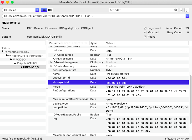

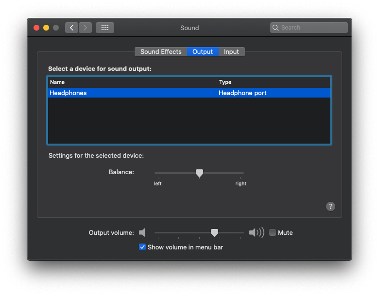

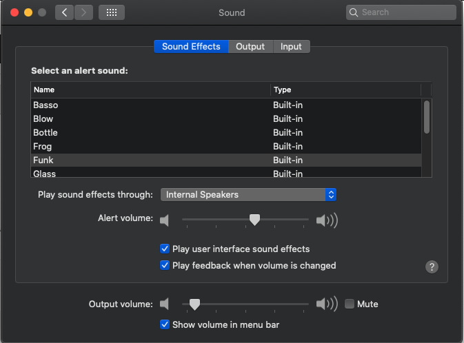

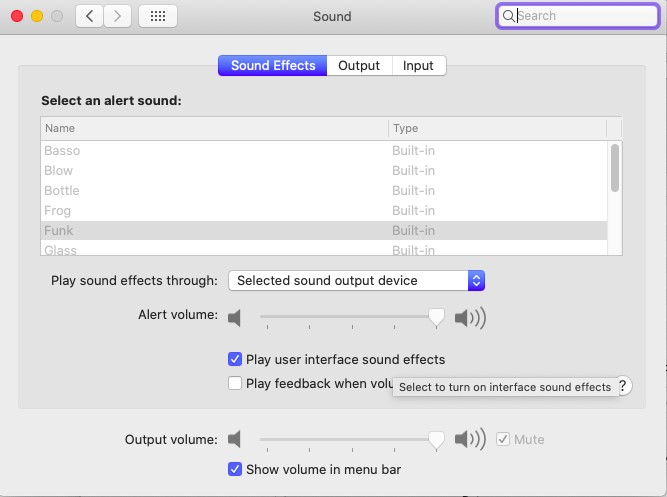

What's super interesting is that it appears as though it's working, volume up/down, mute appear to work.  The internal speakers and headphones switch when I plug something in, but no audio.
image.png.21595e516740db4a5d956bee93f22976.pngimage.png.b1227fa4715d2676a5adb7e662fe606e.png
I'm sure this is just something silly that I've overlooked, but I can't for the life of me figure out what I'm doing wrong.  I've tried OC and Clover with all of the IRQ fixes, etc but I'm completely at a loss with this one.  Hopefully, someone will look at it, and see pretty quickly whatever it is that I'm doing wrong.  Really would appreciate any help you folks can provide.  Thank you all in advance, and sorry for the wall of text!
Anyone have some time to help figure out what's going on here?
ALC256

1. Laptop model/Motherboard model: Desktop Gigabyte B360M, i3-8100, 16GB
2. Codec name: ALC887
3. Layout used with the info what works for you (ideally if you try them all): 3
4. OS X versions you tried: 10.15.4
AppleALC 1.4.8
The default audio output device is reset after each restart. I have two audio devices. Both are audio 3.5mm jack headphone lines. The jack in the back is considered to be the built-in speaker, while the front jack is headphone line. Even though I set my default to the built-in speaker, it got reset back to headphone line every restart.

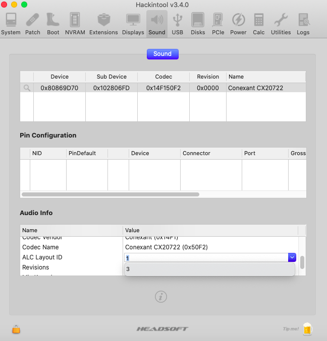

1. Laptop model/Motherboard model- Dell Inspiron 7359 Intel HD 520
2. Codec name- Conexant CX20722
3. Layout used with the info what works for you (ideally if you try them all)- 3
4. OS X versions you tried- 10.15.4
5. Kext version- v1.4.8
I used hacktools for export audio patch.I saw that the only available layout-id is 3 but it seems like it isn't working with my codec. I attach all files (screenshot)including my efi folder.
Hope to hear good from you soon.
