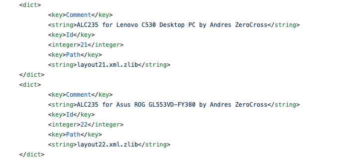

Layout 22 ALC235 for Asus ROG GL553VD-FY380 (#448)
add some Chinese translate,and support FX53VD ALC235 with ID : 15 (#362)

I still don't get, i made LayoutID 22 for GL553VD-FY380 and internal microphone here is working good. There are many model of GL553VD.
If your system working good with LayoutID 16 then use it.

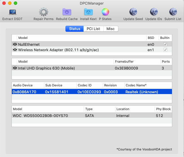

Hello. I'm using laptop i5-10210u. (Jooyon Tech J7FC)
I get sound about ALC293 via AppleALC. It works good for Speaker, Headset, HDMI.
But no work for Mice. I tried all alc id, but mice not working. (I currently use alcid 11)
DPCIManager shows my codec "Unkown"
here are my codec, ioreg files.
plz help me.
codec_dump.txt
Humings-MBP.ioreg
Edited by leezakka

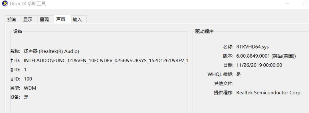

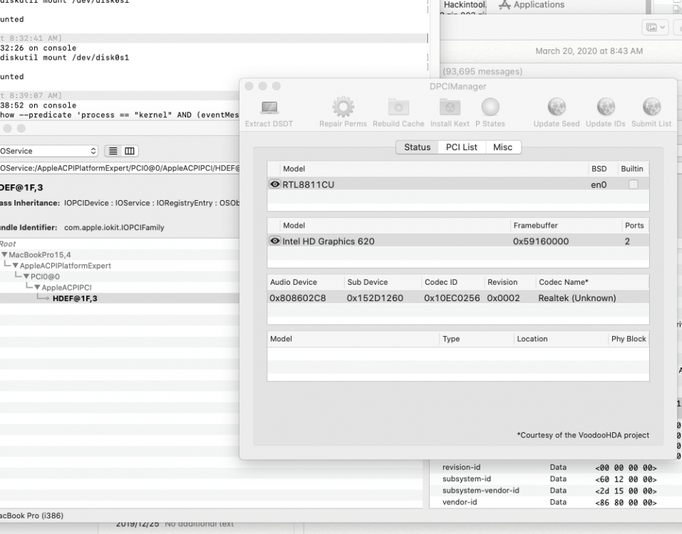

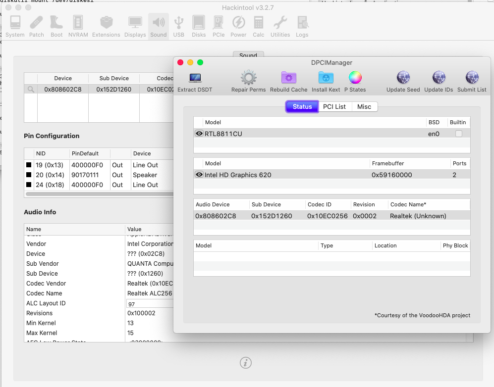

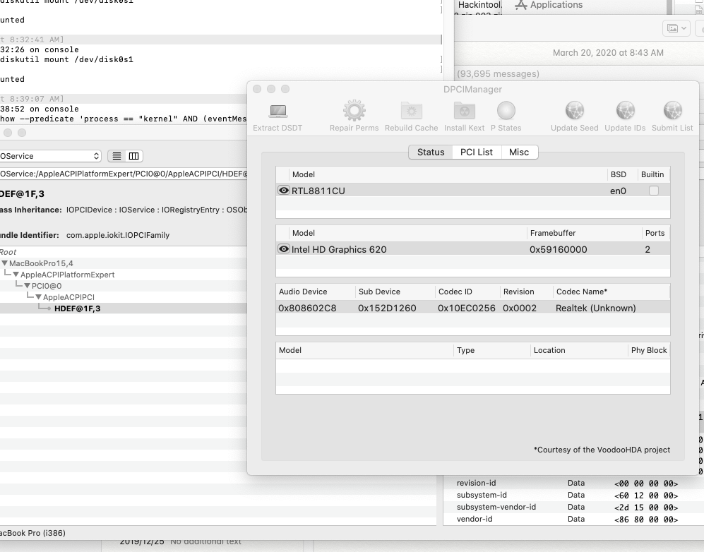

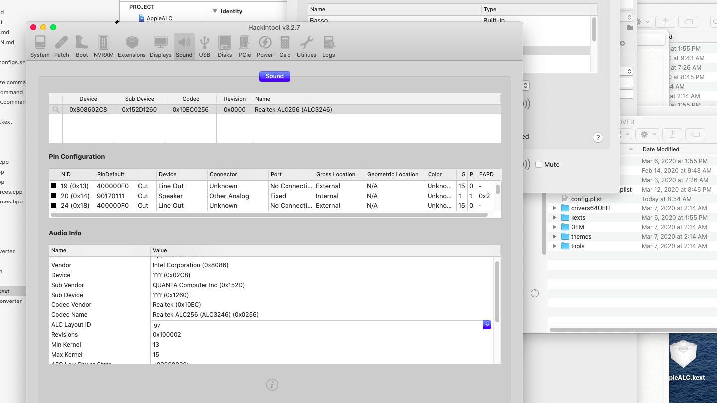

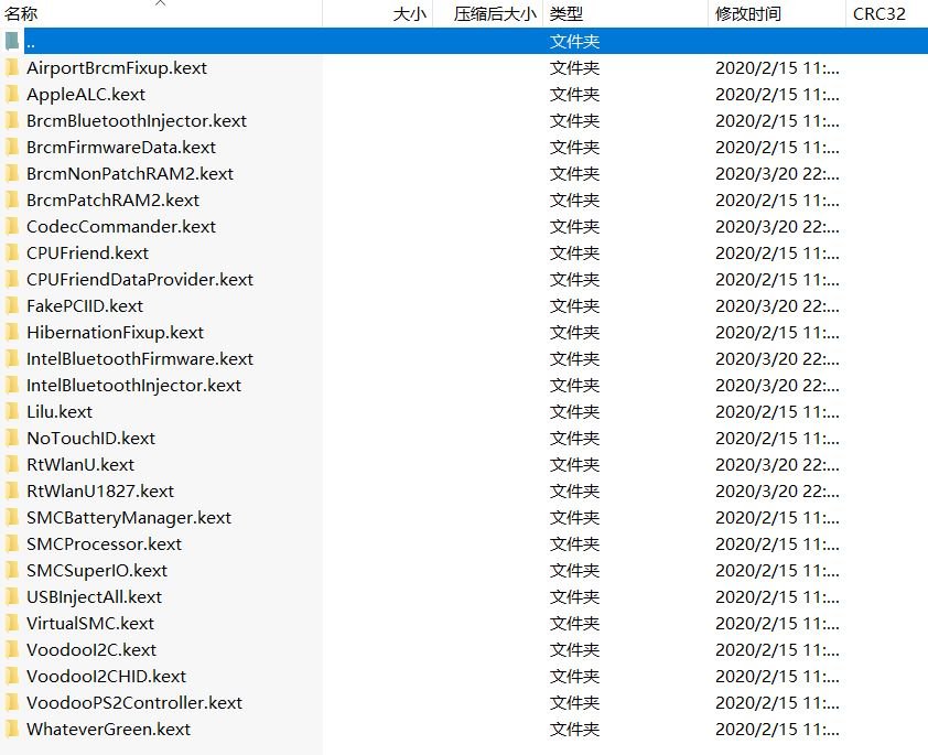

Hi Guru,
I encounter an issue with my ALC256 sound card. I try with the lay_out id 57, 56 97, the applealc load and working, but no sound comes out from the internal speaker, and the jack.
Would you like to help me with this.
Many thanks in advance!
Belows is my laptop info:
Brand: Huawei Magicbook 2019
CPU: I5 10210 comet lake 1.6G
Audio card: ALC256 02c8  125D1261
IGPU:UHD620
DPU:MX250(disabled)
my system is Catalina 15.3

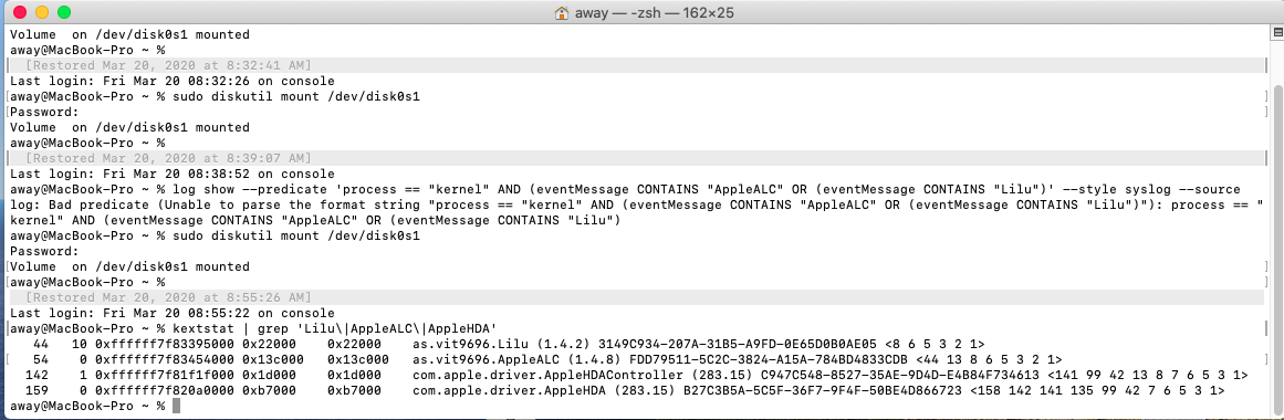

Here I attached my Codec_dump file, IOReg files,config plist file. and Hackintool screen, and HDA load screen ect.
Best Regards,
Alex

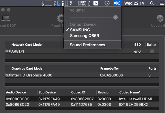

Hi everyone. I kindly ask you for advice regarding the following issue:
I'm running Catalina 10.15.4 and using AppleALC 1.4.7 to try and get audio working on a Toshiba L50-A-1D5 laptop (i7 Haswell, HD4600 igpu, full specs down below).
I'm using Clover 5107, with all added kexts in C/k/O. I have a clean AppleHDA kext and no custom kexts in /S/L/E or /L/E.
I use layout-id=3 for my IDT 92HD99BXX audio (injected as device property; also tried with alcid=x, DSDT patch, regular Clover Inject).
I can only get HDMI audio to work, as you can see from the attached picture. The internal speakers/audio jacks are not recognized.
Tried VoodooHDA and that makes them work, but the headphone audio is very low, so I want to do it properly with AppleALC.
DPCIManager shows two audio devices, one for HDMI and also the IDT one, which doesn't work.
IOREG shows the same two devices as HDAU (8086:0C0C) and HDEF (8086:8C20), respectively.
You have every possible log and diagnostic on my Github. Links below. I also store my full EFI there.
IOREG | DPCIManagerAppleALC_boot_log | Mac_System_Report | gfxutil_dump | codec-dump-card0-hdmi | codec-dump-card1-idt | pinconfigurator_idt_verbs | EFI/Clover
Cheers to anyone that can figure out the issue!
