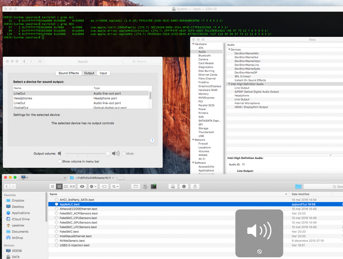

yassinex Posted May 13, 2016 Share Posted May 13, 2016 Thank you vit9696, I understand your point! vandroiy2012, you're the man ! It's working, thank you ! A good start This is my report : The only working AppleALC is the 2nd version and only with Layout-ID 11 (5,1 ) - Attached, What I'm noticing : - No Volume Control 1- Line-out 1 : Working - It activates either Front Or Rear Out - One at a time 2- Headphones : Not working. 3- Line-out 2 : Working - It activate only Rear Out. 4- DigitalOut : I cannot test it atm. 5- Mic Ok but with a feedback delay. 6- C/Sub : Not working / Not mapped ? This is a wonderful start, I'm really grateful. Can you help for the next step ? AppleALC-11-12.kext.zip 1 Link to comment Share on other sites More sharing options...

yassinex Posted May 13, 2016 Share Posted May 13, 2016 @yassinex Try this. Layout 11 - 5.1 (from previous version) Layout 12 - NEW version AppleALC.kext.zip Report. Layout 12 - it not working ( Only HDMI audio from my Nvidia is showing in sound control pannel ) Btw : when I add "21570A01" at the end of the ConfigData in PinConfigs for Layer 11, I can see Volume Control, this works but has no effect on sound ( like it's not mapped )... Link to comment Share on other sites More sharing options...

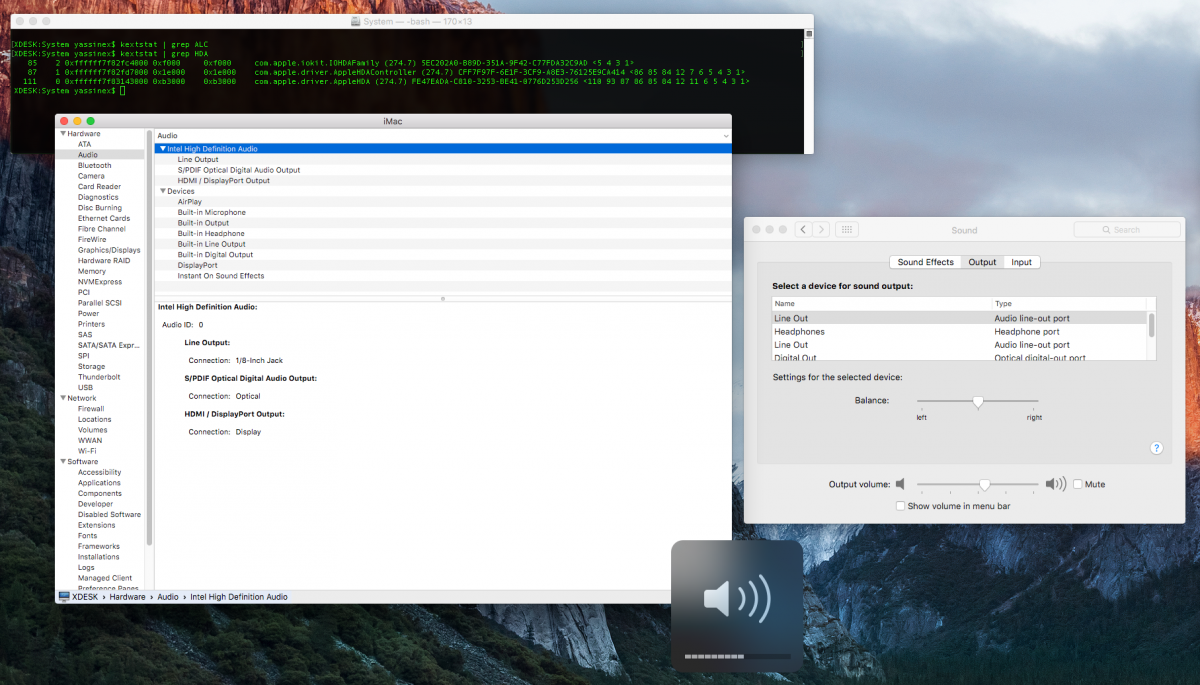

yassinex Posted May 13, 2016 Share Posted May 13, 2016 Exactly, the same Kext. This is why I included it in my first post. I'm using it now, VC works, but rear out not working. I'm using with this Kext Layout-ID : 0 ( The first one in the HDAConfigDefault array list ) You can find my ioreg zipped export. Tell me if it's ok for you. Edit : I did another test, with this kext Headphone is working Front and rear/ Rear output Ok too. yes this is the best kext... XDESK.ioreg.zip Link to comment Share on other sites More sharing options...

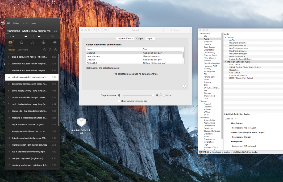

yassinex Posted May 13, 2016 Share Posted May 13, 2016 The same issues ( No headphone sound Front/Back, and no VC ).... Edit : My IOReg with AppleAlc installed and a screenshot XDESK-AppleALC.ioreg.zip Link to comment Share on other sites More sharing options...

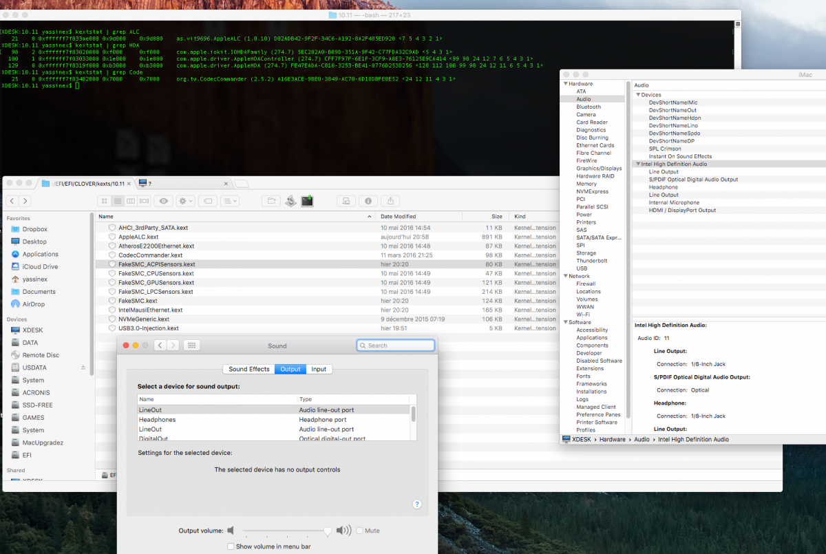

yassinex Posted May 13, 2016 Share Posted May 13, 2016 Thanks Mikey 1979. I saw CodeComander.kext bundled inside the patched AppleHDA.kext provided in #408. But in my current configuration I don't have it loaded, only AppleALC.I'll try to load it to see the effect.EDIT : No changes..... You can find my Config.plist, CodeCommander.kext, IoReg and the last AppleALC I use atm ( with CodeCommander this time ). and a screen ....still no VC, no headphone sound out. Perhaps I can help with logs if you need any ? And btw if you can confirm that my config,plist is ok, it 'll help me going forward. I'm asking people with CA0132 from the CA0132 post : http://www.insanelymac.com/forum/topic/309283-creative-ca0132-g1sniper-m3-patch-for-applehda-or-voodoohda to test the latest AppleALC. CodecCommander.kext.zip AppleALC.kext.zip XDESK-WithCodeCommAppleALC.ioreg.zip 1 Link to comment Share on other sites More sharing options...

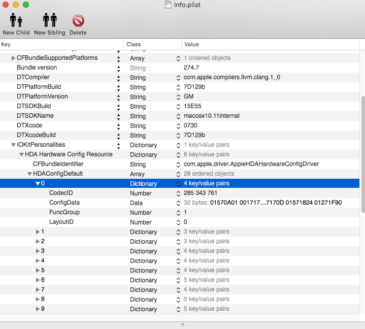

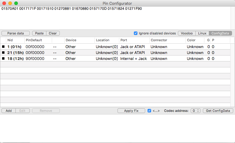

yassinex Posted May 15, 2016 Share Posted May 15, 2016 You can find the attached kext with my contribution : With Layout -11 you can get : Working : - Main Out - Headphones Front and back - Rear - Mic - HP switching Not Working : - Volume Control - Sub/c - SPIDIF/Digital ( Although not tested ) With Layout 12 you can get : - Main Out - OK but sound is boosted - Volume Control - OK I made 100 try and test to narrow the right ConfigData codes/ Map. Fyi, This is the configdata that map I found : Volume Control = 01570A01 Rear = 01171E01 Front = Any/Nothing Headphone Front / Headphone rear = 01270881 SUB = ??? Microphone = 01271F90 SPIDIF DIGITAL = ??? The weird thing is that you cannot combine the volume control code with the rest, it will mute HP / Rear...etc. @buyjoey, thanks alot for your help @wern apfel, you said you have a kext with Sub working...if you can pass it to me ( or narrow the right code ), it will make the Layout 11 more complete. @vandroiy2012/vit9696, it's really strange that with wern apfel AppleHDA kext, the code is combining VC HP ..etc is working and not with AppleALC. is it a bug ? AppleALC.kext.zip Link to comment Share on other sites More sharing options...
vandroiy2012 Posted May 15, 2016 Share Posted May 15, 2016 It's not a bug i'm sure... For now i haven't seen 100% working resources for CA0132. Resources from wern apfel's kext kinda weird... I don't know how they work with this pinconfig It shouldn't work at all with this pinconfig data... This data i take from the kext you confirm WORKING for you 100%!!! AppleHDA.kext_10.11.4_front_HP.zip So my point is you should beg wern apfel to upload all resources with correct pinconfig data, unpacked platforms and layout... Also ask him to define what bin patches he made in his kext... Your codec is NOT an exception. If you provide WORKING resources, correct pinconfig data and correct binpatches AppleALC will inject it and you get the same working sound as with kext attached higher. Please understand me i don't want to dig in this mess... 1 Link to comment Share on other sites More sharing options...
