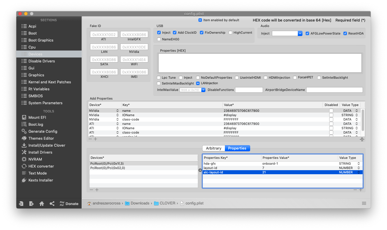

Andres ZeroCross Posted January 12, 2019 Share Posted January 12, 2019 10 minutes ago, yamahahornist said: So I have an Acer Predator Helios 500 PH517-51-72NU laptop; here are the basic specs: CPU: i7 8750H GPU: 1070 Ram: 16gb DDR4 Here is my clover CLOVER.zip So I have an Acer Predator Helios 500 PH517-51-72NU laptop; here are the basic specs: CPU: i7 8750H GPU: 1070 Ram: 16gb DDR4 Here is my clover Use this,, reboot and upload your IOREG again CLOVER.zip Link to comment Share on other sites More sharing options...

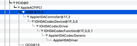

yamahahornist Posted January 12, 2019 Share Posted January 12, 2019 4 minutes ago, Andres ZeroCross said: Use this,, reboot and upload your IOREG again CLOVER.zip new ioreg dump with updated clover iodump3.ioreg Link to comment Share on other sites More sharing options...
Andres ZeroCross Posted January 12, 2019 Share Posted January 12, 2019 Now,, your codec is recognized I can check for future solution,, just wait Link to comment Share on other sites More sharing options...

Andres ZeroCross Posted January 12, 2019 Share Posted January 12, 2019 Just now, yamahahornist said: What layout id should I be using? So my laptop has a 3.5mm microphone input and also a built in microphone. The speakers are working and headphone detecting and auto switching is working though! I already set layout = 21 in your config.plist I need to check for Mic device Link to comment Share on other sites More sharing options...

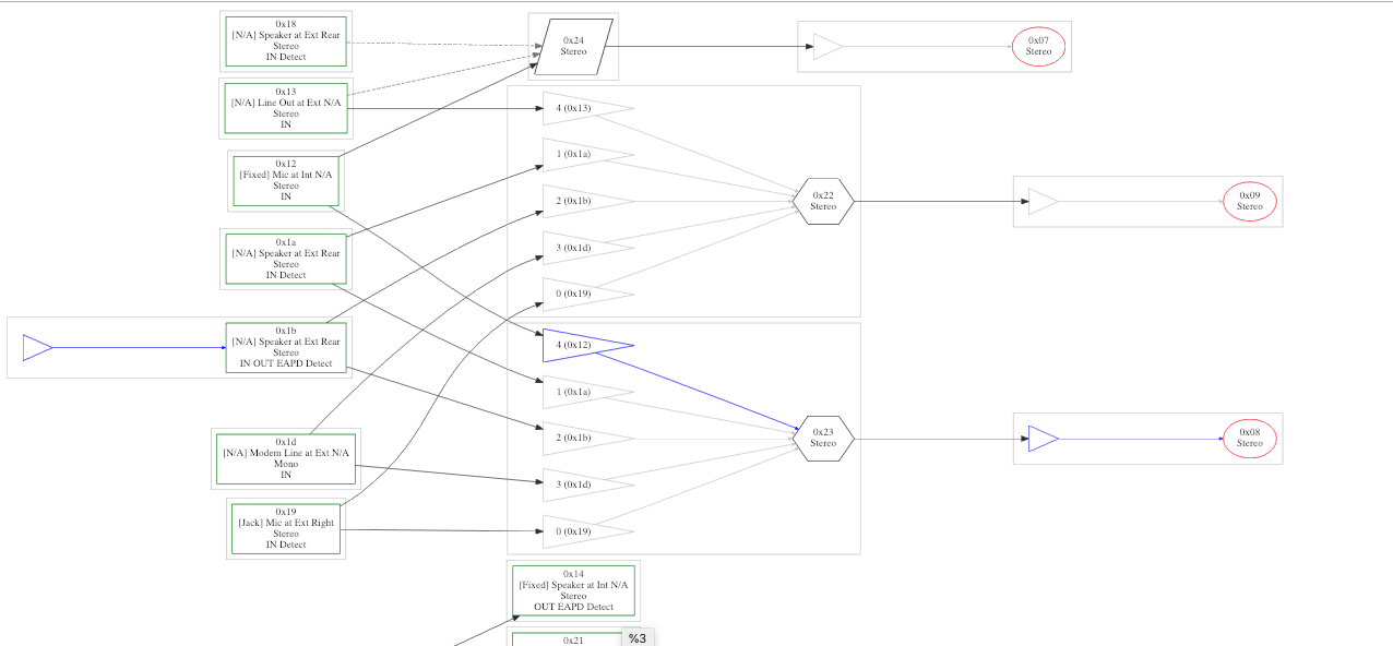

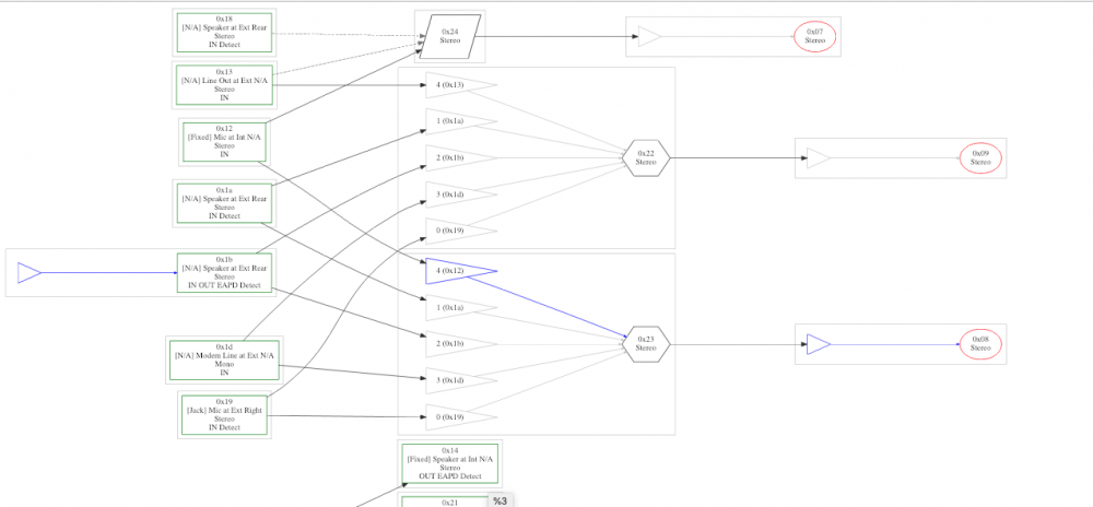

Andres ZeroCross Posted January 12, 2019 Share Posted January 12, 2019 I will check it later,, need to lunch. Your path of internal mis is this from your codec_dump.txt above. Did you upload wrong codec_dump??? Make sure it's from yours not other person Link to comment Share on other sites More sharing options...

yamahahornist Posted January 12, 2019 Share Posted January 12, 2019 3 minutes ago, Andres ZeroCross said: Just upload new codec dump, I will upload resource to AppleALC.kext's github soon Here is a fresh codec dump straight from Linux; thank you! codec_dump1.txt Link to comment Share on other sites More sharing options...
Andres ZeroCross Posted January 12, 2019 Share Posted January 12, 2019 2 minutes ago, yamahahornist said: Here is a fresh codec dump straight from Linux; thank you! codec_dump1.txt Ok.,, take a rest. I will upload new file soon 1 Link to comment Share on other sites More sharing options...

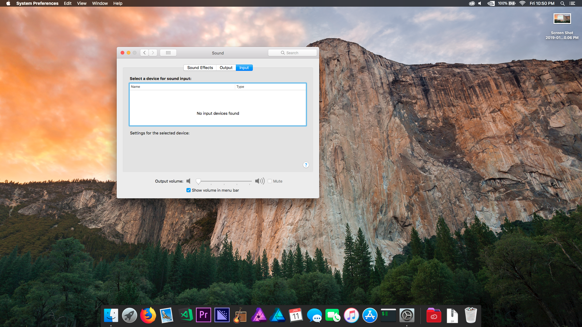

yamahahornist Posted January 12, 2019 Share Posted January 12, 2019 7 hours ago, Andres ZeroCross said: Replace the old ones,, and boot. Cek your internal mic AppleALC.kext.zip So this one broke output and input; no devices showing in output or input Link to comment Share on other sites More sharing options...

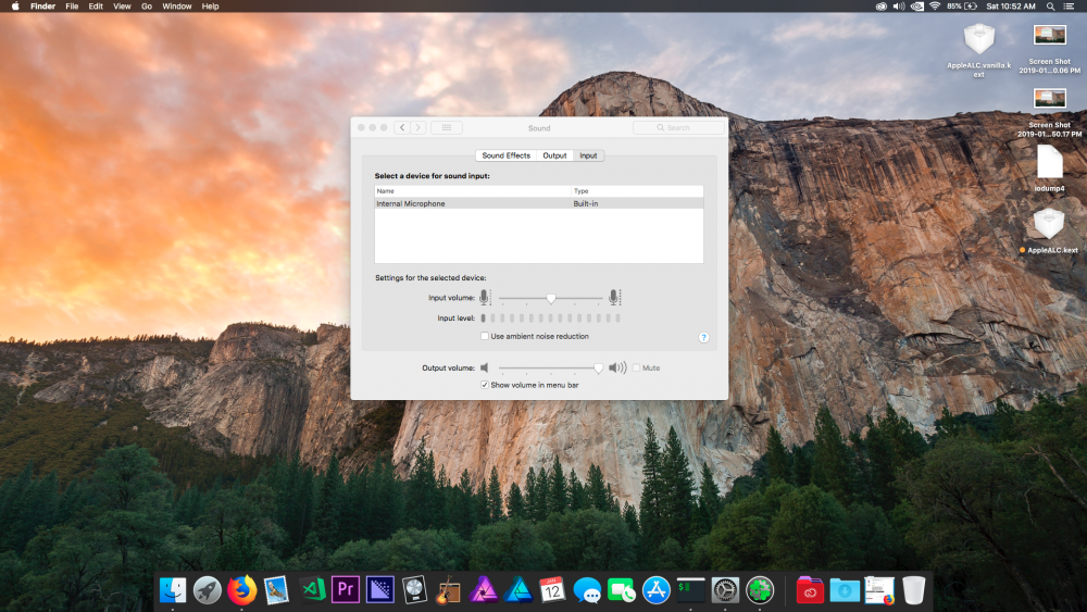

yamahahornist Posted January 12, 2019 Share Posted January 12, 2019 1 hour ago, Andres ZeroCross said: Use this,, check the internal mic AppleALC.kext.zip Output is working great; input is showing "internal microphone" but it's just white noise and isn't actually picking anything up. My laptop does have two "inputs": There is a 3.5mm jack for a microphone; then it has the built in one. Link to comment Share on other sites More sharing options...
