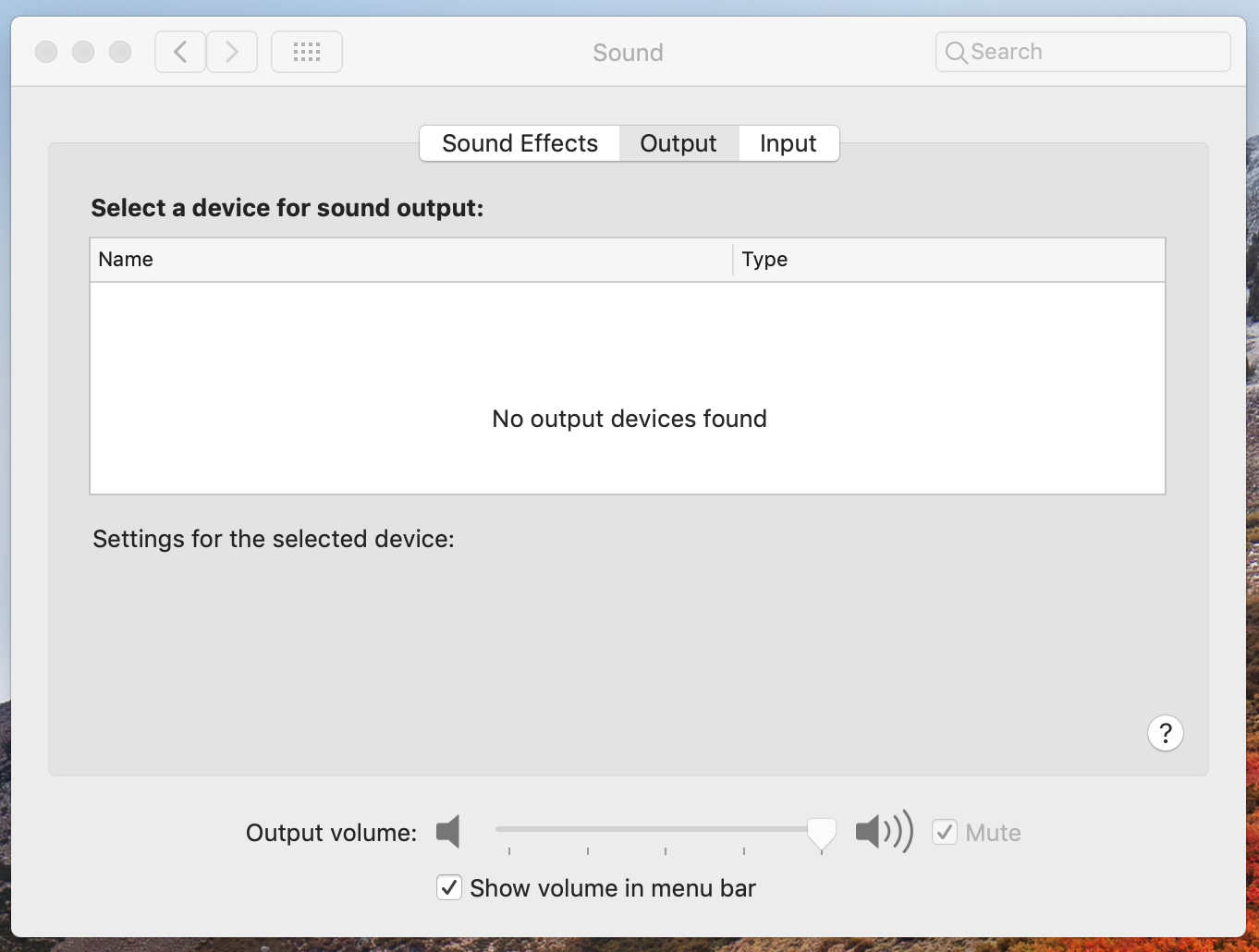

Andres ZeroCross Posted November 11, 2018 Share Posted November 11, 2018 Sorry for late reply. I did everything from scratch, dumped codec from arch linux, calculated pin configs, added codec and rebuilt. Here the result; Resources + IOReg: applealc_cx8150_troubleshooting.zip Screenshot: I don't know what's your problem?? You take a long time to reply. I am forget about your problem. Try to reply more quick to get responseSent from my Mi Note 2 using Tapatalk Link to comment Share on other sites More sharing options...

Andres ZeroCross Posted November 11, 2018 Share Posted November 11, 2018 Ok, i'll reply as fast as possible this time I got a new laptop "Asus VivoBook Pro 15", Installed Both Mojave and High Sierra and tried to make audio working. I got my audio codec from Arch Linux and Ubuntu and tried to add my codec, and till now I couldn't succeed. There is no audio output/input.1. Move all additional kexts to Efi/clover/kexts/other2. Rebuilt kextcache3. Open terminal and type "sudo kextcache -i /" and save the terminal output4. Open IOregistryExplorer version 2.1 and save the ouput5. Press F4 at GUI Clover to dump oem acpi table6. Upload clover folder7. Zip all requirement file and upload here. Sent from my Mi Note 2 using Tapatalk Link to comment Share on other sites More sharing options...

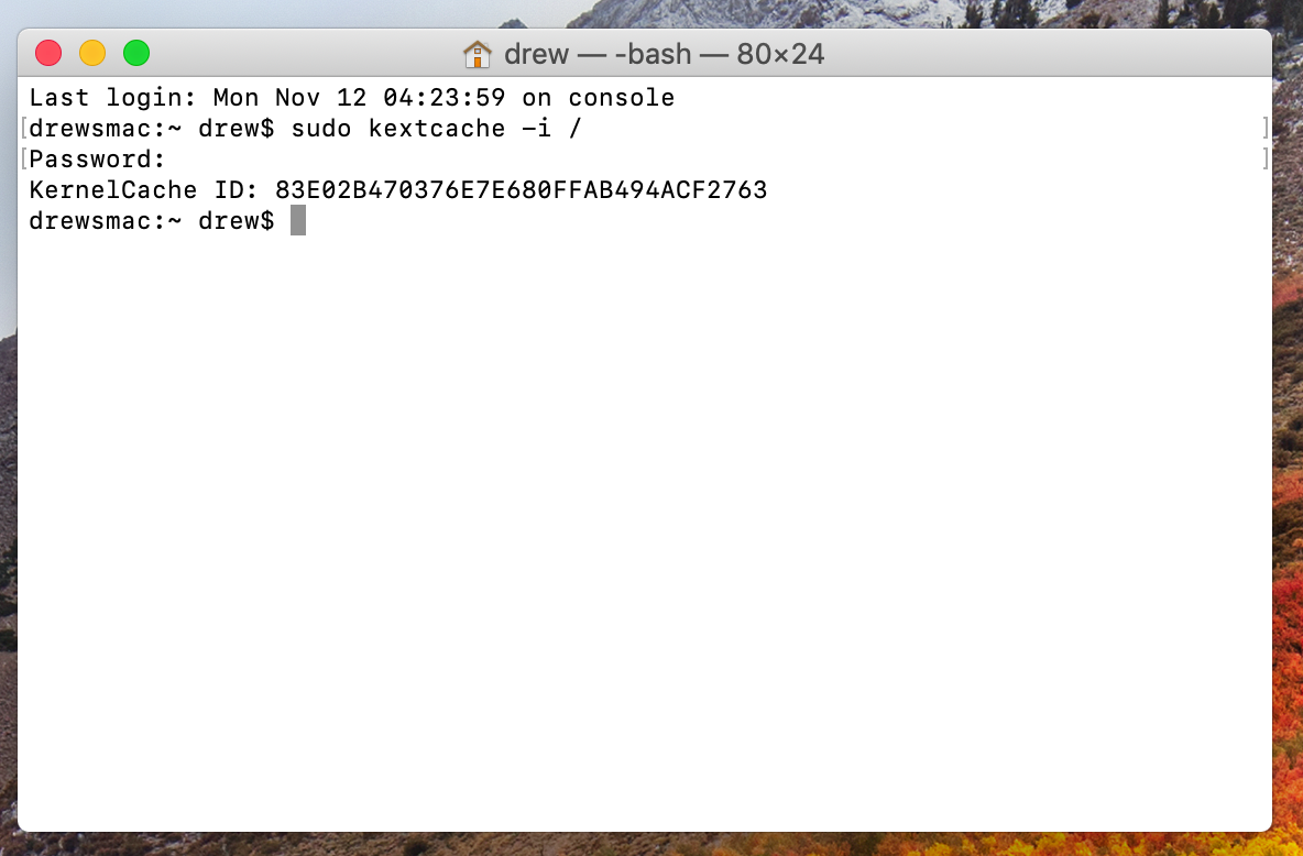

Justin Spier Posted November 11, 2018 Share Posted November 11, 2018 11 minutes ago, Andres ZeroCross said: 1. Move all additional kexts to Efi/clover/kexts/other 2. Rebuilt kextcache 3. Open terminal and type "sudo kextcache -i /" and save the terminal output 4. Open IOregistryExplorer version 2.1 and save the ouput 5. Press F4 at GUI Clover to dump oem acpi table 6. Upload clover folder 7. Zip all requirement file and upload here. Sent from my Mi Note 2 using Tapatalk I did all steps you said, Here the result: CLOVER.zip applealc_cx8150_troubleshooting.zip Link to comment Share on other sites More sharing options...
Andres ZeroCross Posted November 11, 2018 Share Posted November 11, 2018 I did all steps you said, Here the result:CLOVER.zipapplealc_cx8150_troubleshooting.zipOk, i just wait. Need to see the attachmentSent from my Mi Note 2 using Tapatalk 18 minutes ago, Justin Spier said: I did all steps you said, Here the result: CLOVER.zip applealc_cx8150_troubleshooting.zip There is no output log for "sudo kextcache -i /" Did you really read my comment above?? Link to comment Share on other sites More sharing options...
Justin Spier Posted November 11, 2018 Share Posted November 11, 2018 11 minutes ago, Andres ZeroCross said: Ok, i just wait. Need to see the attachment Sent from my Mi Note 2 using Tapatalk There is no output log for "sudo kextcache -i /" Did you really read my comment above?? I did, and what i got from that command was just the kernel cache id! nothing more! Link to comment Share on other sites More sharing options...
Andres ZeroCross Posted November 11, 2018 Share Posted November 11, 2018 I did, and what i got from that command was just the kernel cache id! nothing more! Ok, thats mean there is no additional kext at your system. Did your touchpad works right now?? Because i need to check first. I will make new configuration. There is too many hot patch of acpi to your system. And some of those patch won't work because missing dependency.Sent from my Mi Note 2 using Tapatalk Link to comment Share on other sites More sharing options...

Justin Spier Posted November 12, 2018 Share Posted November 12, 2018 5 minutes ago, Andres ZeroCross said: Did you use a whole clover configuration??? Never mix it, and make sure there is additional kext at L/E and S/L/E. That's the reason i need to see the kextcache ouput from terminal. But you don't give it. Sent from my Mi Note 2 using Tapatalk Dude, Thanks again, but I'm a Linux Developer and expert enough to avoid doing such a simple mistakes. Yes, I replaced the whole directory at first and got that messages and couldn't reach the desktop, then I migrate back to my own clover directory, changed the HDEF scope with your provided DSDT.aml, added your provided AppleALC and got no audio. Link to comment Share on other sites More sharing options...
Andres ZeroCross Posted November 12, 2018 Share Posted November 12, 2018 Dude, Thanks again, but I'm a Linux Developer and expert enough to avoid doing such a simple mistakes. Yes, I replaced the whole directory at first and got that messages and couldn't reach the desktop, then I migrate back to my own clover directory, changed the HDEF scope with your provided DSDT.aml, added your provided AppleALC and got no audio. Ok, maybe you should give file as requested.Provide kextcache output from terminal.Sent from my Mi Note 2 using Tapatalk Link to comment Share on other sites More sharing options...
Justin Spier Posted November 12, 2018 Share Posted November 12, 2018 Just now, Andres ZeroCross said: Ok, maybe you should give file as requested. Provide kextcache output from terminal. Sent from my Mi Note 2 using Tapatalk Trust me I have nothing in my /L/E and /S/L/E except macOS original kexts. I always add kexts to clover. Let's just focus on AppleALC and codec. Link to comment Share on other sites More sharing options...

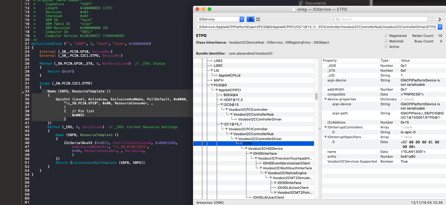

Andres ZeroCross Posted November 12, 2018 Share Posted November 12, 2018 40 minutes ago, Justin Spier said: Yeah, CX8150 has one more node (node: 17<->29). I meant the problem couldn't be from clover configs. Check this image,, you set GPIOPin 0x55 but the GPIOPin is not shown at ETPD properties at IOREG,, and for Interrupt specifier 0x5f, you must set GPIOPin must be set to 0x47 as per guide. It's just for one of another "strange"patch. There is other strange configuration too about HDEF properties too like i said before. Maybe i am wrong,, but as long as learn hackintosh this is duplicate and can make strange problem or wrong result/ Link to comment Share on other sites More sharing options...

Andres ZeroCross Posted November 12, 2018 Share Posted November 12, 2018 You are right, But my setup is correct too It's not our fault as I know, I talked with Alexandre, new asus laptops specially (VivoBook and ZenBook series) have serious issues, VoodooI2C does not work with Pin 0x0047. All I know who own these series set 0x0055:https://github.com/hieplpvip/ASUS-ZENBOOK-HACKINTOSHhttps://github.com/tctien342/Asus-Vivobook-S510UA-High-Sierra-10.13-Hackintosh Ok, just focus to the AppleALC.kext right nowSent from my Mi Note 2 using Tapatalk Link to comment Share on other sites More sharing options...
