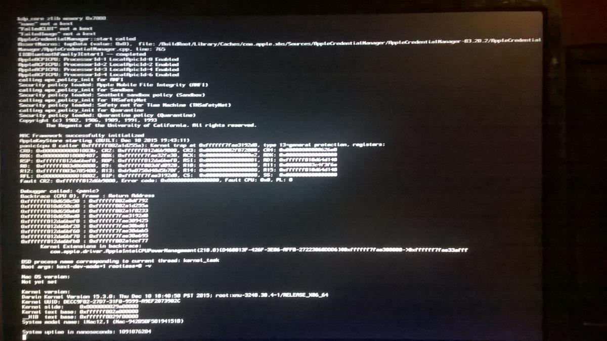

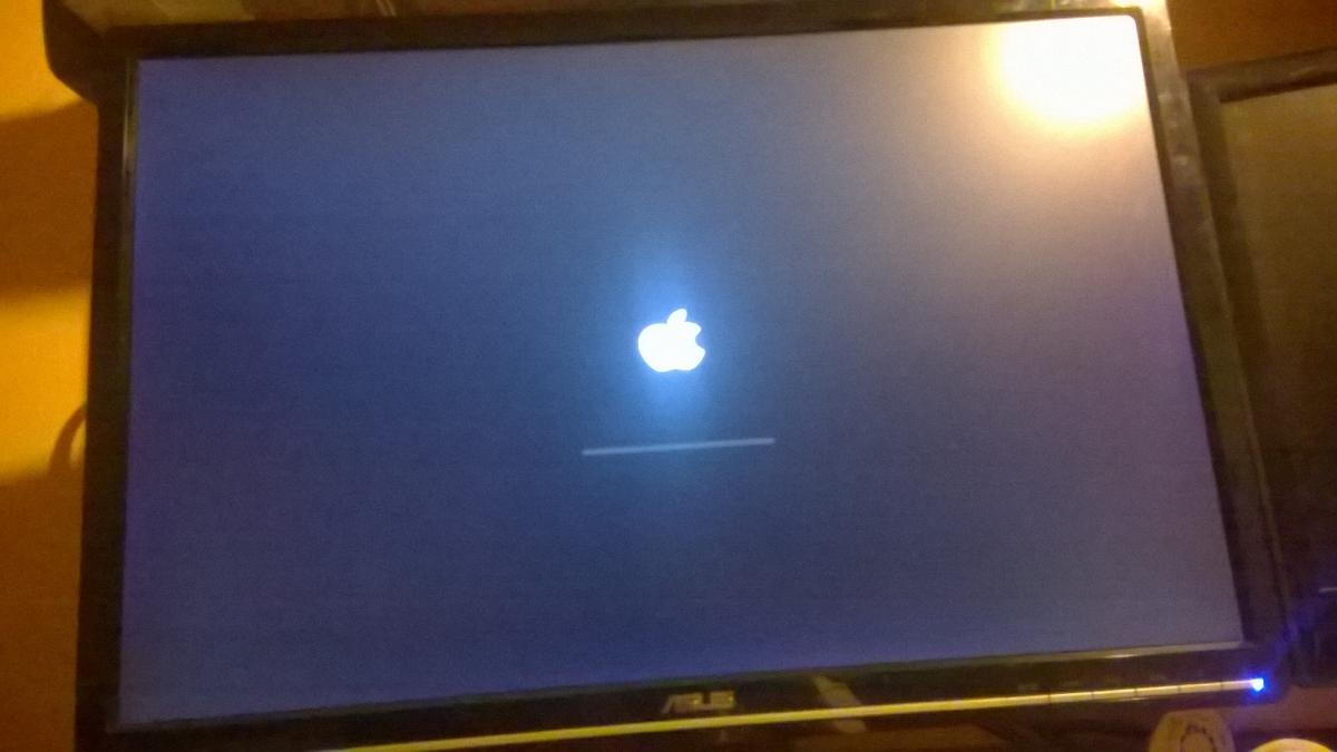

gengik84 Posted January 25, 2016 Share Posted January 25, 2016 se hai inserito il verbose, non vedi ne la mela, ne la barra di avanzamento... Fai così: premi la barra spazio quando sei alla GUI di clover, e seleziona avvio in verbose mode Link to comment Share on other sites More sharing options...
MarcoMax1299 Posted January 25, 2016 Author Share Posted January 25, 2016 Fatto... Succede questo: Link to comment Share on other sites More sharing options...

MarcoMax1299 Posted January 26, 2016 Author Share Posted January 26, 2016 Ho sostituito il file e provato ma si blocca ugualmente sul caricamento della mela, come in foto precedente. Link to comment Share on other sites More sharing options...

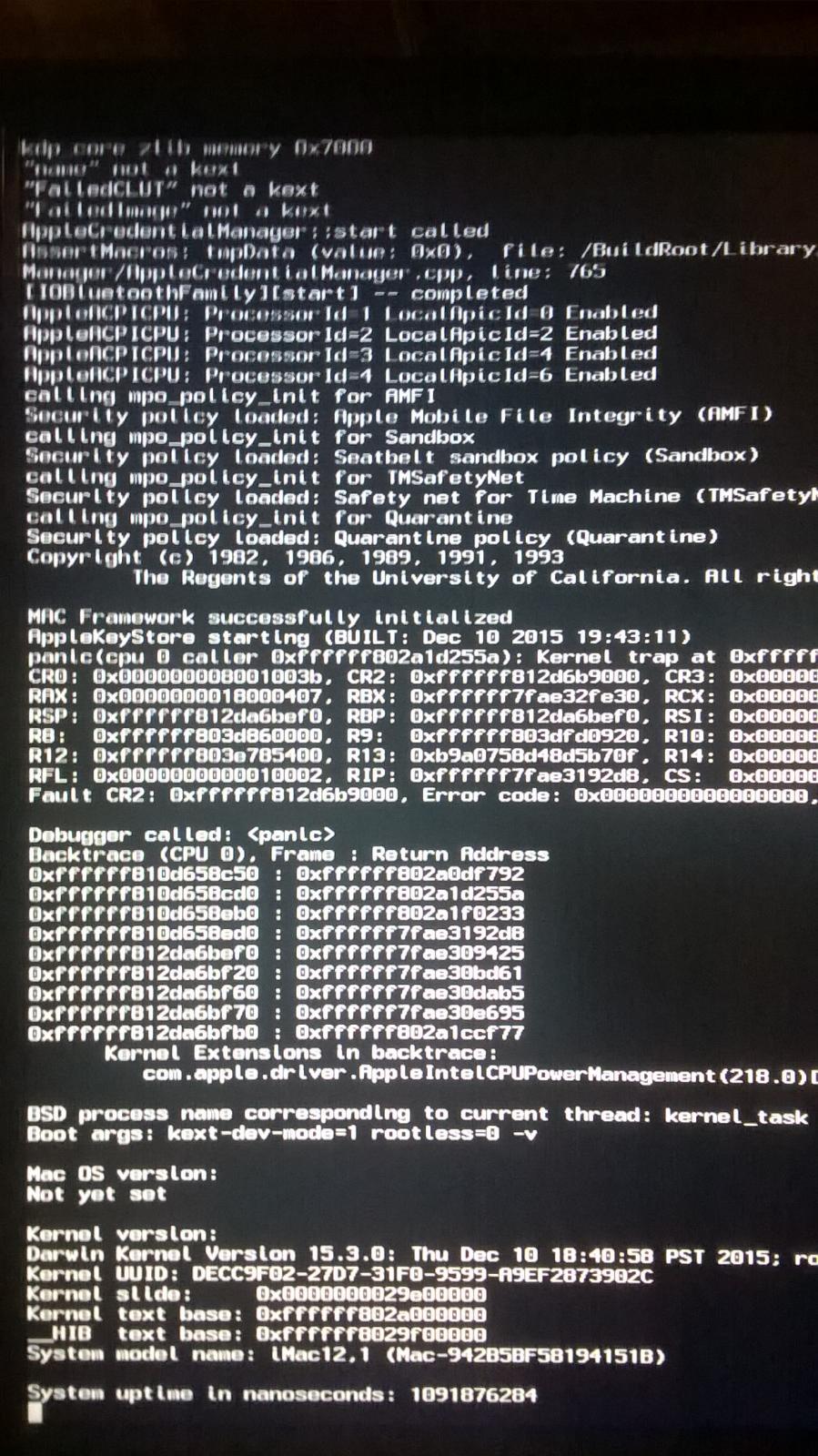

gengik84 Posted January 26, 2016 Share Posted January 26, 2016 Metti il kext allegato in EFI/Clover/kext/10.11 Riprova... Comunque posta la foto del blocco NullCPUPowerManagement.kext.zip Link to comment Share on other sites More sharing options...
MarcoMax1299 Posted January 26, 2016 Author Share Posted January 26, 2016 Si blocca ancora.. Allego la foto al momento del blocco Link to comment Share on other sites More sharing options...

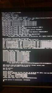

gengik84 Posted January 26, 2016 Share Posted January 26, 2016 Posti, per favore la foto, del blocco del verbose Foto del verbose, please.... Link to comment Share on other sites More sharing options...
MarcoMax1299 Posted January 26, 2016 Author Share Posted January 26, 2016 non ho capito, inende la foto del blocco della mela ?? perche l'ho postata Link to comment Share on other sites More sharing options...
gengik84 Posted January 26, 2016 Share Posted January 26, 2016 Devi avviare in verbose, (forma testuale)....questo per ogni prova... Postare la foto dove si blocca Come per esempio hai fatto al post 27 Link to comment Share on other sites More sharing options...
MarcoMax1299 Posted January 26, 2016 Author Share Posted January 26, 2016 A... non avevo capito.. io ho sempre avviato normalmente. chiedo scusa. Riprovo l'ultimo file e posto. Link to comment Share on other sites More sharing options...
gengik84 Posted January 26, 2016 Share Posted January 26, 2016 A... non avevo capito.. io ho sempre avviato normalmente. chiedo scusa. Riprovo l'ultimo file e posto. No problem....si sbaglia tutti..... Link to comment Share on other sites More sharing options...

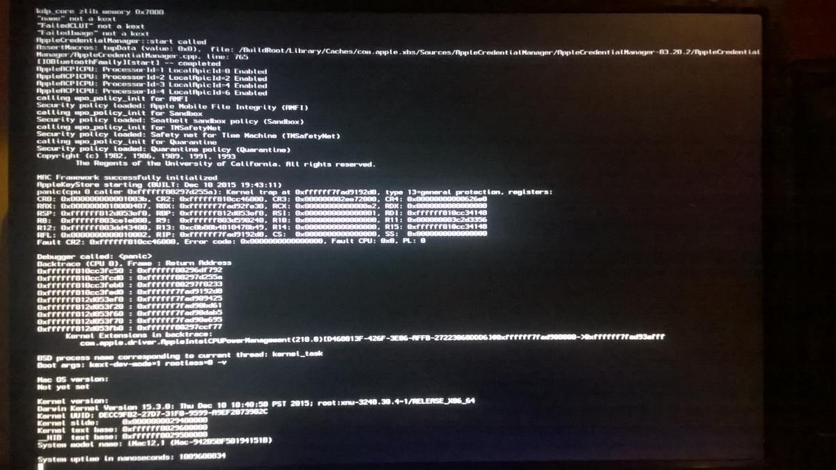

MarcoMax1299 Posted January 26, 2016 Author Share Posted January 26, 2016 Ecco le foto Link to comment Share on other sites More sharing options...
gengik84 Posted January 26, 2016 Share Posted January 26, 2016 Spiegami, scusa...questa è la prova col config del post numero ? Link to comment Share on other sites More sharing options...
MarcoMax1299 Posted January 26, 2016 Author Share Posted January 26, 2016 post #34 + l'aggiunta del kext Link to comment Share on other sites More sharing options...

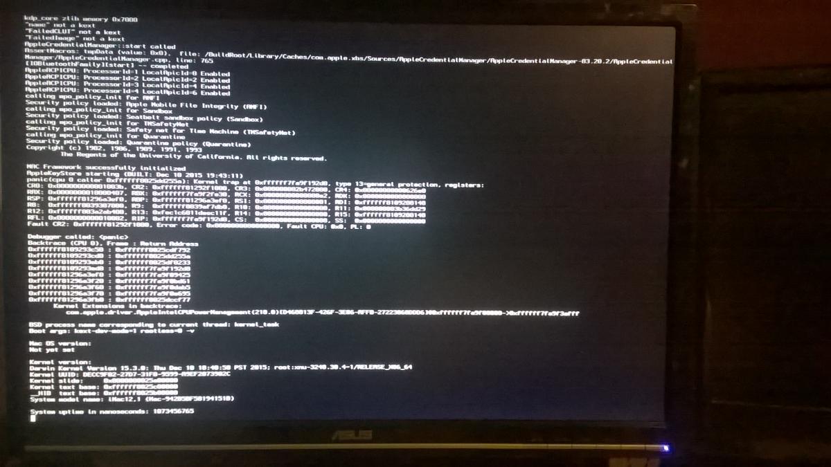

buoo Posted January 26, 2016 Share Posted January 26, 2016 Se continua ad andare in kernel panic vuol dire che NullCPUPowerManagement non viene caricato. Probabilmente non l'hai installato correttamente. 1 Link to comment Share on other sites More sharing options...
gengik84 Posted January 26, 2016 Share Posted January 26, 2016 Sostituisci il config con quello allegato. Elimina nullcpu dalla cartella kext in EFI. Riprova, mi raccomando fai la foto del blocco del verbose. Comprimi e posta la cartella EFI config.plist.zip Link to comment Share on other sites More sharing options...
MarcoMax1299 Posted January 26, 2016 Author Share Posted January 26, 2016 Ok.. ma quello allegato quale ?? quello del post 34 ? Link to comment Share on other sites More sharing options...
gengik84 Posted January 26, 2016 Share Posted January 26, 2016 Ok.. ma quello allegato quale ?? quello del post 34 ? mi ero dimenticato di allegarlo.... Editato post precedente Link to comment Share on other sites More sharing options...
MarcoMax1299 Posted January 26, 2016 Author Share Posted January 26, 2016 A ok ahahah adesso provo Intanto Allego la cartella EFi e provo a fare il boot. Ecco le foto: EFI.zip Link to comment Share on other sites More sharing options...
