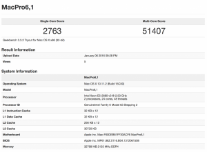

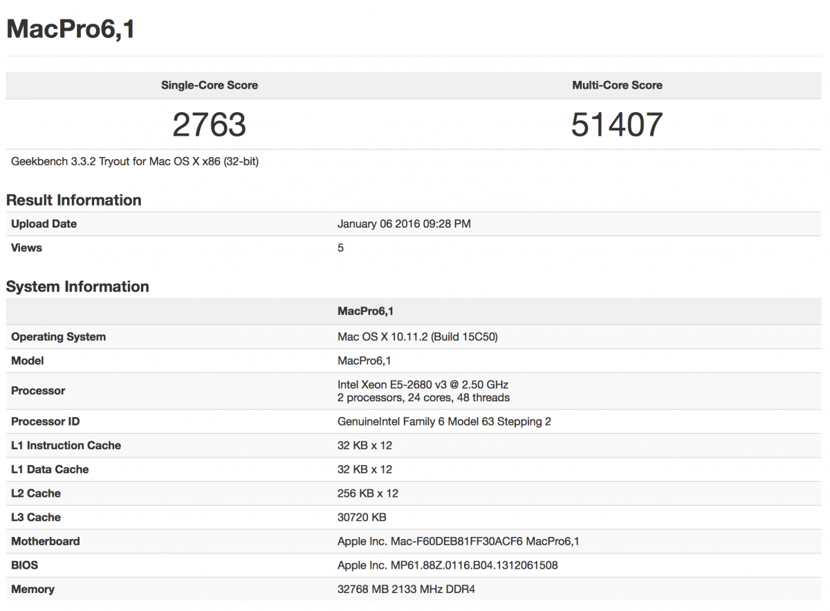

analogo Posted January 10, 2016 Author Share Posted January 10, 2016 Cool Stuff. Wich CPUs are u using Hehe.. Two Xeon E5-2680 v3 CPUs.. Do you have an idea, what I can try? __________________ Edit: Geekbench (32bit).. http://browser.primatelabs.com/geekbench3/4807738 Link to comment Share on other sites More sharing options...
Codinger Posted January 10, 2016 Share Posted January 10, 2016 Hehe.. Two Xeon E5-2680 v3 CPUs.. Do you have an idea, what I can try? __________________ Edit: Geekbench (32bit).. GeekBench.png http://browser.primatelabs.com/geekbench3/4807738 Wtf my score is about 15k Link to comment Share on other sites More sharing options...
