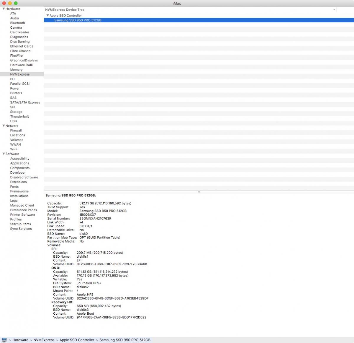

tempel Posted August 1, 2016 Share Posted August 1, 2016 Please explain. WHAT works? I am still using the driver from Macvidcards and while it runs fairly stable to boot and run on 10.11.5 (now even .6), I get kernel panics on every reboot or shutdown. Is there someone who knowns a fix for that? Update: I think it related to the linked article (https://pikeralpha.w...bin-patch-data/). In fact, it now appears to me that latest Clover version does support NVMe right out of the box. Meaning I don't need the NVMeGeneric.kext driver any more. And now the drive appears in the System Profiler under NVMe, which it did not do before. Still getting kernel panics at reboot, though. Link to comment Share on other sites More sharing options...

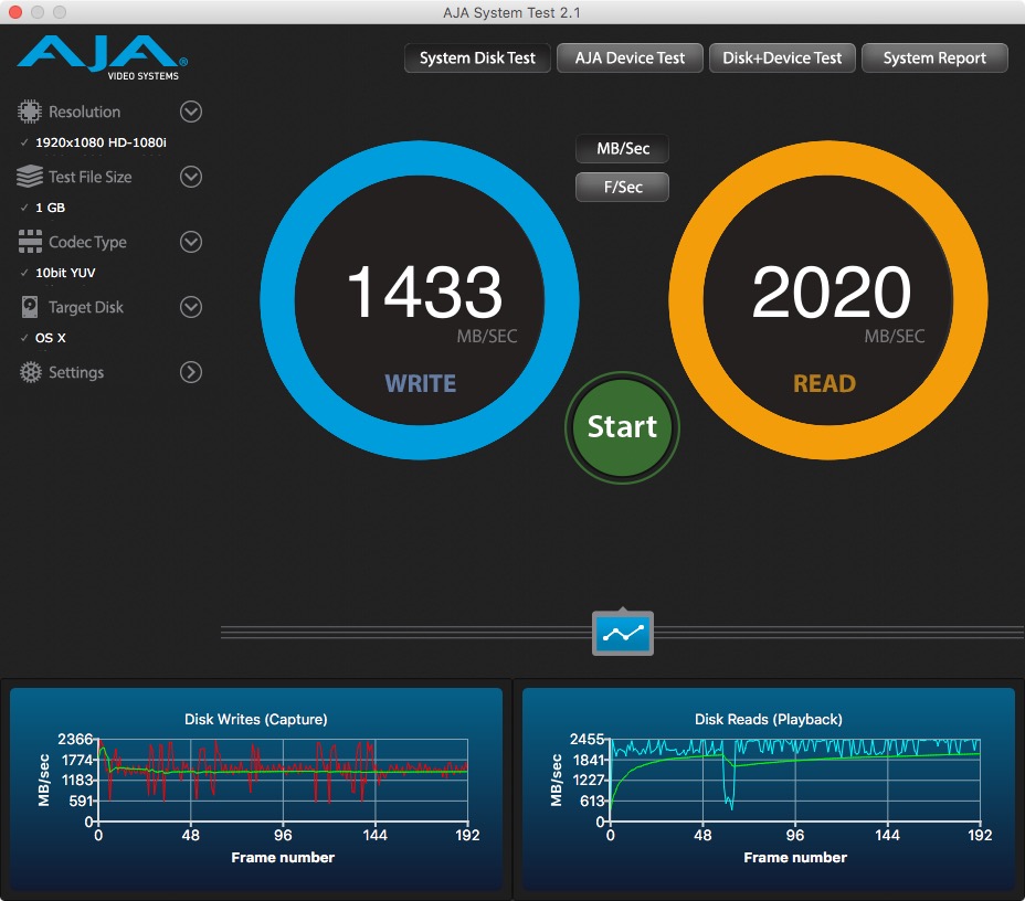

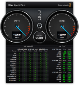

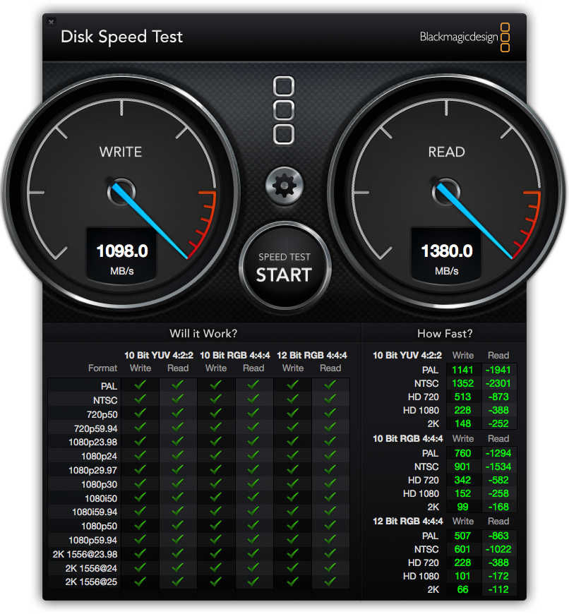

magnifico Posted August 1, 2016 Share Posted August 1, 2016 Please explain. WHAT works? I am still using the driver from Macvidcards and while it runs fairly stable to boot and run on 10.11.5 (now even .6), I get kernel panics on every reboot or shutdown. Is there someone who knowns a fix for that? See you pike solution or rehabman It Works.jpg DiskSpeedTest.png AJATest.jpg It works!! sorry but you were not the first in the world that everything worked? Link to comment Share on other sites More sharing options...
