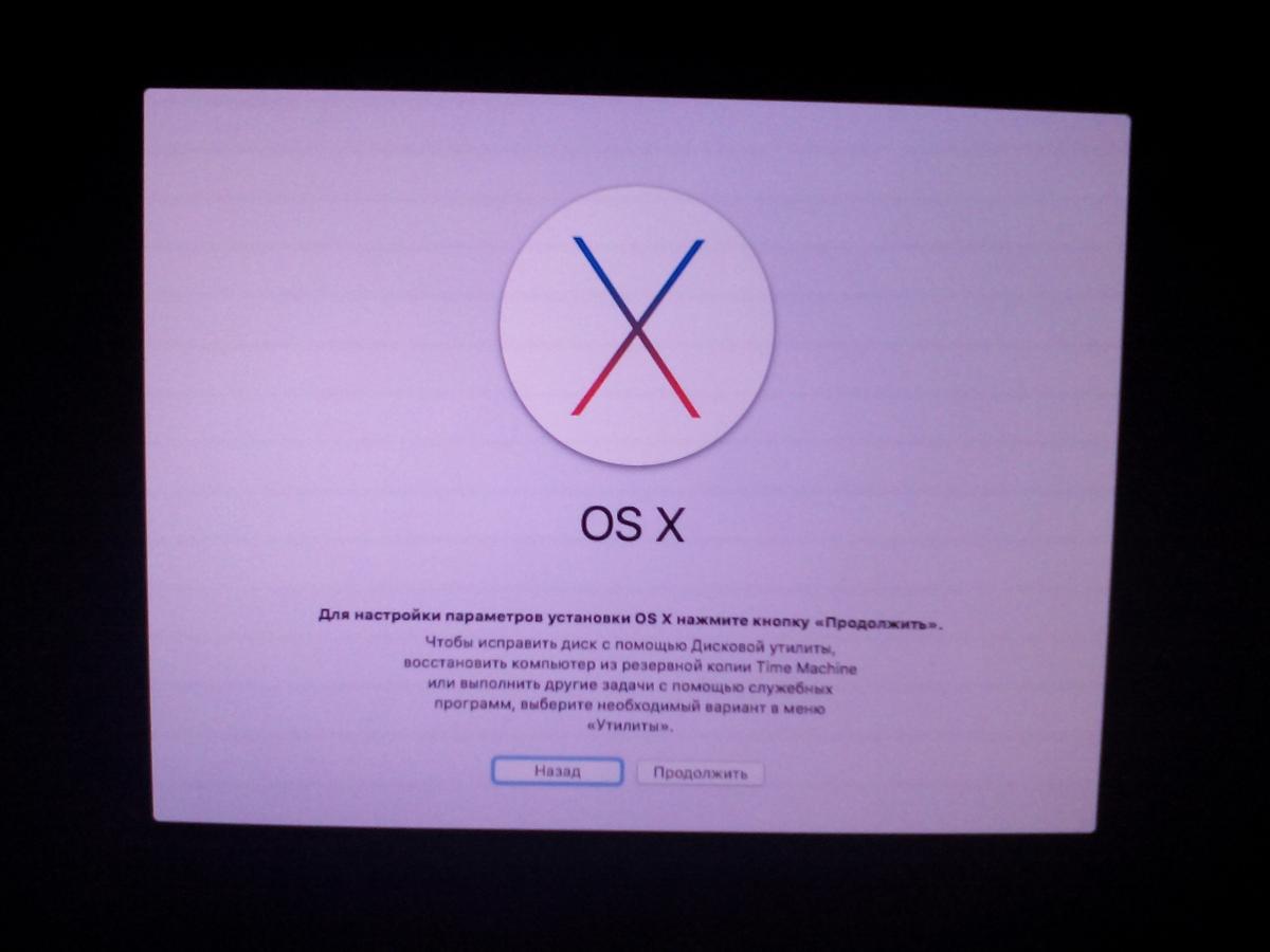

boyriot Posted December 12, 2015 Share Posted December 12, 2015 hi, I'm new to hackintosh. is there any guide to build el capitan usb installer for AMD and using kernel from this topic? found it, will try. Link to comment Share on other sites More sharing options...

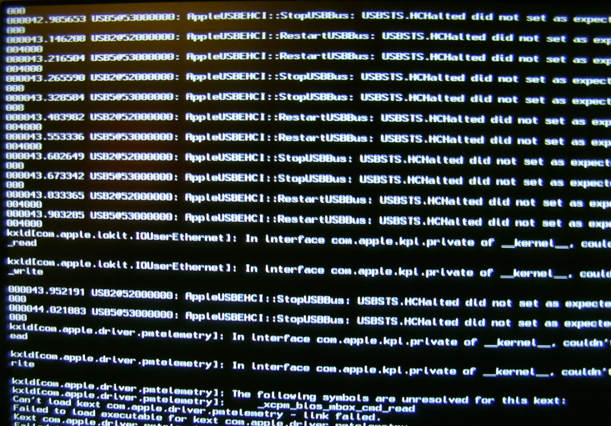

kirillko Posted December 12, 2015 Share Posted December 12, 2015 The problem is really in the usb, try booting with this stick in the other amd pc - with legasy bios problem was similar until disabled usb2,3. This problem is gone, but the installer will not start for 30 minutes hanging on the <Warning> Endpointed through legasy launch (3) APIs. Please switch to XPC or bootstrap_check_in (): com.apple.bsd.dtrhelper p.s. how to make a picture? jpeg does not accept = ( Link to comment Share on other sites More sharing options...

Micky1979 Posted December 12, 2015 Share Posted December 12, 2015 The problem is really in the usb, try booting with this stick in the other amd pc - with legasy bios problem was similar until disabled usb2,3. This problem is gone, but the installer will not start for 30 minutes hanging on the <Warning> Endpointed through legasy launch (3) APIs. Please switch to XPC or bootstrap_check_in (): com.apple.bsd.dtrhelper p.s. how to make a picture? jpeg does not accept = ( It refear to some Apple Helper Tool (com.apple.bsd.dtrhelper), and is a log that say to swicth to an XPC Server instead to use deprecated SMJobBless APIs. No AMD related, and not a problem. Link to comment Share on other sites More sharing options...

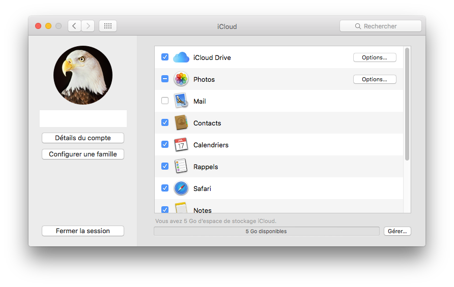

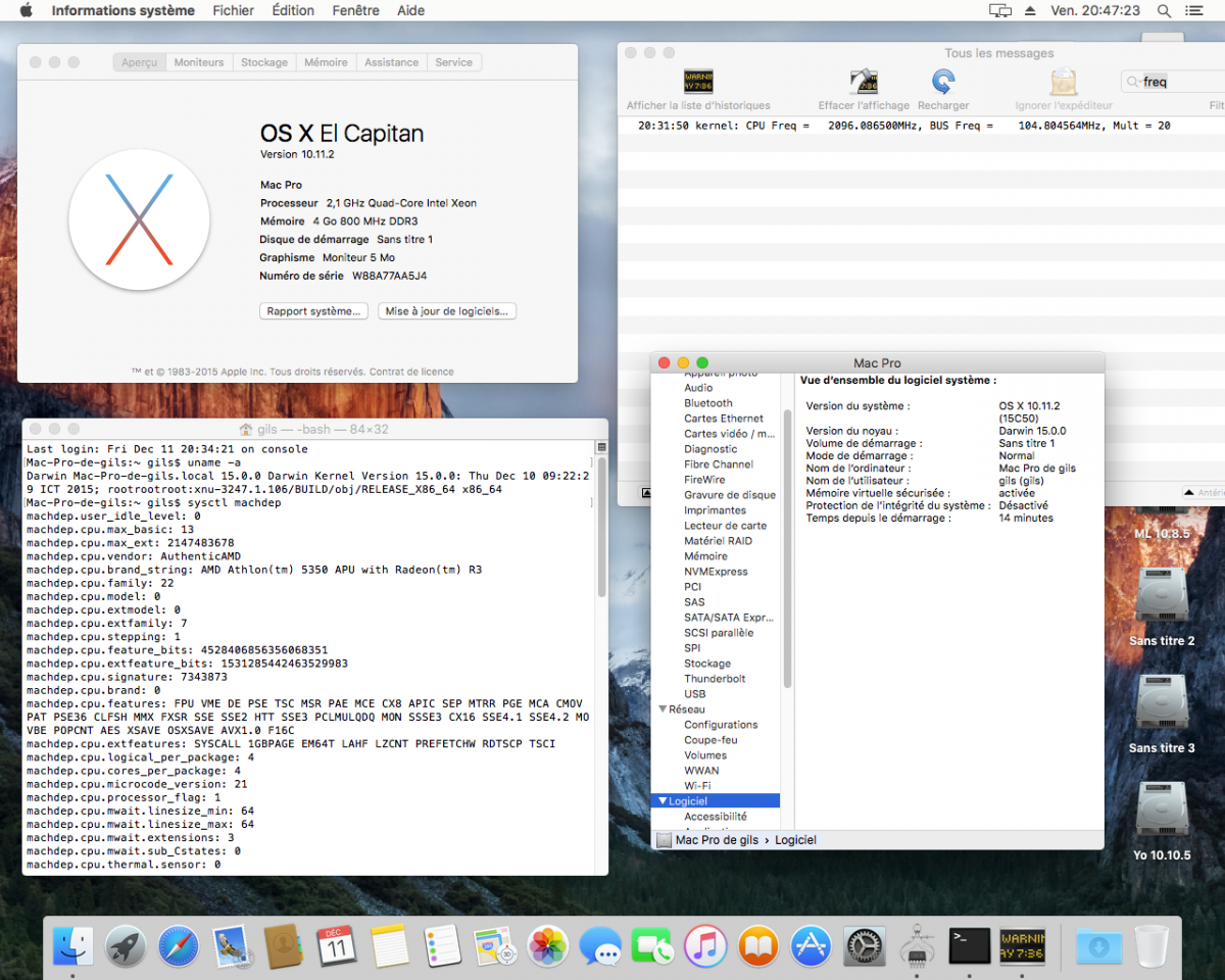

gils83 Posted December 12, 2015 Share Posted December 12, 2015 Phenom /HD 6670 / motherboard no UEFI (GA78lmtusb3) works good but problem USBMassstorage and problem AppleRTC , the video is fluid commmand terminal repair HDD if you please , KP aléatoire iCloud works ootb flag : <key>EthernetBuiltIn</key> <string>Yes</string> <key>AtiConfig</key> <string>Lotus</string> <key>AtiPorts</key> <string>3</string> <key>KernelBooter_kexts</key> <string>Yes</string> <key>KernelPm</key> <string>Yes</string> <key>KernelLapicError</key> <string>Yes</string> <key>KernelLapicVersion</key> <string>No</string> <key>KernelHasswell</key> <string>No</string> <key>KernelcpuFamily</key> <string>No</string> <key>KernelSSE3</key> <string>No</string> <key>Kernel Flags</key> <string>npci=0x2000 GraphicsEnabler=Yes USBLegacyOff=Yes</string> thantks polyzargone and Ermac , use Enoch 2795 edit : repair but the kernel ? iMac-de-gils:~ gils$ sudo /usr/libexec/repair_packages --repair --standard-pkgs --volume / WARNING: Improper use of the sudo command could lead to data loss or the deletion of important system files. Please double-check your typing when using sudo. Type "man sudo" for more information. To proceed, enter your password, or type Ctrl-C to abort. Password: Permissions differ on "Library/Java", should be drwxr-xr-x , they are drwxrwxr-x . Repaired "Library/Java". User differs on "System/Library/Kernels/kernel", should be 0, user is 501. Unable to set owner & group on "System/Library/Kernels/kernel". Error 1: Operation not permitted Unable to set permissions on "System/Library/Kernels/kernel". Error 1: Operation not permitted User differs on "private/var/db/displaypolicyd", should be 0, user is 244. Group differs on "private/var/db/displaypolicyd", should be 0, group is 244. Repaired "private/var/db/displaypolicyd". 3 Link to comment Share on other sites More sharing options...

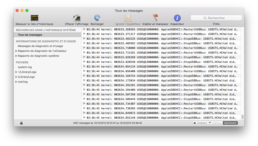

J0hny Posted December 12, 2015 Share Posted December 12, 2015 Guys, unfortunately after the reboot I couldn't boot into the installer. Getting this USB problem every time I try to boot: I have red that and that and no result.(( It's because with AMD motherboard is all different: I've tried to remove ports restriction, also I've tried to figure out how to add ports to DSDT, I even tried to use injector kexts, where I've deleted ports restriction and still no result. I've spent whole day to find the solution. Perhaps I'm doing something wrong, I don't know. Oh and by the way if you want to use clover, then you should install it on EFI partition, otherwise it will not boot! At least I couldn't boot, when I've installed clover in the same partition where installer was. I think I'll get same issue even with chameleon, maybe I'll try it later... If someone know how to solve this, please help.)p.s. It's really strange, I was able to boot once, but then again this thing... 1 Link to comment Share on other sites More sharing options...

gils83 Posted December 12, 2015 Share Posted December 12, 2015 @Gills there is no need to repair the kernel permission because is loaded by the bootloader when root is not existing yet...so no matter euh ?? repair permission of El Capitan , the kernel works but très mal , AppleRTC patched no works (clearcmos atfer reboot) , voodooPState no works (kp) + UEFI motherboard AMD no works Link to comment Share on other sites More sharing options...
