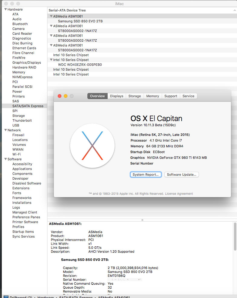

Andres ZeroCross: Just noticed in your image files you have Intel 10 SATA/Express showing.
Update: Intel 10 Series does indeed work in the G1 Gaming mobo. Stupid cable problem!

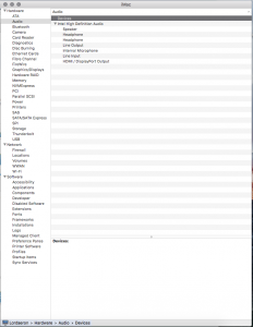

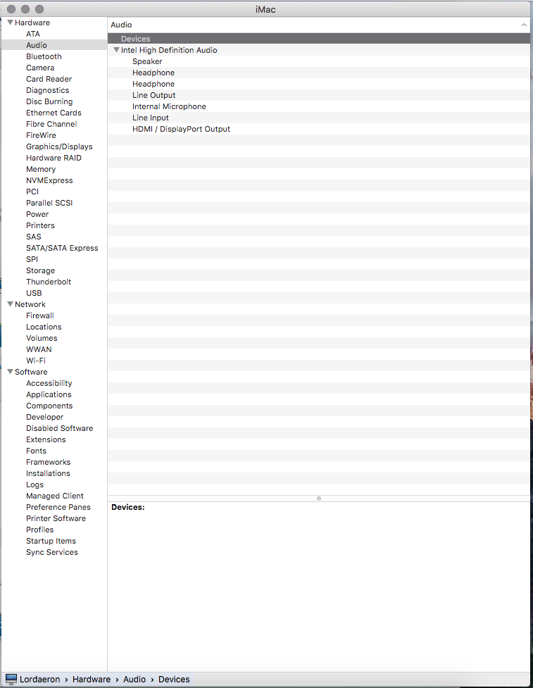

I think I made a mistake somewhere.  I installed the AppleHDA.kext to S/L/E and added the replaced the others in my CLOVER/Kexts folder as you said to do.  I can see the hardware in the system profiler, but nothing is in my Audio settings.  I am currently repairing permissions again and clearing caches manually.  Will see what happens after next reboot.
Thanks again for your time and assistance!
You need to use DSDT too,,, i have modified your DSDT. Try to use it. Put it at EFI/CLOVER/ACPI/Patched
I am using the DSDT you enclosed.  I had it loading at one point but it stopped.  I am checking extensions folder to assure voodoo and others are gone.
Can you uploade image of Verbose log?? I want to see it
Another way is you need to tick "Fix HDA" because default device audio at SkyLake is HDAS, and we need to change it to HDEF so tick "Fix HDA", then you need to DROP OEM DSM of HDA because if you want to set Layout ID "2" at config.plist, first you must remove OEM DSM of your HDAS/HDEF.
Try it

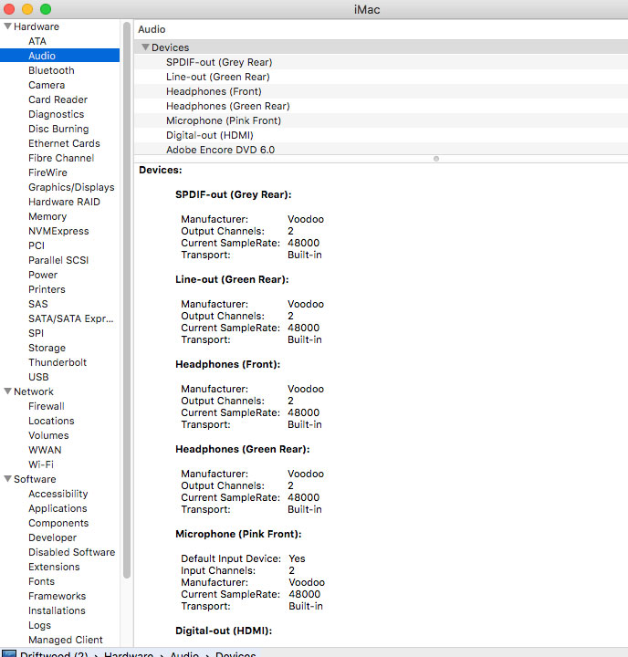

post-826544-0-92396500-1450638054_thumb.jpgpost-826544-0-87859200-1450638088_thumb.jpg
Andres's Creative setup works in my Gaming G1 Profile too. Just need to sort out my dsdt like above.
