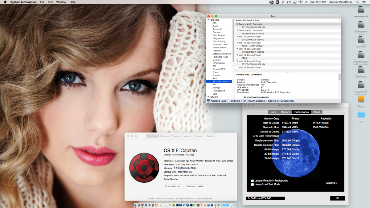

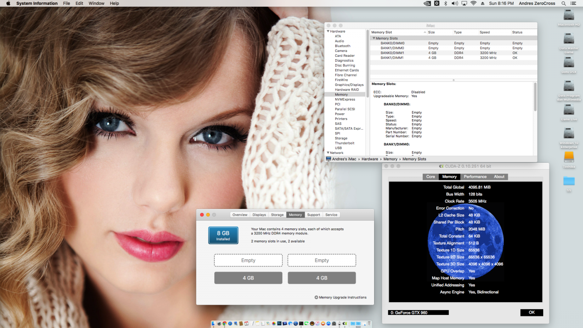

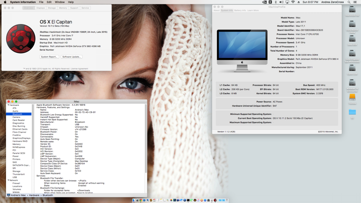

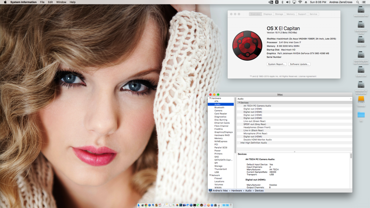

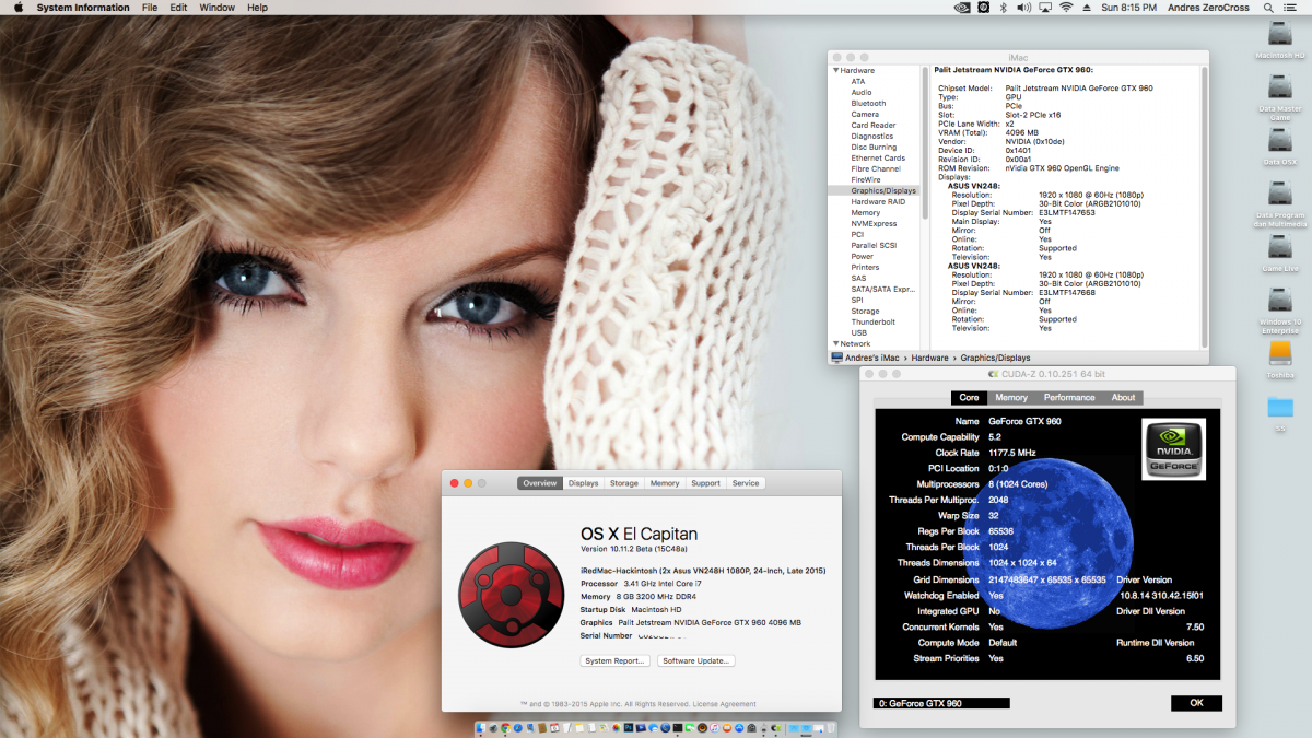

Andres ZeroCross Posted December 6, 2015 Share Posted December 6, 2015 Hi Guys, i upgraded my motherboard from Z170-HD3 to Z170X-Gaming 7 System Specifications : Processor : Intel Core i7 6700 SkyLake Motherboard : Gigabyte Z170X - Gaming 7 (I need more onboard Sata Ports) VGA : Palit Jetstream GTX960 4GB DDR5 Memory : Dual Channel Team Extreem Dark 8GB (2x4GB) DDR4 3000Mhz OC Storages : 6 Storages (120GB SSD Natno For Windows 10 Enterprise, 120GB Fujitsu for OS X El Capitan, 2TB For Data Multimedia / Program, 2TB for Master Game Installer, 500GB For Data OS X, 500GB for Game Live Installed) Optical Drive : Asus DVD-RW Box LAN : Dual LAN - Killer LAN E2400 dan Intel I219V Wifi Card : TP-Link TL-WDN4800 Camera : A4Tech PK-920H WebCam Monitor : 2X Asus VN248H @24" Full HD Supported Audio Codec : Creative CA0132Clover version : 3330OS X Version : El Capitan 10.11.2 Beta Build 15C48aBoot Mode : UEFI with CSM Disabled Working : 1. QE/CI Full Support with Nvdia 2. Camera Webcam OOB 3. Sleep, Restart, Shutdown 4. I use Voodoo HDA version 2.8.8 for my Creative CA0132 5. HDMI Audio from Nvidia Card 6. Power Management, Multiplier dan Turbo Boost with SSDTPrGen from Pike R. Alpha 7. iMessages (Inject MLB and ROM from Real MacBookPro) 8. LAN Killer E2400 9. Etc Not Working : 1. Can'nt use AppleHDA Update : we can use AppleHDA for Creative CA0132. See here http://www.insanelymac.com/forum/topic/309441-new-applehda-patcher/?p=2194865 2. Not supported Ethernet I219V yet Work with new kext see here http://www.insanelymac.com/forum/topic/205771-appleintele1000ekext-for-108107106105/page-38?do=findComment&comment=2195842credit to @alreadystarted 3. Intel HD 7000 Integrated4. Super Speed USB 3.0 not function at 10.11.2 Beta version. But, with 10.11.1 Public releas it's working nicely. Bug i thought. Update : with 10.11.2 Build 15C50 all USB are Working, use my "Z170X-Gaming-7-USB3.0-Injection.kext" and SMBios 17.1 Credit to Rehabman I just need to flash bios into beta version then Go to BIOS Setup and "disable IOAPIC Entry" , then dumping your DSDT with Clover and check about all of your XHC device port and make USBInjection.kext from Clover This is my Files1. This is for Z170X-Gaming 7 + Palit Jetstream Nvidia GTX960 + TL-WDN4800. So if your system build is not same to my sytem then you need to modify DSDT File. Click>>Z170X-Gaming 7 Conifguration Tested by Me<<< to download files 2. Universal Setting Clover. Try to use this one if you have different Graphics Card, Processor and PCI-E Device. If you want to use Integrated Graphics and Discrette Graphics Card then set into BIOS for Primary Graphics from IGFX then just boot and it should active your integrated first and discrette graphics output few later. If you just want to boot with Discrette Graphics then set at bios primary graphics is PCI-E. Click>>>General Setting Without Graphic Injection for Z170X-Gaming 7<< to download files 3. AppleHDA Creative CA0132 Work without Volume Control. Click >>AppleHDA Files<< to download files. After extract you will get Creative-CA0132.kext, Layout1.zml.zlib, Platform.zml.zlib and Patch-OTF.plist. Tutorial for AppleHDA (First you need to remove VooDooHDA.kext + HDADisabler.kext + HDAEnabler.kext if you used it before) 3a. LayoutID has been set "1" with DSDT. So you don't need to set it again with HDAEnabler or Clover Injection. 3b. Extract the files and you will find "Creative-CA0132.kext" copy this to EFI/CLOVER/Kexts/10.11 3c. Open your config.plist with Clover Configurator and add this to "Kernel and Kext Patches->KextToPatch" section (you can see this patch at "Patch-OTF.plist") Name : AppleHDA Find : 786d6c2e7a6c Replace : 7a6d6c2e7a6c Comment : Change Path XML to ZML Name : AppleHDA Find : 0088ec1a Replace : 11000211 Comment : Rename Codec 1 Name : AppleHDA Find : 7419ad15 Replace : 00000000 Comment : Reset Codec 3d. Copy your original AppleHDA.kext from System/Library/Extensions to Desktop. Then copy "layout1.zml.zlib" and "Platform.zml.zlib" to this kext with path "AppleHDA.kext/Contents/Resources". And reinstall the kext with Kext Utility. . Credit to Wern Apfel, Mirone and Abxite for XML to ZML method Special Note : If you have already use my DSDT and Config.plist then you can skip step 3a. 3b and 3c Another Screenshots 3 Link to comment Share on other sites More sharing options...
beatles4 Posted December 6, 2015 Share Posted December 6, 2015 This is very interesting. I want to keep tabs on how well this works. Does audio not work from the creative card or is that working well now? Link to comment Share on other sites More sharing options...

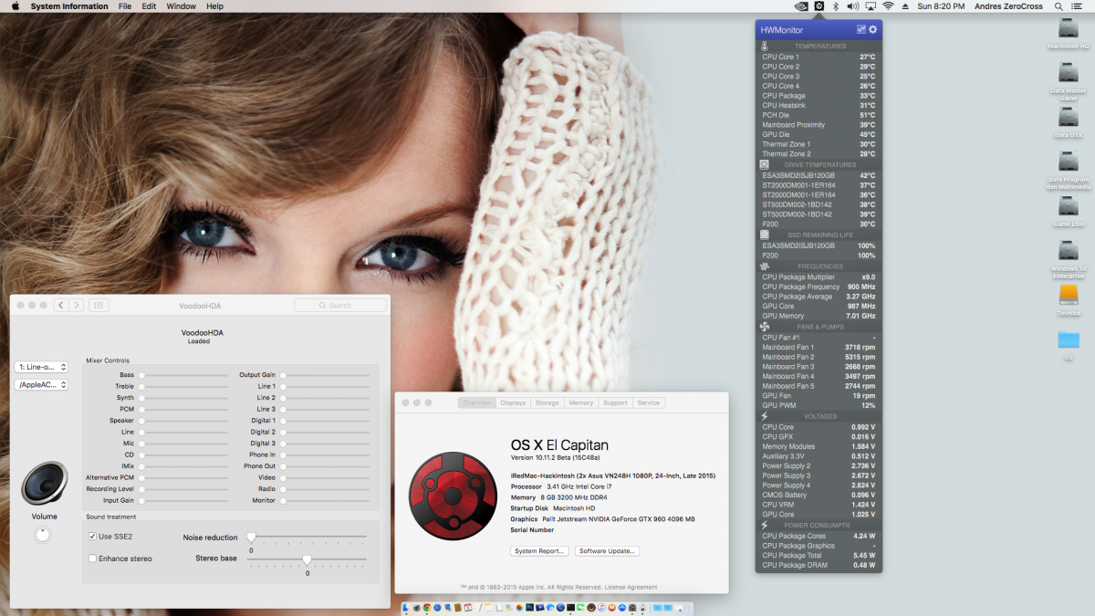

Andres ZeroCross Posted December 7, 2015 Author Share Posted December 7, 2015 Nope, still use VooDooHDA rev 2.8.8 But sound is still good with limit 2.1 channel audio Link to comment Share on other sites More sharing options...

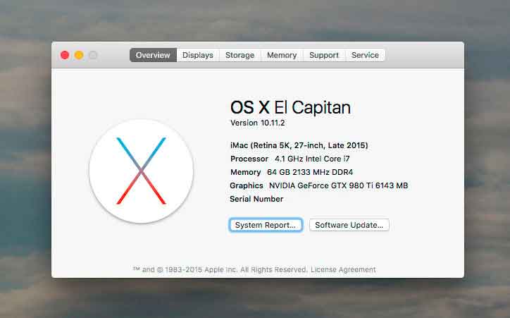

driftwood Posted December 9, 2015 Share Posted December 9, 2015 [success] El Cap 10.11.2 on Gigabyte z170 Gaming G1 / i7 6700k \64Gb RAM / NVIDIA GeForce GTX 980 Ti 6143 MB All pretty cool so far. Both Killer network nics work with Atheros2200\2400 Meinze's kext. Most USBs work / switched some off at boot so yet to try all Attempting to see if Killer WIFI AC1535 will work (could've sworn I noticed this was working earlier...) Attempting to see if I can get the m.2 samsung PCIe x4 NVME 500Gb card working Will take a look at getting Creative 3D Sound {censored} working too Link to comment Share on other sites More sharing options...

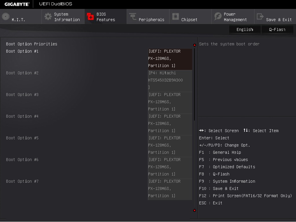

@hackintosh@ Posted December 10, 2015 Share Posted December 10, 2015 Here there is an error. When creating boot by usb so on El Capitan is okay, but when installed on ssd clover 3330 to launch in El Capitan is in the bios boot options appear more 1 again and so continuously accumulated for the next boot time follow. I can fix it? Link to comment Share on other sites More sharing options...
