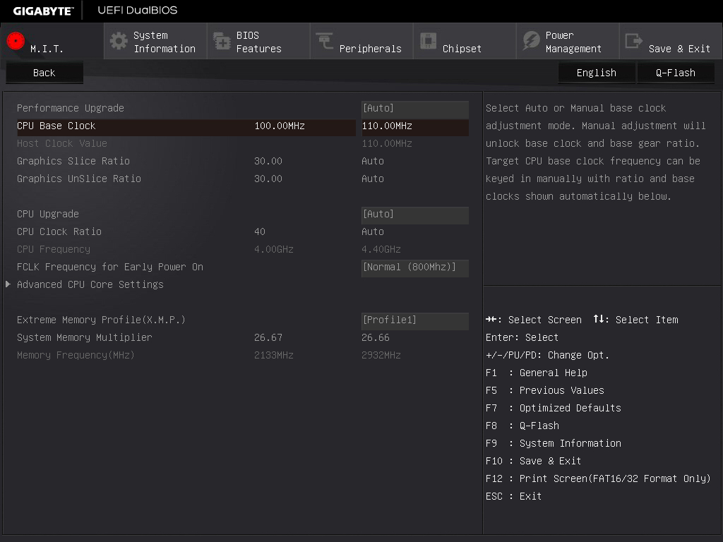

Cyberdevs Posted February 29, 2016 Author Share Posted February 29, 2016 I changed the BCLK value from 100 to 110 and system gave me few beeps and shut down, but after recovering from the first crash it cam back on, I checked the BIOS settings and the setting were saved and OS X booted normally with a boost and CineBecnch showed me better performance. I just don't know what happened the first time exactly but I guess because I already activated XMP with 26.6 caused the system to overwhelm the RAM frequency. 1 Link to comment Share on other sites More sharing options...

Rajesh_Pandey Posted February 29, 2016 Share Posted February 29, 2016 I changed the BCLK value from 100 to 110 and system gave me few beeps and shut down, but after recovering from the first crash it cam back on, I checked the BIOS settings and the setting were saved and OS X booted normally with a boost and CineBecnch showed me better performance. I just don't know what happened the first time exactly but I guess because I already activated XMP with 26.6 caused the system to overwhelm the RAM frequency. Thanks! I don't think there is anything left to try now. Hopefully, this issue will be fixed once Apple releases more Skylake powered Macs Link to comment Share on other sites More sharing options...
Cyberdevs Posted February 29, 2016 Author Share Posted February 29, 2016 You're welcome I afraid so, but you can send me some screenshots of you BIOS so I can see what's what and see if we can get passed this issue. Link to comment Share on other sites More sharing options...
