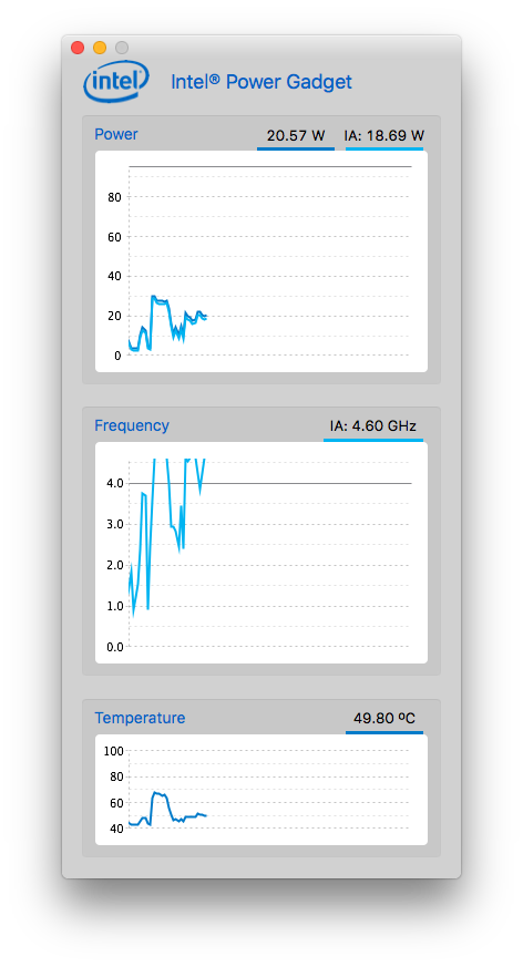

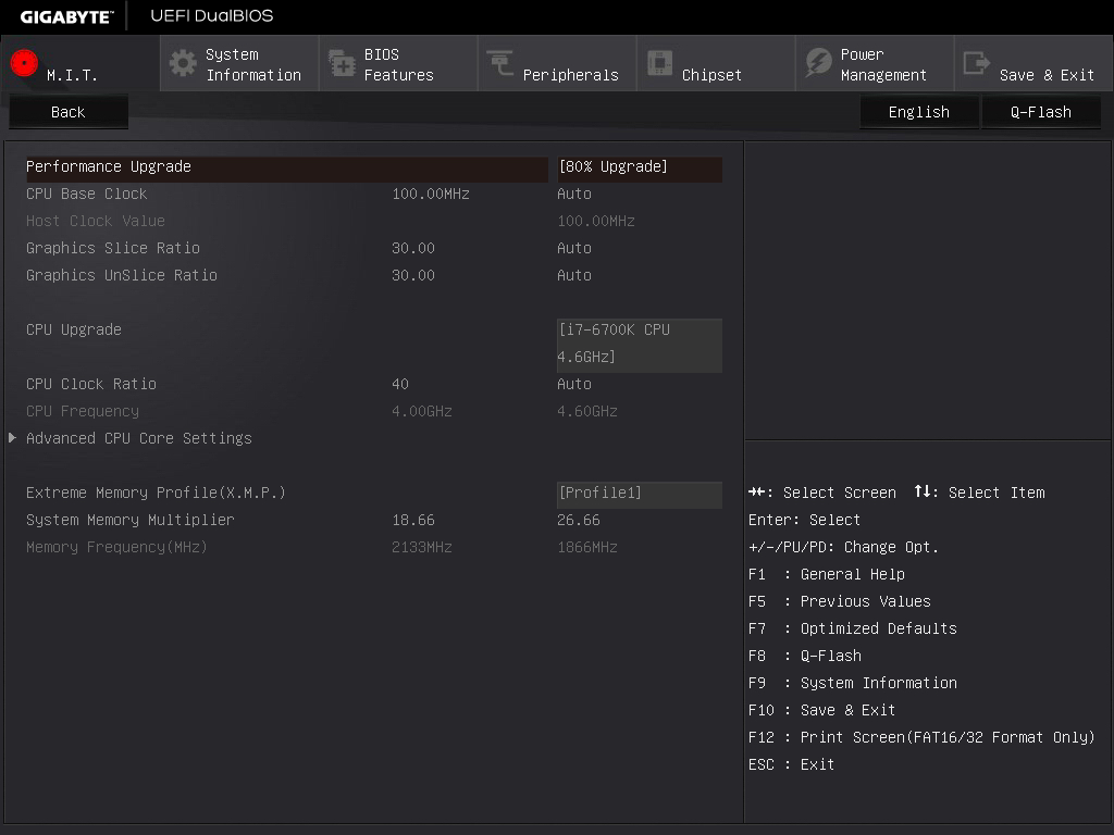

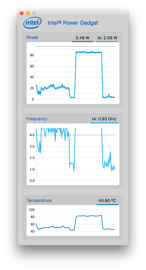

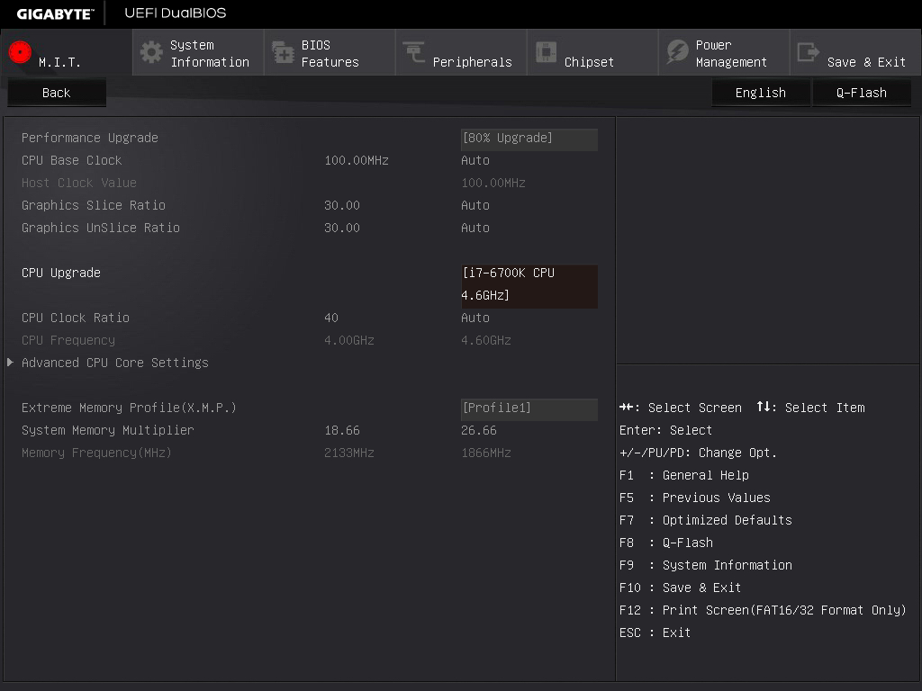

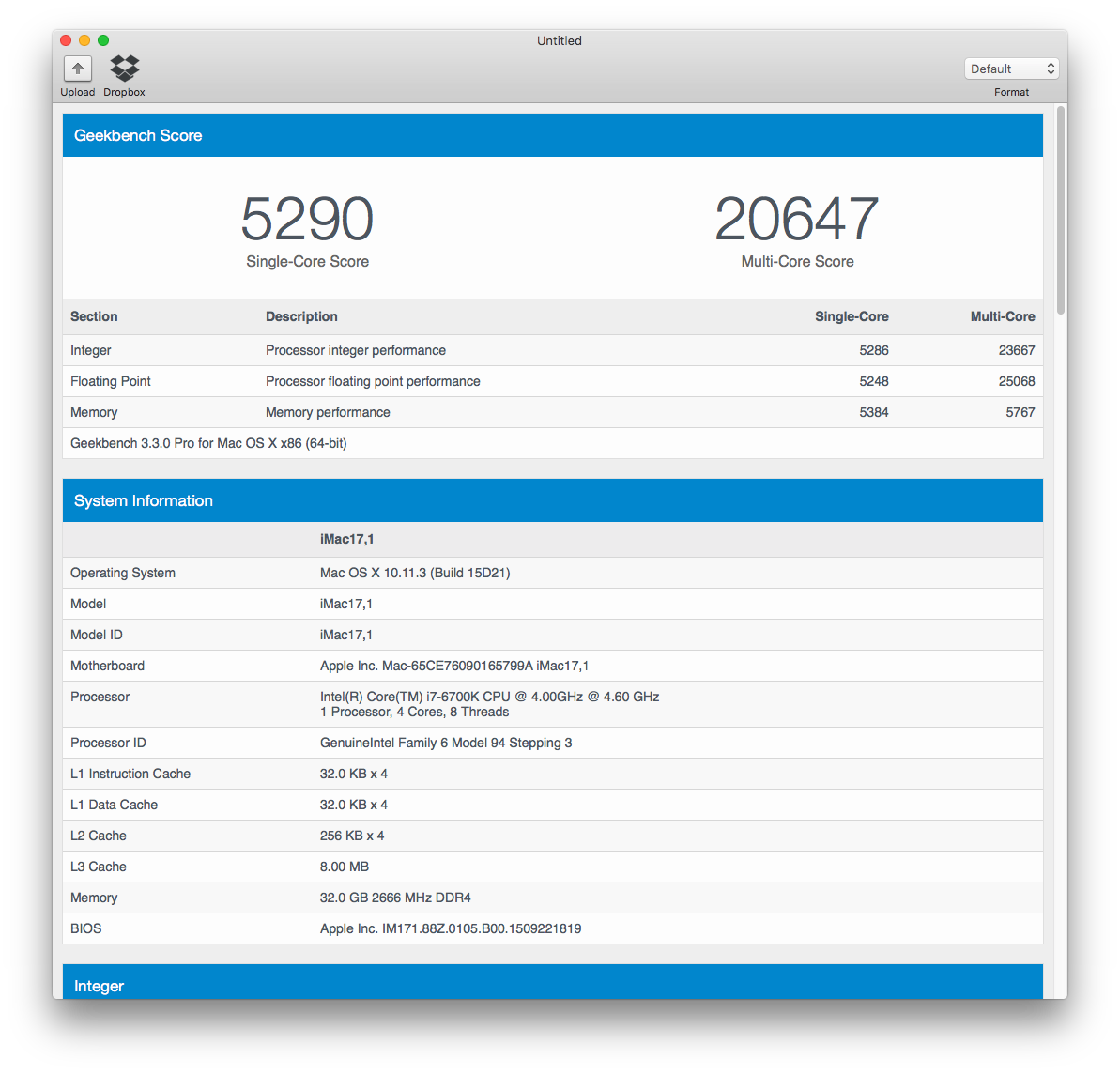

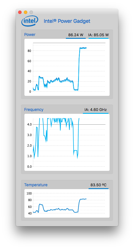

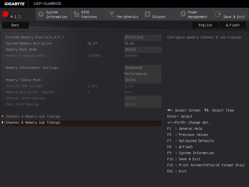

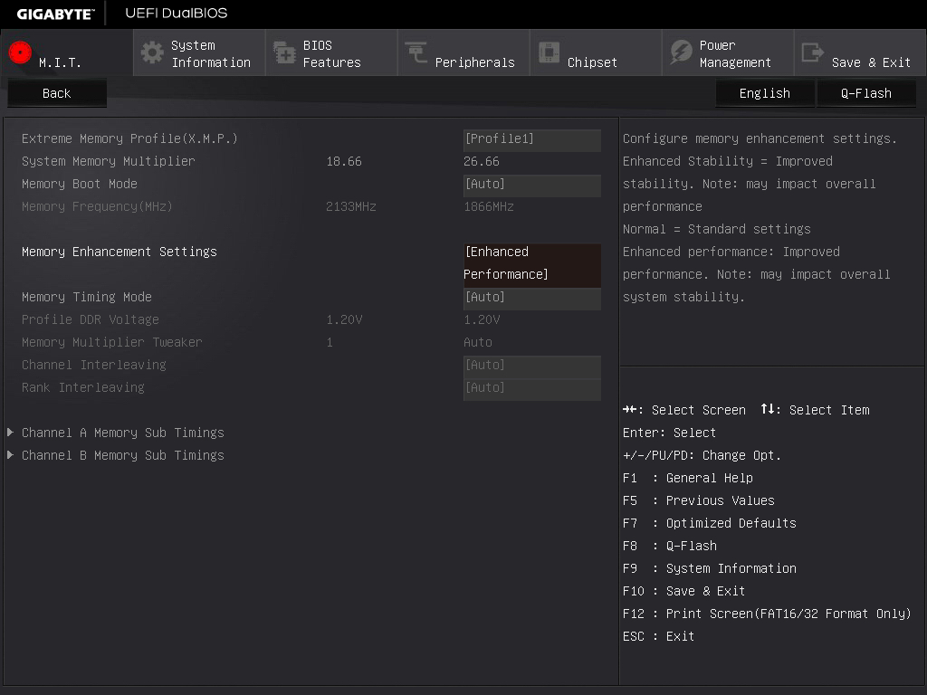

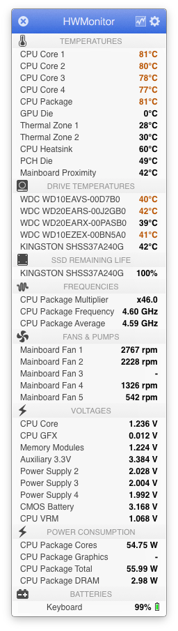

Cyberdevs Posted January 21, 2016 Author Share Posted January 21, 2016 Updated to OS X 10.11.3 successfully. Are you guys able to control the FAN/RPM speed using HWMonitor? @cyberdevs how do I get you logs? Just have an itch to OC my 6500 to 3.6GHz or higher. Hey Rajesh, Nice work on the article, I was wondering what kind of logs you were referring in you earlier post. About Over Clocking the CPU here is the settings in the BIOS you might wanna check. See the attachments. I OCed my CPU up to 4.6 GHz and it's working just fine although the CPU temperature is increased noticeably specially with CineBench up to 85 degrees. Unless you have a solid cooling system I won't recommend over clocking the CPU. If I assume correctly from the picture you uploaded to iphonehacks you are using Intel's cooling unit which is good for day to day usage but if you are insisting on over clocking your CPU to 3.6 GHz you've got to buy a better closing unit and If I assumed correctly about the fan, maybe the freezing you are experiencing is because of that your cpu overheats and as the result it goes into halt state. I use CoolerMaster Neptune 120XL which is a decent CPU liquid cooling unit and the next in line is Cooler Master Neptune 240M and the best one is Cooler Master Neptune 280L liquid cooler. These are the benchmarks and SpeedStep tests. Link to comment Share on other sites More sharing options...
Cyberdevs Posted January 21, 2016 Author Share Posted January 21, 2016 Here is some tips on how to overclock the CPU and Memory: 1. In BIOS from M.I.T choose Advanced Memory Settings I. From Extreme Memory Profile(X.M.P.) Choose [Profile1] it's crucial to choose this option if you want your memory modules work with their full frequency. II. Enter the correct System Memory Multiplier which in your case based on 2400MHz DDR4 must be 24.0 III. Select [Enhanced Performance] from Memory Enhancement Settings. You can choose any of the option or just to on the safe side choose Enhanced Stability IV. F Advanced Frequency Settings choose Performance Upgrade and select your desired value I recommend 20 to 40% Upgrade V. From CPU Upgrade choose your desired speed which is recommended not to go higher that 3.6 GHz because Core i5 6500 can be Over Clocked up to 3.6 VI. Save your new settings and reboot. 2. Once you booted successfully into your system, open your config.plist with Clover Configurator and edit the following settings; although it might be better to edit these settings before changing you BIOS’s settings: I. From “Boot” section select your XMPDetection profile. II From “CPU” edit you new processing speed which must be 3600 MHz in your case. III. Save your config.plist and reboot The last step should fix any misreading of processor’s speed by system profiler. Good Luck. 1 Link to comment Share on other sites More sharing options...
Rajesh_Pandey Posted January 23, 2016 Share Posted January 23, 2016 @cyberdevs: The problem is that after OCing, OS X stops booting. I have successfully booted into Windows 10 with my 3.6GHz OC and tested it for stability using various stress tests. I am using the stock cooler for now, but its winter here and even under full load after 20 mins, the CPU temp does not cross 55C. I do plan on buying a CoolerMaster Hyper 212X by the time summer arrives. P.S. I had to overclock my CPU by increasing the BCLK frequency from 100Mhz since the Core i5-6500 does not come with an unlocked multiplier. Nothing really to do with my problem, but just something I thought you should know. Link to comment Share on other sites More sharing options...

Cyberdevs Posted January 27, 2016 Author Share Posted January 27, 2016 @Rajesh_Pandey You have to right click on your FakeSMC.kext and select show package content, then under contents create a folder called "Plugins" and put these four files under "Plugins": 1.ACPISensor.kext 2.CPUSensors.kext 3.GPUSensors.kext 4.LPCSensors.kext If you don't want to use those sensors you've got to delete them completely or move them to another place other than your EFI folder just to make sure. Link to comment Share on other sites More sharing options...
