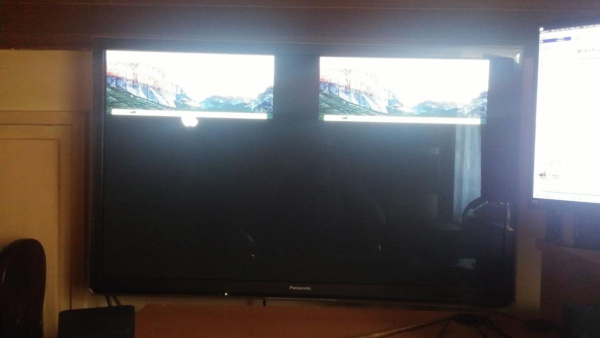

mwkemo Posted October 20, 2016 Share Posted October 20, 2016 After three frustrating days trying to make functional UEFI QEMU OSX El Capitan installation, I'm here to ask for help. I managed to install Clover and boot from QEMU but after booting comes this weird issue where i'm presented with two OSX screens on one monitor(you can see what I'm talking about in attached file). I tried with different Clover options(different patches, changing resolution, SMBIOS changes) and QEMU options(tried different cpu models, three OVMF.fd files, removing x-vga=on...) and this is the closest I could come to a functional QEMU OSX. I should point out that OSX is working as expected when I disable OVMF and enable old BIOS booting style within QEMU. My System: Intel 4790K Nvidia GTX460(using in linux) Nvidia GTX960(using for VGA passthrough) Runing Arch linux with 4.7.6-1 kernel My QEMU flags: args="-enable-kvm \ -cpu core2duo,kvm=off,vendor=GenuineIntel \ -smp sockets=1,cores=4,threads=2 \ -M q35 \ -m 8192 \ -vga none \ -smbios type=2 \ -device isa-applesmc,osk=MY APPLE KEY \ -monitor telnet:localhost:7101,server,nowait \ -usb \ -netdev bridge,br=br0,id=mynet \ -device e1000-82545em,netdev=mynet \ -device ide-hd,bus=ide.0,drive=hdd \ -drive file=/opt/osx/OVMF-pure-efi.fd,format=raw,if=pflash \ -drive id=hdd,if=none,format=raw,cache=none,file=/opt/osx/el_capitan.img \ -device ioh3420,bus=pcie.0,addr=1c.0,multifunction=on,port=1,chassis=1,id=root \ -device vfio-pci,host=01:00.0,bus=root,addr=00.0,multifunction=on \ -device vfio-pci,host=01:00.1,bus=root,addr=00.1" I would really appreciated any kind of help. Thanks in advance. Link to comment Share on other sites More sharing options...
macoxp4 Posted October 20, 2016 Share Posted October 20, 2016 Try removing Monitor telnet. What is that? Also add -vga none to make sure that it does not try to create a virtual gpu/monitor. You said it works correctly with Seabios? You are using nvidia web driver? What do you have in your clover conf? also what drivers are in your clover folder and kexts in your clover folder? After three frustrating days trying to make functional UEFI QEMU OSX El Capitan installation, I'm here to ask for help. I managed to install Clover and boot from QEMU but after booting comes this weird issue where i'm presented with two OSX screens on one monitor(you can see what I'm talking about in attached file). I tried with different Clover options(different patches, changing resolution, SMBIOS changes) and QEMU options(tried different cpu models, three OVMF.fd files, removing x-vga=on...) and this is the closest I could come to a functional QEMU OSX. I should point out that OSX is working as expected when I disable OVMF and enable old BIOS booting style within QEMU. My System: Intel 4790K Nvidia GTX460(using in linux) Nvidia GTX960(using for VGA passthrough) Runing Arch linux with 4.7.6-1 kernel My QEMU flags: args="-enable-kvm \ -cpu core2duo,kvm=off,vendor=GenuineIntel \ -smp sockets=1,cores=4,threads=2 \ -M q35 \ -m 8192 \ -vga none \ -smbios type=2 \ -device isa-applesmc,osk=MY APPLE KEY \ -monitor telnet:localhost:7101,server,nowait \ -usb \ -netdev bridge,br=br0,id=mynet \ -device e1000-82545em,netdev=mynet \ -device ide-hd,bus=ide.0,drive=hdd \ -drive file=/opt/osx/OVMF-pure-efi.fd,format=raw,if=pflash \ -drive id=hdd,if=none,format=raw,cache=none,file=/opt/osx/el_capitan.img \ -device ioh3420,bus=pcie.0,addr=1c.0,multifunction=on,port=1,chassis=1,id=root \ -device vfio-pci,host=01:00.0,bus=root,addr=00.0,multifunction=on \ -device vfio-pci,host=01:00.1,bus=root,addr=00.1" I would really appreciated any kind of help. Thanks in advance. Link to comment Share on other sites More sharing options...
mwkemo Posted October 20, 2016 Share Posted October 20, 2016 Try removing Monitor telnet. What is that? Also add -vga none to make sure that it does not try to create a virtual gpu/monitor. You said it works correctly with Seabios? You are using nvidia web driver? What do you have in your clover conf? also what drivers are in your clover folder and kexts in your clover folder? -monitor telnet is for managing virtualized system over shell via telnet protocol. I'm using it to send a poweroff signal to shutdown the OSX via shell. You can do some cool manipulation over telnet via -monitor. I have tried to remove this line but this did not fix the issue. -vga none is always active and this also is not a problem You are right, OSX is booting and showing correctly with Seabios. Nvidia web drivers are installed and working. In UEFI mod I tried booting with nv_disable=1 and this also did not fix the problem. My config.plist: <?xml version="1.0" encoding="UTF-8"?> <!DOCTYPE plist PUBLIC "-//Apple//DTD PLIST 1.0//EN" "http://www.apple.com/DTDs/PropertyList-1.0.dtd"> <plist version="1.0"> <dict> <key>ACPI</key> <dict> <key>DSDT</key> <dict> <key>Debug</key> <true/> <key>DropOEM_DSM</key> <false/> <key>Fixes</key> <dict> <key>AddPNLF_1000000</key> <true/> <key>DeleteUnused_400000</key> <true/> <key>FIX_ACST_4000000</key> <true/> <key>FIX_ADP1_800000</key> <true/> <key>FIX_RTC_20000</key> <true/> <key>FIX_S3D_2000000</key> <true/> <key>FixRegions_10000000</key> <true/> <key>FixSBUS_0080</key> <true/> <key>NewWay_80000000</key> <true/> </dict> <key>Name</key> <string>q35-acpi-dsdt.aml</string> <key>ReuseFFFF</key> <false/> </dict> <key>DropTables</key> <array> <dict> <key>Signature</key> <string>SSDT</string> <key>TableId</key> <string>Cpu0Ist</string> </dict> <dict> <key>Signature</key> <string>SSDT</string> <key>TableId</key> <string>CpuPm</string> </dict> <dict> <key>Signature</key> <string>DMAR</string> </dict> </array> <key>SSDT</key> <dict> <key>DropOem</key> <false/> <key>Generate</key> <false/> <key>MaxMultiplier</key> <integer>40</integer> <key>MinMultiplier</key> <integer>40</integer> </dict> </dict> <key>Boot</key> <dict> <key>Arguments</key> <string>nv_disable=1 kext-dev-mode=1 rootless=0</string> <key>Debug</key> <false/> <key>DefaultLoader</key> <string>boot.efi</string> <key>DefaultVolume</key> <string>OS X</string> <key>Legacy</key> <string>PBR</string> <key>Secure</key> <false/> <key>Timeout</key> <integer>5</integer> <key>XMPDetection</key> <string>Yes</string> </dict> <key>CPU</key> <dict> <key>BusSpeedkHz</key> <integer>1000000</integer> <key>QEMU</key> <true/> <key>UseARTFrequency</key> <false/> </dict> <key>Devices</key> <dict> <key>USB</key> <dict> <key>FixOwnership</key> <false/> <key>Inject</key> <false/> </dict> </dict> <key>GUI</key> <dict> <key>Language</key> <string>en:0</string> <key>Mouse</key> <dict> <key>DoubleClick</key> <integer>500</integer> <key>Enabled</key> <false/> <key>Mirror</key> <false/> <key>Speed</key> <integer>8</integer> </dict> <key>Scan</key> <true/> <key>ScreenResolution</key> <string>1600x900</string> <key>Theme</key> <string>bootcamp</string> </dict> <key>Graphics</key> <dict> <key>DualLink</key> <integer>0</integer> <key>Inject</key> <dict> <key>ATI</key> <false/> <key>Intel</key> <false/> <key>NVidia</key> <true/> </dict> <key>NvidiaSingle</key> <false/> </dict> <key>KernelAndKextPatches</key> <dict> <key>AppleRTC</key> <false/> <key>AsusAICPUPM</key> <false/> <key>Debug</key> <false/> <key>KernelCpu</key> <false/> <key>KernelHaswellE</key> <false/> <key>KernelLapic</key> <false/> <key>KernelPm</key> <false/> </dict> <key>RtVariables</key> <dict> <key>BooterConfig</key> <string>0x28</string> <key>CsrActiveConfig</key> <string>0x67</string> <key>ROM</key> <string>UseMacAddr0</string> </dict> <key>SMBIOS</key> <dict> <key>BiosReleaseDate</key> <string>03/05/08</string> <key>BiosVendor</key> <string>Apple Inc.</string> <key>BiosVersion</key> <string>MBP31.88Z.0070.B07.0803051658</string> <key>Board-ID</key> <string>Mac-F4238BC8</string> <key>BoardManufacturer</key> <string>Apple Inc.</string> <key>BoardType</key> <integer>10</integer> <key>ChassisAssetTag</key> <string>MacBook-Aluminum</string> <key>ChassisManufacturer</key> <string>Apple Inc.</string> <key>ChassisType</key> <string>08</string> <key>Family</key> <string>MacBook Pro</string> <key>Manufacturer</key> <string>Apple Inc.</string> <key>Mobile</key> <false/> <key>ProductName</key> <string>MacBookPro3,1</string> <key>SerialNumber</key> <string>CK8026D0X91</string> <key>Trust</key> <false/> <key>Version</key> <string>1.0</string> </dict> <key>SystemParameters</key> <dict> <key>InjectKexts</key> <string>Detect</string> <key>InjectSystemID</key> <true/> </dict> </dict> </plist> Kexts is empty. I'm not sure what do I need to put in that folder. drivers64UEFI folder: DataHubDxe-64.efi FSInject-64.efi OsxAptioFix2Drv-64.efi OsxFatBinaryDrv-64.efi VBoxHfs-64.efi I have tested with a lot of efi files but this was a bad attempt to fix it without knowing what this files do. Link to comment Share on other sites More sharing options...
macoxp4 Posted October 21, 2016 Share Posted October 21, 2016 I remember I had some similar Issues when my host was set to bios. Make sure the host is booting UEFI. It seemed like the video card got confused when there was a miss match. Im not home right now to check but I do remember that OsxAptioFix2Drv did not work correctly. I had to use the non "2" version. When I get home I'll post what I have in my EFI folder to see if that helps you. -monitor telnet is for managing virtualized system over shell via telnet protocol. I'm using it to send a poweroff signal to shutdown the OSX via shell. You can do some cool manipulation over telnet via -monitor. I have tried to remove this line but this did not fix the issue. -vga none is always active and this also is not a problem You are right, OSX is booting and showing correctly with Seabios. Nvidia web drivers are installed and working. In UEFI mod I tried booting with nv_disable=1 and this also did not fix the problem. My config.plist: <?xml version="1.0" encoding="UTF-8"?> <!DOCTYPE plist PUBLIC "-//Apple//DTD PLIST 1.0//EN" "http://www.apple.com/DTDs/PropertyList-1.0.dtd"> <plist version="1.0"> <dict> <key>ACPI</key> <dict> <key>DSDT</key> <dict> <key>Debug</key> <true/> <key>DropOEM_DSM</key> <false/> <key>Fixes</key> <dict> <key>AddPNLF_1000000</key> <true/> <key>DeleteUnused_400000</key> <true/> <key>FIX_ACST_4000000</key> <true/> <key>FIX_ADP1_800000</key> <true/> <key>FIX_RTC_20000</key> <true/> <key>FIX_S3D_2000000</key> <true/> <key>FixRegions_10000000</key> <true/> <key>FixSBUS_0080</key> <true/> <key>NewWay_80000000</key> <true/> </dict> <key>Name</key> <string>q35-acpi-dsdt.aml</string> <key>ReuseFFFF</key> <false/> </dict> <key>DropTables</key> <array> <dict> <key>Signature</key> <string>SSDT</string> <key>TableId</key> <string>Cpu0Ist</string> </dict> <dict> <key>Signature</key> <string>SSDT</string> <key>TableId</key> <string>CpuPm</string> </dict> <dict> <key>Signature</key> <string>DMAR</string> </dict> </array> <key>SSDT</key> <dict> <key>DropOem</key> <false/> <key>Generate</key> <false/> <key>MaxMultiplier</key> <integer>40</integer> <key>MinMultiplier</key> <integer>40</integer> </dict> </dict> <key>Boot</key> <dict> <key>Arguments</key> <string>nv_disable=1 kext-dev-mode=1 rootless=0</string> <key>Debug</key> <false/> <key>DefaultLoader</key> <string>boot.efi</string> <key>DefaultVolume</key> <string>OS X</string> <key>Legacy</key> <string>PBR</string> <key>Secure</key> <false/> <key>Timeout</key> <integer>5</integer> <key>XMPDetection</key> <string>Yes</string> </dict> <key>CPU</key> <dict> <key>BusSpeedkHz</key> <integer>1000000</integer> <key>QEMU</key> <true/> <key>UseARTFrequency</key> <false/> </dict> <key>Devices</key> <dict> <key>USB</key> <dict> <key>FixOwnership</key> <false/> <key>Inject</key> <false/> </dict> </dict> <key>GUI</key> <dict> <key>Language</key> <string>en:0</string> <key>Mouse</key> <dict> <key>DoubleClick</key> <integer>500</integer> <key>Enabled</key> <false/> <key>Mirror</key> <false/> <key>Speed</key> <integer>8</integer> </dict> <key>Scan</key> <true/> <key>ScreenResolution</key> <string>1600x900</string> <key>Theme</key> <string>bootcamp</string> </dict> <key>Graphics</key> <dict> <key>DualLink</key> <integer>0</integer> <key>Inject</key> <dict> <key>ATI</key> <false/> <key>Intel</key> <false/> <key>NVidia</key> <true/> </dict> <key>NvidiaSingle</key> <false/> </dict> <key>KernelAndKextPatches</key> <dict> <key>AppleRTC</key> <false/> <key>AsusAICPUPM</key> <false/> <key>Debug</key> <false/> <key>KernelCpu</key> <false/> <key>KernelHaswellE</key> <false/> <key>KernelLapic</key> <false/> <key>KernelPm</key> <false/> </dict> <key>RtVariables</key> <dict> <key>BooterConfig</key> <string>0x28</string> <key>CsrActiveConfig</key> <string>0x67</string> <key>ROM</key> <string>UseMacAddr0</string> </dict> <key>SMBIOS</key> <dict> <key>BiosReleaseDate</key> <string>03/05/08</string> <key>BiosVendor</key> <string>Apple Inc.</string> <key>BiosVersion</key> <string>MBP31.88Z.0070.B07.0803051658</string> <key>Board-ID</key> <string>Mac-F4238BC8</string> <key>BoardManufacturer</key> <string>Apple Inc.</string> <key>BoardType</key> <integer>10</integer> <key>ChassisAssetTag</key> <string>MacBook-Aluminum</string> <key>ChassisManufacturer</key> <string>Apple Inc.</string> <key>ChassisType</key> <string>08</string> <key>Family</key> <string>MacBook Pro</string> <key>Manufacturer</key> <string>Apple Inc.</string> <key>Mobile</key> <false/> <key>ProductName</key> <string>MacBookPro3,1</string> <key>SerialNumber</key> <string>CK8026D0X91</string> <key>Trust</key> <false/> <key>Version</key> <string>1.0</string> </dict> <key>SystemParameters</key> <dict> <key>InjectKexts</key> <string>Detect</string> <key>InjectSystemID</key> <true/> </dict> </dict> </plist> Kexts is empty. I'm not sure what do I need to put in that folder. drivers64UEFI folder: DataHubDxe-64.efi FSInject-64.efi OsxAptioFix2Drv-64.efi OsxFatBinaryDrv-64.efi VBoxHfs-64.efi I have tested with a lot of efi files but this was a bad attempt to fix it without knowing what this files do. Link to comment Share on other sites More sharing options...
mwkemo Posted October 23, 2016 Share Posted October 23, 2016 I remember I had some similar Issues when my host was set to bios. Make sure the host is booting UEFI. It seemed like the video card got confused when there was a miss match. Im not home right now to check but I do remember that OsxAptioFix2Drv did not work correctly. I had to use the non "2" version. When I get home I'll post what I have in my EFI folder to see if that helps you. I have double checked my motherboard BIOS. It's set up as UEFI only. I would appreciate if you could check what files are in your EFI drivers folder. Link to comment Share on other sites More sharing options...
mwkemo Posted October 23, 2016 Share Posted October 23, 2016 Ok, I have resolved this issue. The problem was Clover resolution. I had to set resolution to 800x600 to match UEFI.fd resolution. Now everything seams to work as expected. Thank you for your help. Link to comment Share on other sites More sharing options...
