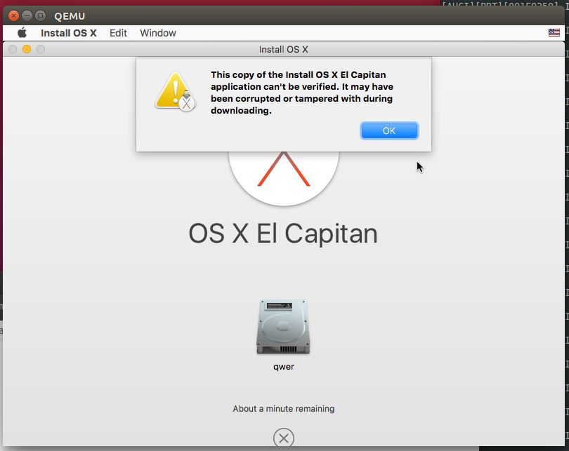

Hello Folks,
I have been reading this topic with great interest, and I have set up the following on my system (core i7-3770, Gigabyte GA-Z77P-D3, 16GB RAM, and NVidia GT740):
I have Ubuntu 15.10, with qemu 2.3.0 with kvm. pretty vanilla, i blacklisted nouveau module and set up pci-stub for IOMMU/VFIO.
i got windows 10 KVM up and running, and passing through nvidia card and keyboard/mouse/audio. works well.
I am, however, stumbling on getting OSX to install under Clover/OVMF environment.
- I use qemu's command line, OVMF, and clover image from waschbenzin's post here
- I also checked that hdiutil verified the downloaded install image as ok, then I made El Capitan Installer from USB.
- I just added another USB disk to waschbenzin's qemu's command line as:
-device ide-drive,bus=hdbus.2,drive=installer \
-drive id=installer,if=none,file=/samba/playground/elcap10.11.3_usb.dd,format=raw  \
- I became root (sudo -s) and launched waschbenzin's start-kvm.sh
- Clover came up fine, detected the installer, booted up and I reached the installer's menu. The last debug messages on stdio was:
[AHCI][PRT][001F0250]-IOAHCIPort::start - result = TRUE
[AHCI][PRT][001F0250]*IOAHCIPort::start - gAHCIDebugFlags = 0x1
** AppleSMBusPCI::start failed to get acpi path for provider
ACPI_SMC_PlatformPlugin::start - waitForService(resourceMatching(AppleIntelCPUPowerManagement) timed out
kPEDisableScreen 1
kPEDisableScreen 1
initialize_screen: b=FFFFFF8867955000, w=00000320, h=00000258, r=00000C80, d=00000001
kPEEnableScreen 1
- I then proceeded to format the install target disk, and choose Install OS X. After 2-3 seconds, I am greeted with the following:
(see attached file: A window pops up and says "This copy of the Install OS X El Capitan application can't be verified. It may have been corrupted or tampered with during downloading." )
I now am stumped. I tried to google this problem. Some links (this and this) told me to check the installer, which I did earlier (and have installed on bare-metal hackintosh or virtualbox without problem) - I have also checked that the date & time in terminal are current.
Does anyone have any recommendation to this? I would certainly appreciate it. I feel that I am so close.  This is OS X 10.11.3 clean install.
Thanks and best regards!

I'd ask an admin to move your post to another thread.
It states that your installer image is corrupted or ​it can't get successfully checked. Use "createinstaller" method to create a usb installer and test with it.

Please don't move this post to another thread. I believe it is relevant to clover+ovmf.
I have installed OS X El Capitan so many times in many different environments (bare metal hackintosh, virtualbox, vmware, qemu-kvm with SeaBios+enoch). I have never experienced this before, except for this particular qemu-kvm clover+ovmf combination.

Try to use that installer image on a "bare metal" pc and see if it works then.

That's what I'm trying to do next. Thanks for the tip on installer log. I have found the culprit: CSSMERR_TP_CERT_EXPIRED
Feb 22 10:04:41 Mac-Pro InstallAssistant[487]: Retrieved package com.apple.pkg.CompatibilityUpdate (http://swcdn.apple.com/content/downloads/09/24/031-40361/b5r7n37buecb3gbsdtn5yc24vnml73y1lk/OSX_10_11_IncompatibleAppList.pkg)
Feb 22 10:04:42 Mac-Pro InstallAssistant[487]: Error verifying ESD Payload PKG: The operation couldn’t be completed. (PKProductErrorDomain error 0.)
Feb 22 10:04:42 Mac-Pro InstallAssistant[487]: Underlying error: The operation couldn’t be completed. CSSMERR_TP_CERT_EXPIRED
Feb 22 10:04:42 Mac-Pro InstallAssistant[487]: pkgdmg is not signed or altered.
Feb 22 10:04:42 Mac-Pro InstallAssistant[487]: pkgdmg validation has failed.

The fundamental thing about certificates is correct date. Or your image is indeed corrupt. Can't you create a usb installer with official "createinstaller" and assign it to your VM and boot from it?
Just to chime in
During the update of my docs and validation of instructions, I also got the 'This copy of the Install OS X El Capitan application can't be verified.  It may have been corrupted or tampered with during downloading.'
I am comfortable saying the source image is valid, but to confirm I ran what I think should validate the source drive image:
hdiutil verify Install\ OS\ X\ El\ Capitan.app/Contents/SharedSupport/InstallESD.dmg

Hi smolderas and ThatGordo,
smolderas, I have always created my usb device by createinstallmedia. In fact, I don't know any other way. :lol:  It turns out that out of all 4 raw dumps that I had on hand. Only one worked. They have all been created from the same set of files, which verified ok (same command as ThatGordo's above.)
Thanks a lot, ThatGordo, for sharing your experience. Otherwise I will feel like I'm the only guy who encountered this problem.
So, after that, I got El Capitan installed and running on qxl. I am going to pass through my nvidia gpu now. waschbenzin's clover-debug-test will be removed and clover will be installed to the EFI system partition of my mac system drive. Reporting back soon...

Glad to hear that it worked for you.
You could always manually create an image with dd and bless. Nevertheless the command ThatGordo mentions checks the integrity of the dmg images. The OS X checks the signature (hash value of the whole image I think?) and the certificates, which you can't just verify with hdiutil verify...

So something else is going on here.
On a hunch, after the error message and getting bounce back the 'OS X Utilities' main menu, I fired up terminal and set the date back in time using:
date 0101032116
Then ran 'Install OS X' and it ran without errors.
So, something is up and it appears to be unrelated to corrupt images.
date 0101032116
As I mentioned earlier, the certificates couldn't get verified because of the wrong date...
I am sorry if I missed that, but can you be more clear?
In my instance it worked _because_ of the wrong date.
i.e. It would appear that a certificate has expired, which caused the 'CSSMERR_TP_CERT_EXPIRED' error.  Back dating to when the cert was valid allowed the install to continue.
Sure. It is all correct, what happened.
Certificates would be issued for a limited time, like 1 or 2 years, depending when the OS X image is downloaded.
I think you've caught the right time frame with the "wrong date". Try to set the date 2-3 years prior to what you've set, it won't work...
Sorry if it's not clear enough, hence english is not my native language.
Does anyone know if there is an easy way to set the clock for the kvm / qemu image at start time?  Setting it in the 'OS X Utilities' main menu via terminal is a pain.
Also, wouldn't this error impact anyone using the image with real Apple hardware?
Or is there something going on with the 'OSX_10_11_IncompatibleAppList.pkg' that gets downloaded?
(Looking back at the error from smolderas, the error is immediately after downloading that file.)
Just a side note about that downloaded file. It contains nothing but a list of incompatible apps and kexts, that would get moved to a folder, if you do an update instead of a clean install.
To your first question, yes, it would impact real Apple hardware as well.
Since I don't have a setup like that (yet) and don't know anything about QEMU or its configurations I can only assume, that there should be some options to "share" the host time with the VM's...
Edit:
quick google search yielded this about "-rtc" option:
Specifies the way the RTC is handled inside a VM Guest. By default, the clock of the guest is derived from that of the host system. Therefore, it is recommended that the host system clock is synchronized with an accurate external clock (for example, via NTP service).
If you need to isolate the VM Guest clock from the host one, specify clock=vm instead of the default clock=host.
You can also specify a 'starting point' for VM Guest clock with the base option:
qemu-kvm [...] -rtc clock=vm,base=2010-12-03T01:02:00
Instead of a timestamp, you can specify utc or localtime. The former instructs VM Guest to start at the current UTC value (Coordinated Universal Time, see http://en.wikipedia.org/wiki/UTC), while the latter applies the local time setting.
