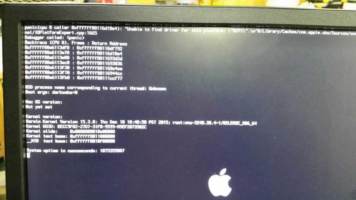

bclinton Posted February 4, 2016 Share Posted February 4, 2016 Ugh! Problem right from boot Here is a screen shot of the screen. It went right to panic mode after I clicked Install Mac OSX from Installer. Any suggestions on where to start or do I need to start from scratch? Thanks. Link to comment Share on other sites More sharing options...
polyzargone Posted February 4, 2016 Share Posted February 4, 2016 Post full EFI folder from your USB stick here. Link to comment Share on other sites More sharing options...
bclinton Posted February 4, 2016 Share Posted February 4, 2016 Post full EFI folder from your USB stick here. Please see attached. EFI.zip Link to comment Share on other sites More sharing options...
owbp Posted February 4, 2016 Share Posted February 4, 2016 Move DSDT.aml from AMD Radeon 5450 folder to "patched" folder! Edit:@polyzargone, 1 sec difference! 2 Link to comment Share on other sites More sharing options...
polyzargone Posted February 4, 2016 Share Posted February 4, 2016 OK. Easy one ! You copied the whole folder "AMD Radeon HD 5450" in EFI/CLOVER/ACPI/patched instead of copying the DSDT.aml file that's inside . Move this file in EFI/CLOVER/ACPI/patched so you have EFI/CLOVER/ACPI/patched/DSDT.aml and not EFI/CLOVER/ACPI/patched/AMD Radeon HD 5450/DSDT.aml [EDIT] Damn ! owbp is just too fast ! 2 Link to comment Share on other sites More sharing options...

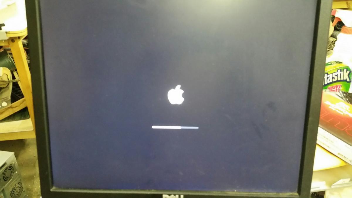

bclinton Posted February 5, 2016 Share Posted February 5, 2016 (edited) You guys rock! That did it. Now I am at this point. It seemed to get stuck about 2/3 of the way. I powered down and upped my ram to 8 gigs from 4. I just restarted it and I will let it go over night. I hope I didnt mess anything up with the hard shut down. 12. You will eventually get to the setup screens for OS X El Capitan. Go through the setup process to setup OS X El Capitan. 13. Choose at, “How do I connect to the internet”… “MY Computer Does Not Connect to the Internet”, we will fix this later, go further with the setup process. 14. The setup process will take about 3 minutes. 15. Done! So after I shut it down and started the "boot from El Capitan" option it got stuck a little less then 1.2 way through. I figure it did not appreciate the shutdown. I tried it twice with the same result. Tonight I will wipe the drive and back at installing from USB - step 6. I remember when I loaded Yosemite on Virtual Box it took forever so maybe I was a little impatient. Edited February 5, 2016 by bclinton 2 Link to comment Share on other sites More sharing options...

bclinton Posted February 6, 2016 Share Posted February 6, 2016 Well heck. I tried the process again and it hung at pretty much the same spot. It is hanging after I install OSX to the HD and reboot then select boot from El Capitan. Not trying to bug you guys to death but is there anything that I can try? Would I be better off trying another version of OSX? Link to comment Share on other sites More sharing options...
Blaggah Posted February 6, 2016 Share Posted February 6, 2016 Well heck. I tried the process again and it hung at pretty much the same spot. It is hanging after I install OSX to the HD and reboot then select boot from El Capitan. Not trying to bug you guys to death but is there anything that I can try? Would I be better off trying another version of OSX? Which graphics card are you using on this optiplex? Link to comment Share on other sites More sharing options...
owbp Posted February 6, 2016 Share Posted February 6, 2016 @bclinton, always boot in verbose so we could see what is really happening during first boot. 1 Link to comment Share on other sites More sharing options...
polyzargone Posted February 6, 2016 Share Posted February 6, 2016 Well heck. I tried the process again and it hung at pretty much the same spot. It is hanging after I install OSX to the HD and reboot then select boot from El Capitan. Not trying to bug you guys to death but is there anything that I can try? Would I be better off trying another version of OSX? Please boot in verbose mode (press space bar at the Clover boot menu and select Boot Mac OS X in verbose mode) so we can know where it hangs and hopefully why ! @Blaggah Do you have any third party hardware such as USB PCI extension card or whatever ? Also, could you run this in a terminal window : pmset -g assertions syslog | grep "wake reason" And post result here. [EDIT] @owbp You did it again… 1 Link to comment Share on other sites More sharing options...
