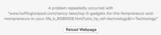

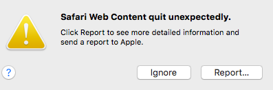

I followed your guide to install 10.11.1 on my Dell 780 sff (120 GB ssd, 8G ram, Asus GeForce GT 610 (1GB)), using the generic DSDT as mentioned in the guide.
Installation went well and programs like Office 2011 works like a charm. Installed all App Store updates (only iTunes and one small other one).
Alle hardware including the GT 610 is recognized.

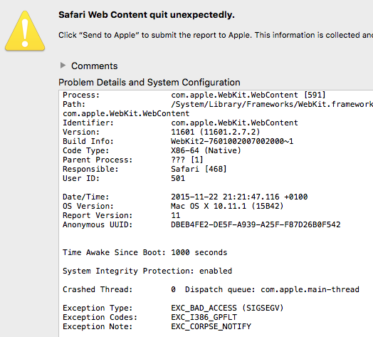

The problem is Firefox and Safari crash a lot! Reloading pages because of errors, spontaneous log-offs and even whole restarts of the machine! At a point Firefox did not even start any more, strangely enough when I choose in Clover booting for "InjectNVidia = no" Firefox did start again. But the problems with the webpages are not over.
There are a lot of crash reports something to do (I think) with the graphics.
Does someone have any ideas how to solve this?
(I had the same issue with 10.10 and I hoped 10.11 would solve this)

Could it be a RAM issue? I saw at the end of a crash report (sic) that I have 3 different types of RAM.
4x 2GB, 2 are exactly the same brand and typenumber, the other two are different.
Windows had no problems with this, but maybe OSX does? It is regonized as 8GB 1333 MHz.
I don't think so. If Windows's OK, there no reason OS X isn't. Plus, you'd have different problem if is was a RAM issue.
What's the version of OS X ?
The problem is perhaps on the config.plist and not in the DSDT ???
Could be. Or the problem is using a DSDT from 760/780 series with a 755 model. I'm not even sure there's no big differences between 760/780. AFAIK, both 5450 and Generic DSDT works fine with the 760/780 but we don't have enough reports about 755…
