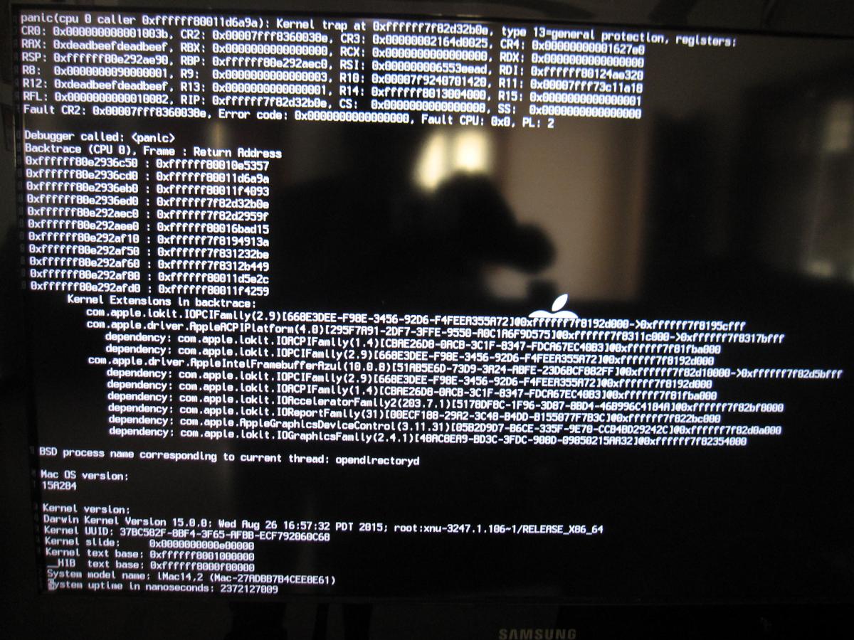

I experienced a similar issue with my test machine too (Asrock kH97M Pro4). With a graphics card installed I got an immediate kernel panic on boot when I used Clover to inject a DSDT although the DSDT was working perfectly without graphics card. Even injecting the vanilla DSDT I extracted with Clover some time before resulted in the kernel panic. Unfortunately I haven't found time for further investigation of the problem, I managed to find a temporary workaround. Using Clover's ability to patch the DSDT and inject graphics properties works fine for me. You might give it a try too.
By the way, the platform-id should match the system definition, i.e. 04001204 is for iMac14,2 and 0b001204 is for iMac15,1. As a thumb rule it's best to stay as close as possible to the configuration of the Mac model you are using as the system definition.
The real cause of your problem may be located in the IGPU related code of the DSDT. I will take a closer look at it as soon as I find some time.

Tried clover patching, but same kernel panic. Kernel panic only when Display is connected to mobo connector during boot. Is there any other method/patch (other than empty framebuffer) to kill/freeze IGPU during boot ??
Unfortunately no, at least no other method I know. What setup for the IGPU are you using in BIOS? VRAM, render standby, multi monitor support? Have you tired UEFI boot?

With all combinations, i am always getting kernel panic and a restart. Don't know whether the problem is with my motherboard. With no display attached to motherboard, it can boot into El capitan using emtpy framebuffer, this scenario can also be achieved using 0300220D, Hence no use to me. Since my mobo has only HDMI, i am left with zero options.
I was able to reproduce the issue with the HDMI port on both Asrock boards, with the B85 Killer it happens on every boot, with the H97M Pro4 only sometimes. With DVI everything is fine, no kernel panic on boot when a display is connected. Maybe a DSDT patch might help? Anyway, I will try to find a solution.

@kkarun88: The kernel panic might be related to HMDI audio because it doesn't appear with DVI. Also I managed to boot with HDMI cable connected on an installation without kext patches to enable HDMI audio. Did you install these patches too?
