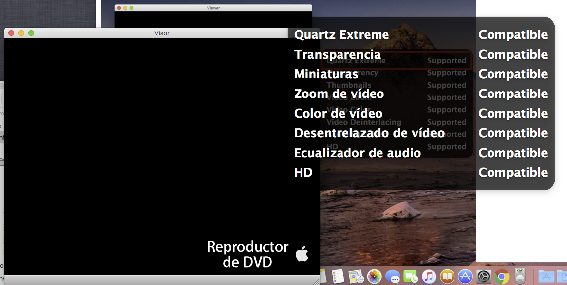

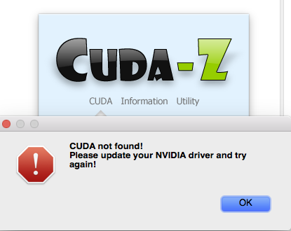

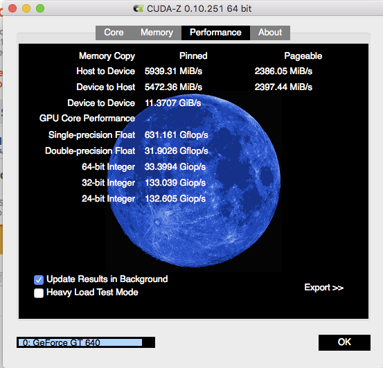

jaygrid Posted May 17, 2016 Share Posted May 17, 2016 Rockey12 you are a big help So my graphic is quartz compatible (is in spanish but clear enough) I try a program to test cuda but say i have to upgrade driver, don't know how. Rockey12, I tried to solve FaceTime but did not work, thanks anyhow It is safe to upgrade in z600 to 10.11.5?? 1 Link to comment Share on other sites More sharing options...

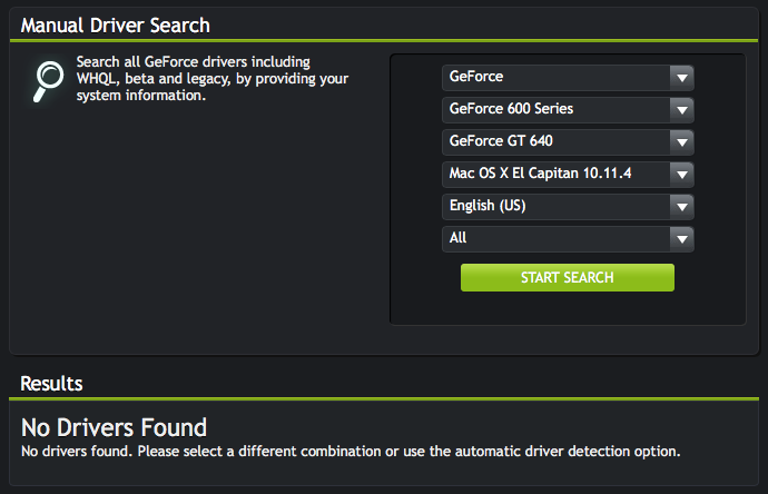

jaygrid Posted May 17, 2016 Share Posted May 17, 2016 No, i can't, there is not driver for GT640 for any version of El Capitan in Nvidia Link to comment Share on other sites More sharing options...

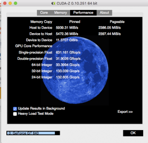

jaygrid Posted May 17, 2016 Share Posted May 17, 2016 Rockey, you are the best I don't know if is better but now is cuda (still don't know what is this) thank you 1 Link to comment Share on other sites More sharing options...

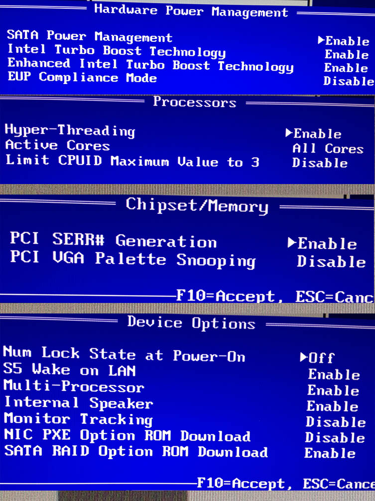

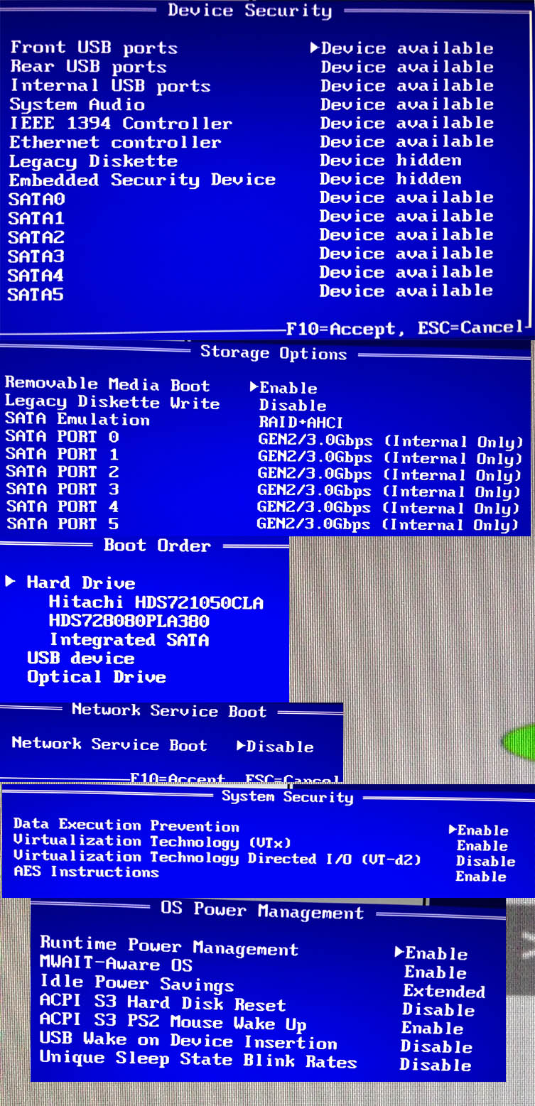

raycillo Posted May 17, 2016 Share Posted May 17, 2016 Hi, friends... i am again... I do have a reinstall all pc, fro clean. I have create the USB boot, with clover dell precision 690 usb creation tool, Install Clover on ESP and replace files on EFI partition. But not Boooottt..(panic AppleUSBUHCIPCI) . :( What is fail... Mi BIOS updated to latest version April 2016 This is my configuration Bios... is bad? Ur HDD should be connected to first SATA port which is Nr 0 ( yes, HD is Nr0) can u mount the efi partition on ur HDD (Yes Mount the hide efi partition ) I hope you are not using Mavricks and El Cap on the Same HDD (El Capitan is in one, Maverics is other..) Other note, when i use the DSDT for my Z600, Nothing happens. When i use the generic DSDT file, boot, but fail panic. Is this DSDT file incorrect? DSDT.zip Link to comment Share on other sites More sharing options...
