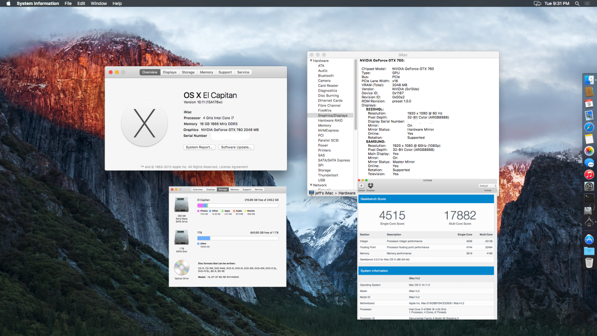

Got it running with surprisingly little work. Thank you to everyone in the community!
Clover v3215 with CSM disabled
Driver64UEFI:
emuvariableuefi-64, hfsplus, osxaptiofixdrv-64 and partitiondxe-64
Kexts:
fakesmc (6.14.1364) and appleintele1000e
Bootflag:
rootless=0
For the public beta i had to select 'inject nvidia' in the clover option menu before booting to the installer.
