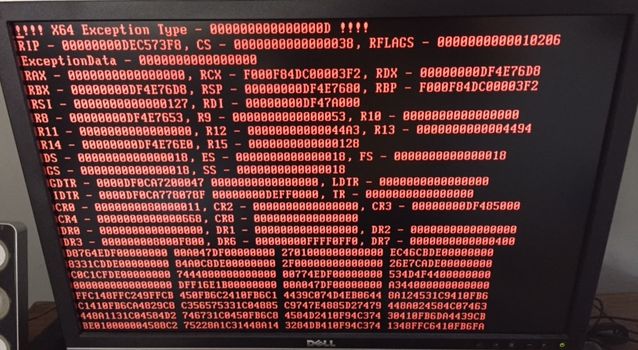

Still not working right for me without QPI=100.
DMI Table:
	Version: Intel(R) Core(TM) i7-2600K CPU @ 3.40GHz
	Voltage: 0.0 V
	External Clock: 11 MHz
	Max Speed: 1599 MHz
	Current Speed: 1600 MHz
Sysctl:
hw.tbfrequency: 1000000000
hw.cpufrequency_max: 1599000000
hw.cpufrequency_min: 1599000000
hw.cpufrequency: 1599000000
hw.busfrequency_max: 44000000
hw.busfrequency_min: 44000000
hw.busfrequency: 44000000
machdep.tsc.frequency: 3400000000
System Information:
  Nombre del modelo:	        Mac Pro
  Identificador del modelo:	MacPro5,1
  Nombre del procesador:	Intel Core i7
  Velocidad del procesador:	1,60 GHz
  Cantidad de procesadores:	1
  Cantidad total de núcleos:	4
  Caché de nivel 2:	        256 KB
  Caché de nivel 3:	        8 MB
  Memoria:	                16 GB
Piker's AppleIntelInfo:
AppleIntelInfo.kext v2.6 Copyright © 2012-2017 Pike R. Alpha. All rights reserved.
Settings:
logMSRs..................................: 1
logIGPU..................................: 1
logCStates...............................: 1
logIPGStyle..............................: 1
InitialTSC...............................: 0x1ba5b56f452 (55 MHz)
MWAIT C-States...........................: 4384
Processor Brandstring....................: Intel(R) Core(TM) i7-2600K CPU @ 3.40GHz
Bootlog:
0:100  0:100  MemLog inited, TSC freq: 3398916956
0:100  0:000
0:100  0:000  Now is 23.6.2017,  0:37:46 (GMT)
0:100  0:000  Starting Clover revision: 4098 on American Megatrends EFI
0:100  0:000  Build with: [Args: -x64 -D NO_GRUB_DRIVERS_EMBEDDED -D CHECK_FLAGS -t XCODE8 | -D NO_GRUB_DRIVERS_EMBEDDED -D CHECK_FLAGS -D USE_LOW_EBDA -a X64 -b RELEASE -t XCODE8 -n 5 | OS: 10.12.6 | XCODE: 8.3.3]
0:100  0:000  SelfDevicePath=PciRoot(0x0)\Pci(0x1F,0x2)\Sata(0x1,0xFFFF,0x0)\HD(1,GPT,0F32BE22-6EB4-44FF-A3A3-08EC0C5036DF,0x28,0x64000) @AAD6418
0:100  0:000  SelfDirPath = \EFI\CLOVER
0:100  0:000  === [ Get Smbios ] ========================================
0:100  0:000  Type 16 Index = 0
0:100  0:000  Total Memory Slots Count = 4
0:100  0:000  Type 17 Index = 0
0:100  0:000  Ignoring insane frequency value 0MHz
0:100  0:000  SmbiosTable.Type17->Speed = 0MHz
0:100  0:000  SmbiosTable.Type17->Size = 0MB
0:100  0:000  SmbiosTable.Type17->Bank/Device = A1_BANK0 A1_DIMM0
0:100  0:000  SmbiosTable.Type17->Vendor = <null string>
0:100  0:000  SmbiosTable.Type17->SerialNumber = <null string>
0:100  0:000  SmbiosTable.Type17->PartNumber = <null string>
0:100  0:000  Type 17 Index = 1
0:100  0:000  SmbiosTable.Type17->Speed = 1867MHz
0:100  0:000  SmbiosTable.Type17->Size = 8192MB
0:100  0:000  SmbiosTable.Type17->Bank/Device = A1_BANK1 A1_DIMM1
0:100  0:000  SmbiosTable.Type17->Vendor = Undefined
0:100  0:000  SmbiosTable.Type17->SerialNumber = 00000000
0:100  0:000  SmbiosTable.Type17->PartNumber = F3-1866C9-8GSR
0:100  0:000  Type 17 Index = 2
0:100  0:000  SmbiosTable.Type17->Bank/Device = A1_BANK2 A1_DIMM2
0:100  0:000  Type 17 Index = 3
0:100  0:000  SmbiosTable.Type17->Bank/Device = A1_BANK3 A1_DIMM3
0:100  0:000  Boot status=0
0:100  0:000  Running on: 'TZ68K+' with board 'TZ68K+'
0:100  0:000  === [ GetCPUProperties ] ==================================
0:100  0:000  CPU Vendor = 756E6547 Model=206A7
0:100  0:000   The CPU supported SSE4.1
0:100  0:000  The CPU supported turbo
0:100  0:000  BrandString = Intel(R) Core(TM) i7-2600K CPU @ 3.40GHz
0:100  0:000  MSR 0xE2 before patch 1E008407
0:100  0:000  MSR 0xE2 is locked, PM patches will be turned on
0:100  0:000  MSR 0xCE              00001000_70012200
0:100  0:000  MSR 0x1A0             00850089
0:100  0:000  corrected FLEX_RATIO = E0000
0:100  0:000  MSR 0x1B0             00000000
0:100  0:000  FSBFrequency = 47 MHz, DMI FSBFrequency = 100 MHz, Corrected FSBFrequency = 100 MHz
0:100  0:000  MaxDiv/MinDiv: 34.0/16
0:100  0:000  Turbo: 44/44/45/45
0:100  0:000  Features: 0xBFEBFBFF
0:100  0:000  Threads: 8
0:100  0:000  Cores: 4
0:100  0:000  FSB: 25 MHz
0:100  0:000  CPU: 1600 MHz
0:100  0:000  TSC: 1600 MHz
0:100  0:000  PIS: 100 MHz

1:411  0:000  Using XMP Profile2 instead of standard frequency 1333MHz
1:411  0:000  DDR speed 1866MHz
1:411  0:000  Slot: 1 Type 24 8192MB 1866MHz Vendor=G Skill Intl PartNo=F3-1866C9-8GSR SerialNo=0000000000000000
1:411  0:000  SPD[3]: Type 11 @0x53
1:428  0:016  XMP Profile1: 9*1/8ns
1:428  0:000  XMP Profile2: 10*3/28ns
1:428  0:000  Found module with XMP version 1.3
1:428  0:000  Using XMP Profile2 instead of standard frequency 1333MHz
1:428  0:000  DDR speed 1866MHz
1:428  0:000  Slot: 3 Type 24 8192MB 1866MHz Vendor=G Skill Intl PartNo=F3-1866C9-8GSR SerialNo=0000000000000000
1:429  0:000  === [ GetAcpiTablesList ] =================================
1:435  0:005  Get Acpi Tables List from RSDT:
1:435  0:000   - [00]: FACP  A M I len=132
1:435  0:000   - [01]: APIC  A M I len=146
1:435  0:000   - [02]: SSDT  PROC len=470
1:435  0:000   - [03]: MCFG  A M I    len=60
1:435  0:000   - [04]: HPET  A M I len=56
1:435  0:000   - [05]: ASPT  PerfTune len=52
1:435  0:000  Calibrated TSC frequency =3398916956 =3398MHz
1:435  0:000  main.c gCPUStructure.ExternalClock = gCPUStructure.ExternalClock / 4
1:435  0:000  TEST: 24 MHz
1:435  0:000  === [ GetUserSettings ] ===================================
1:435  0:000  USB FixOwnership: no
1:435  0:000  Dropping 2 tables:
1:435  0:000   - [00]: Drop table  signature="MCFG" (4746434D)
1:435  0:000           - set table: 4746434D,                0 to drop: yes
1:435  0:000   - [01]: Drop table  signature="SSDT" (54445353) table-id="PROC" (00000000434F5250)
1:435  0:000           - set table: 54445353,         434F5250 to drop: yes
1:435  0:000   - final DSDT Fix mask=10400000
1:435  0:000  EnableC7: yes
1:435  0:000  EnableC6: yes
1:435  0:000  EnableC4: yes
1:435  0:000  EnableC2: yes
1:435  0:000  ChassisType: 0x6
1:439  0:003  === [ ScanVolumes ] =======================================
1:439  0:000  Found 12 volumes with blockIO
1:439  0:000  - [00]: Volume: PciRoot(0x0)\Pci(0x1F,0x2)\Sata(0x0,0xFFFF,0x0)
1:439  0:000          Result of bootcode detection: bootable unknown (legacy)
1:439  0:000  - [01]: Volume: PciRoot(0x0)\Pci(0x1F,0x2)\Sata(0x1,0xFFFF,0x0)
1:440  0:000          Result of bootcode detection: bootable unknown (legacy)
1:440  0:000  - [02]: Volume: PciRoot(0x0)\Pci(0x1F,0x2)\Sata(0x2,0xFFFF,0x0)
1:440  0:000  - [03]: Volume: PciRoot(0x0)\Pci(0x1F,0x2)\Sata(0x5,0xFFFF,0x0)
1:440  0:000          Found optical drive
1:440  0:000  - [04]: Volume: PciRoot(0x0)\Pci(0x1F,0x2)\Sata(0x0,0xFFFF,0x0)\HD(1,GPT,E9E71EDA-1C80-41E6-9C1E-556B47E4484B,0x28,0x64000)
1:441  0:000          Result of bootcode detection: bootable Clover (clover)
1:442  0:000  - [05]: Volume: PciRoot(0x0)\Pci(0x1F,0x2)\Sata(0x0,0xFFFF,0x0)\HD(2,GPT,80D2347B-BC26-46D9-AAA8-50BD937454A7,0x64028,0x74662D60)
1:442  0:000  - [06]: Volume: PciRoot(0x0)\Pci(0x1F,0x2)\Sata(0x1,0xFFFF,0x0)\HD(1,GPT,0F32BE22-6EB4-44FF-A3A3-08EC0C5036DF,0x28,0x64000)
1:443  0:000          Result of bootcode detection: bootable Clover (clover)
1:451  0:008          This is SelfVolume !!
1:451  0:000  - [07]: Volume: PciRoot(0x0)\Pci(0x1F,0x2)\Sata(0x1,0xFFFF,0x0)\HD(2,GPT,F6BDE7CF-0200-4231-803A-5AEC5D747368,0x64028,0xDDFAC40)
1:452  0:000  - [08]: Volume: PciRoot(0x0)\Pci(0x1F,0x2)\Sata(0x1,0xFFFF,0x0)\HD(3,GPT,D45A2926-9600-438E-86B8-21FBE6CBB061,0xDE5EC68,0x135F20)
1:453  0:000  - [09]: Volume: PciRoot(0x0)\Pci(0x1F,0x2)\Sata(0x2,0xFFFF,0x0)\HD(1,GPT,5148B030-E155-4B37-A23C-74EF4CAFDACA,0x28,0x64000)
1:453  0:000          Result of bootcode detection: bootable unknown (legacy)
1:486  0:033  - [10]: Volume: PciRoot(0x0)\Pci(0x1F,0x2)\Sata(0x2,0xFFFF,0x0)\HD(2,GPT,4E94DB7F-4755-4958-A2A0-784496EBD3C0,0x64800,0xB98CD28)
1:487  0:000          Result of bootcode detection: bootable Windows (vista,win)
1:487  0:000  - [11]: Volume: PciRoot(0x0)\Pci(0x1F,0x2)\Sata(0x2,0xFFFF,0x0)\HD(3,GPT,0850F8E8-65AB-4EDE-B97B-8A9C98E6026D,0xBAA8000,0x68C1ED88)
1:488  0:000  === [ InitTheme ] =========================================
1:490  0:002  Using theme 'Shield' (EFI\CLOVER\themes\Shield)
1:490  0:000  theme Shield defined in NVRAM found and theme.plist parsed
1:490  0:000  OS main and drive as badge
1:493  0:003  Loading font from ThemeDir: Success
1:494  0:000  Choosing theme Shield
1:494  0:000  after NVRAM boot-args=darkwake=0
1:494  0:000  === [ Dump SMC keys from NVRAM ] ==========================
1:494  0:000  found AppleSMC protocol
1:557  0:063  === [ AddCustomEntries ] ==================================
1:557  0:000  Custom entry 0 FullTitle:"Sierra" Path:"\System\Library\CoreServices\boot.efi" Type:1 Flags:0x2 matching Volume:"Sierra"
1:557  0:000      Checking volume "EFI" (PciRoot(0x0)\Pci(0x1F,0x2)\Sata(0x0,0xFFFF,0x0)\HD(1,GPT,E9E71EDA-1C80-41E6-9C1E-556B47E4484B,0x28,0x64000)) ... skipped
1:557  0:000      Checking volume "Kodama" (PciRoot(0x0)\Pci(0x1F,0x2)\Sata(0x0,0xFFFF,0x0)\HD(2,GPT,80D2347B-BC26-46D9-AAA8-50BD937454A7,0x64028,0x74662D60)) ... skipped
1:557  0:000      Checking volume "EFI" (PciRoot(0x0)\Pci(0x1F,0x2)\Sata(0x1,0xFFFF,0x0)\HD(1,GPT,0F32BE22-6EB4-44FF-A3A3-08EC0C5036DF,0x28,0x64000)) ... skipped
1:557  0:000      Checking volume "Sierra" (PciRoot(0x0)\Pci(0x1F,0x2)\Sata(0x1,0xFFFF,0x0)\HD(2,GPT,F6BDE7CF-0200-4231-803A-5AEC5D747368,0x64028,0xDDFAC40)) ... match!
1:562  0:005      Check if volume Is Hibernated:
1:562  0:000      Check sleep image 'by signature':
1:568  0:005      read prefs \Library\Preferences\com.apple.PowerManagement.plist status=Success
1:568  0:000      using default sleep image name = \private\var\vm\sleepimage
1:570  0:002      sleepimage not found -> Not Found
1:570  0:000      hibernated: no - sign
1:578  0:007  Custom settings: <null string>.plist will  be applied
1:578  0:000      Checking volume "Recovery HD" (PciRoot(0x0)\Pci(0x1F,0x2)\Sata(0x1,0xFFFF,0x0)\HD(3,GPT,D45A2926-9600-438E-86B8-21FBE6CBB061,0xDE5EC68,0x135F20)) ... skipped
1:578  0:000      Checking volume "EFI" (PciRoot(0x0)\Pci(0x1F,0x2)\Sata(0x2,0xFFFF,0x0)\HD(1,GPT,5148B030-E155-4B37-A23C-74EF4CAFDACA,0x28,0x64000)) ... skipped
1:578  0:000      Checking volume "TM" (PciRoot(0x0)\Pci(0x1F,0x2)\Sata(0x2,0xFFFF,0x0)\HD(3,GPT,0850F8E8-65AB-4EDE-B97B-8A9C98E6026D,0xBAA8000,0x68C1ED88)) ... skipped
1:578  0:000  Custom entry 1 skipped because it is hidden.
1:578  0:000  Custom entry 2 FullTitle:"Windows 7" Path:"\EFI\Microsoft\Boot\bootmgfw.efi" Options:"-s -h" Type:7 Flags:0x0 matching Volume:"5148B030-E155-4B37-A23C-74EF4CAFDACA"
1:578  0:000      Checking volume "EFI" (PciRoot(0x0)\Pci(0x1F,0x2)\Sata(0x0,0xFFFF,0x0)\HD(1,GPT,E9E71EDA-1C80-41E6-9C1E-556B47E4484B,0x28,0x64000)) ... skipped
1:578  0:000      Checking volume "Kodama" (PciRoot(0x0)\Pci(0x1F,0x2)\Sata(0x0,0xFFFF,0x0)\HD(2,GPT,80D2347B-BC26-46D9-AAA8-50BD937454A7,0x64028,0x74662D60)) ... skipped
1:578  0:000      Checking volume "EFI" (PciRoot(0x0)\Pci(0x1F,0x2)\Sata(0x1,0xFFFF,0x0)\HD(1,GPT,0F32BE22-6EB4-44FF-A3A3-08EC0C5036DF,0x28,0x64000)) ... skipped
1:578  0:000      Checking volume "Sierra" (PciRoot(0x0)\Pci(0x1F,0x2)\Sata(0x1,0xFFFF,0x0)\HD(2,GPT,F6BDE7CF-0200-4231-803A-5AEC5D747368,0x64028,0xDDFAC40)) ... skipped
1:578  0:000      Checking volume "EFI" (PciRoot(0x0)\Pci(0x1F,0x2)\Sata(0x2,0xFFFF,0x0)\HD(1,GPT,5148B030-E155-4B37-A23C-74EF4CAFDACA,0x28,0x64000)) ... match!
1:583  0:005  Custom settings: <null string>.plist will  be applied
1:583  0:000      Checking volume "TM" (PciRoot(0x0)\Pci(0x1F,0x2)\Sata(0x2,0xFFFF,0x0)\HD(3,GPT,0850F8E8-65AB-4EDE-B97B-8A9C98E6026D,0xBAA8000,0x68C1ED88)) ... skipped
1:583  0:000  === [ ScanLoader ] ========================================
1:583  0:000  - [04]: 'EFI'
1:583  0:000  - [05]: 'Kodama'
1:591  0:007  - [06]: 'EFI'
1:592  0:001  - [07]: 'Sierra'
1:593  0:000          AddLoaderEntry for Volume Name=Sierra
1:593  0:000       skipped because path `PciRoot(0x0)\Pci(0x1F,0x2)\Sata(0x1,0xFFFF,0x0)\HD(2,GPT,F6BDE7CF-0200-4231-803A-5AEC5D747368,0x64028,0xDDFAC40)\System\Library\CoreServices\boot.efii` already exists for another entry!
1:593  0:000  - [08]: 'Recovery HD'
1:593  0:000          AddLoaderEntry for Volume Name=Recovery HD
1:593  0:000      Skipped because matching custom entry 1!
1:593  0:000  - [09]: 'EFI'
1:593  0:000          AddLoaderEntry for Volume Name=EFI
1:593  0:000       skipped because path `PciRoot(0x0)\Pci(0x1F,0x2)\Sata(0x2,0xFFFF,0x0)\HD(1,GPT,5148B030-E155-4B37-A23C-74EF4CAFDACA,0x28,0x64000)\EFI\microsoft\Boot\bootmgfw.efii` already exists for another entry!
1:593  0:000  - [11]: 'TM'
1:594  0:000  === [ AddCustomTool ] =====================================
1:595  0:001  found tool \EFI\CLOVER\tools\Shell64U.efi
1:595  0:000  Checking EFI partition Volume 4 for Clover
1:595  0:000  Checking EFI partition Volume 6 for Clover
1:596  0:000   Found Clover
1:598  0:002          [!] Icon 5 (icons\func_reset.png) not found (path: EFI\CLOVER\themes\Shield)
1:598  0:000  Icon 5 decoded, pointer A952A18
1:599  0:001  === [ GetEfiBootDeviceFromNvram ] =========================
1:599  0:000   - efi-boot-device-data: PciRoot(0x0)\Pci(0x1F,0x2)\Sata(0x1,0xFFFF,0x0)\HD(2,GPT,F6BDE7CF-0200-4231-803A-5AEC5D747368,0x64028,0xDDFAC40)
1:599  0:000    - Volume: 'PciRoot(0x0)\Pci(0x1F,0x2)\Sata(0x1,0xFFFF,0x0)\HD(2,GPT,F6BDE7CF-0200-4231-803A-5AEC5D747368,0x64028,0xDDFAC40)'
1:599  0:000    - LoaderPath: '<null string>'
1:599  0:000    - Guid = F6BDE7CF-0200-4231-803A-5AEC5D747368
1:599  0:000  === [ FindStartupDiskVolume ] =============================
1:599  0:000    - Volume: partition = PciRoot(0x0)\Pci(0x1F,0x2)\Sata(0x1,0xFFFF,0x0)\HD(2,GPT,F6BDE7CF-0200-4231-803A-5AEC5D747368,0x64028,0xDDFAC40)
1:599  0:000     - searching for that partition
1:599  0:000      - found entry 0. 'Sierra', Volume 'Sierra'
1:599  0:000  Boot redirected to Entry 0. 'Sierra'
1:599  0:000  DefaultIndex=0 and MainMenu.EntryCount=8
1:746  0:147  MouseBirth: No mouse at ConIn, checking if any other device exists
1:753  0:006  GUI ready
27:050  25:297  === [ StartLoader ] =======================================
27:050  0:000  Finally: Bus=47058kHz CPU=1599MHz
27:050  0:000  Loading boot.efi  status=Success
27:087  0:036  GetOSVersion: 10.12.5 (16F73)
27:087  0:000  CSR_CFG: CSR_ALLOW_UNTRUSTED_KEXTS | CSR_ALLOW_UNRESTRICTED_FS | CSR_ALLOW_TASK_FOR_PID | CSR_ALLOW_UNRESTRICTED_DTRACE | CSR_ALLOW_UNRESTRICTED_NVRAM
27:087  0:000  Filtering KextPatches:
27:087  0:000   - [00]: AppleAHCIPort (Fix Orange Disk) :: BinPatch :: [OS: 10.12.5 | MatchOS: All | MatchBuild: All] ==> allowed
27:087  0:000   - [01]: AirPortAtheros40 (Wi-Fi Region to CN RoW) :: BinPatch :: [OS: 10.12.5 | MatchOS: All | MatchBuild: All] ==> allowed
27:087  0:000   - [02]: AppleTyMCEDriver (NO AppleTyMCEDriver) :: BinPatch :: [OS: 10.12.5 | MatchOS: All | MatchBuild: All] ==> allowed
27:087  0:000  === [ PatchSmbios ] =======================================
27:087  0:000  insert table 9 for dev 0:0
27:087  0:000  insert table 9 for dev 0:1
27:088  0:000  Trusting SMBIOS...
27:088  0:000  Channels: 2
27:088  0:000  Interleave: 0 2 1 3 4 6 5 7 8 10 9 11 12 14 13 15 16 18 17 19 20 22 21 23
27:088  0:000  SMBIOS Type 17 Index = 0 => 0 0:
27:088  0:000   DIMM1 EMPTY
27:088  0:000  SMBIOS Type 17 Index = 1 => 2 2:
27:088  0:000   DIMM2 EMPTY
27:088  0:000   partNum=F3-1866C9-8GSR
27:088  0:000  SMBIOS Type 17 Index = 2 => 1 1:
27:088  0:000   DIMM3 1867MHz 8192MB
27:088  0:000  SMBIOS Type 17 Index = 3 => 3 3:
27:088  0:000   DIMM4 1867MHz 8192MB
27:088  0:000  mTotalSystemMemory = 16384
27:088  0:000  NumberOfMemoryDevices = 4
27:088  0:000  Type20[0]->End = 0x7FFFFF, Type17[2] = 0x2000
27:088  0:000  Type20[1]->End = 0xFFFFFF, Type17[3] = 0x6000
27:088  0:000  === [ PatchACPI ] =========================================
27:088  0:000  RSDT 0xCACBD028
27:088  0:000  FADT from RSDT: 0xCACBD0C8
27:088  0:000  XSDT 0xCACBD068
27:088  0:000  FADT from XSDT: 0xCACC4160
27:088  0:000  Xsdt reallocation done
27:088  0:000  old FADT length=F4
27:088  0:000  Found OperationRegion(NBNV, SystemMemory, CAE12C18, ...)
27:088  0:000  Found OperationRegion(SSDT, SystemMemory, CAE1B898, ...)
27:088  0:000  Found OperationRegion(CSDT, SystemMemory, CAE12D98, ...)
27:088  0:000  Found OperationRegion(HCNT, SystemMemory, FED1F404, ...)
27:092  0:004  DSDT found in Clover volume OEM folder: EFI\CLOVER\ACPI\patched\DSDT-v4.aml
27:093  0:001  Apply DsdtFixMask=0x10400000
27:093  0:000     drop _DSM mask=0x0000
27:093  0:000  === [ FixBiosDsdt ] =======================================
27:093  0:000  VideoCard devID=0x13C210DE
27:093  0:000  DisplayADR1[0] = 0x10000, DisplayADR2[0] = 0x0
27:093  0:000  USBADR[0] = 0x1A0000 and PCIe = 0xFFFE
27:104  0:010  USBADR[1] = 0x1C0001 and PCIe = 0x0
27:104  0:000  Found Airport Atheros at 0x1C0004, 0x0, DeviceID=0x002E
27:104  0:000  USBADR[2] = 0x1D0000 and PCIe = 0xFFFE
27:104  0:000  first CPU found at 58EE offset 58F1
27:104  0:000  score candidate at 58EA
27:104  0:000  score inserted in acpi_cpu_score _PR_
27:104  0:000  Found ACPI CPU: P000 | P001 | P002 | P003 | P004 | P005 | P006 | P007 , within the score: _PR_
27:104  0:000  Found PCIROOTUID = 0
27:104  0:000   deleting device CRT_
27:104  0:000   deleting device DVI_
27:105  0:000   deleting device SPKR
27:105  0:000   deleting device ECP_
27:105  0:000   deleting device LPT_
27:105  0:000   deleting device FDC0
27:105  0:000   deleting device ECP1
27:105  0:000   deleting device LPT1
27:105  0:000  OperationRegion (NBNV...) corrected to addr=0xCAE12C18
27:105  0:000  === [ ACPIDropTables ] ====================================
27:105  0:000  Drop tables from Xsdt, SIGN=MCFG TableID=A M I    Length=60
27:105  0:000   Xsdt has tables count=6
27:105  0:000   Table: MCFG  A M I     60 dropped
27:105  0:000  Drop tables from Xsdt, SIGN=SSDT TableID=PROC Length=470
27:105  0:000   Xsdt has tables count=5
27:105  0:000   Table: SSDT  PROC  470 dropped
27:105  0:000  === [ PatchAllSSDT ] ======================================
27:105  0:000  Drop tables from Xsdt, SIGN=XXXX TableID= Length=0
27:105  0:000   Xsdt has tables count=4
27:105  0:000  === [ ACPIPatchedAML ] ====================================
27:105  0:000  Unsorted
27:105  0:000  Inserting SSDT-HDMI-NVIDIA-P0P1.aml from EFI\CLOVER\ACPI\patched ... Success
27:106  0:001  Inserting SSDT.AML from EFI\CLOVER\ACPI\patched ... Success
27:107  0:001  CPUBase=0 and ApicCPUBase=1 ApicCPUNum=8
27:107  0:000  === [ RestSetup macOS ] ===================================
27:107  0:000  EdidDiscovered size=0
27:107  0:000  NVidia GFX injection not set
27:107  0:000  Intel HD Graphics 3000 [8086:0122] :: PciRoot(0x0)\Pci(0x2,0x0)
27:107  0:000    Found XGA Display - 4:3 :: Width=1024 Height=768
27:107  0:000    Default AAPL00,DualLink = 1
27:107  0:000    Low Resolution Display
27:107  0:000    AAPL00,DualLink: changed from 1 to not used
27:107  0:000    FakeID Intel GFX = 0x01268086
27:107  0:000    snb-platform-id = 0x00020000
27:107  0:000  Intel GFX revision  = 0x9
27:159  0:051   codec not detected
27:159  0:000  stringlength = 1466
27:159  0:000  CurrentMode: Width=1024 Height=768
27:159  0:000  Beginning FSInjection
FSInjectionInstall ...
- Our FSI_SIMPLE_FILE_SYSTEM_PROTOCOL installed on handle: AAD6198

Hi Slice,
I get a red screen error on my legacy desktop GAP55aUd3/Intel i5-750/ATI HD 5770 with officially released Clover >r4060:
Seems that commit r4061 causes the regression -
in rEFIt_UEFI/refit.inf
+ XCODE:*_*_*_CC_FLAGS = -fsigned-char -O2 -fno-common
The system makes it to the Clover GUI but red screens when applying Clover DSDT fixes, attempting to boot OS X (see attached debug log for r4061).
My system boots fine if I use Clover compiled without the -fno-common flag for Xcode -  eg see attached boot log with r4097.

Hi Slice,
This is not a good flag because in EFI binaries the rdata section is combined with the text section, that is needed. I believe this places the variables in the data section and that the -fcommon flag should be being used instead (it is the default, but not on all platforms).

Hi Slice,
