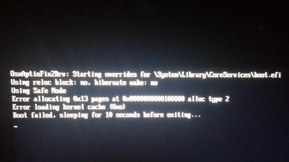

Sherlocks Posted May 19, 2017 Share Posted May 19, 2017 @apianti i can't pass this screenshot. hold message. can i check it? seems preboot log is fine. but i can't pass if i have test2.efi, don't have memory error, but still hold screen thanks in advance preboot.log.zip Link to comment Share on other sites More sharing options...
apianti Posted May 19, 2017 Share Posted May 19, 2017 @Sherlocks, Switch to OsxAptioFixDrv not OsxAptioFix2Drv. Or inspect your memory map and see if you have enough pages anywhere below 4GB (0x100000000) and slide the allocation (although you probably do not have that memory available). So why Clover uses Hacked one? ...Hacked? ...To add more tools? ...To help, you know, with making it easier to build... 1 Link to comment Share on other sites More sharing options...
Sherlocks Posted May 19, 2017 Share Posted May 19, 2017 @Sherlocks, Switch to OsxAptioFixDrv not OsxAptioFix2Drv. Or inspect your memory map and see if you have enough pages anywhere below 4GB (0x100000000) and slide the allocation (although you probably do not have that memory available). ...Hacked? ...To add more tools? ...To help, you know, with making it easier to build... Already checked osxaptifix2drv and osxaptiofixdrv. Still no luck. How can inspect memory? 나의 LG-F410S 의 Tapatalk에서 보냄 Link to comment Share on other sites More sharing options...
apianti Posted May 19, 2017 Share Posted May 19, 2017 Go into the efi shell, select a volume and memmap > memmap.txt EDIT: Oh, also, don't use any of the fix drivers in combinations, only ever use one, they conflict. Also those X79/X99 fixes, that came about from my conversation with nick, are not good long term solutions but a proof of concept. They basically just release as much memory as possible - that's probably not good. Link to comment Share on other sites More sharing options...
Sherlocks Posted May 19, 2017 Share Posted May 19, 2017 Go into the efi shell, select a volume and memmap > memmap.txt EDIT: Oh, also, don't use any of the fix drivers in combinations, only ever use one, they conflict. Also those X79/X99 fixes, that came about from my conversation with nick, are not good long term solutions but a proof of concept. They basically just release as much memory as possible - that's probably not good. yes, i only use one driver osxaptifix2drv or osxaptiofixdrv here is memmap file also, my skylake laptop has similiar issue. if use safe mode boot, i get memory error memmap.txt.zip Link to comment Share on other sites More sharing options...

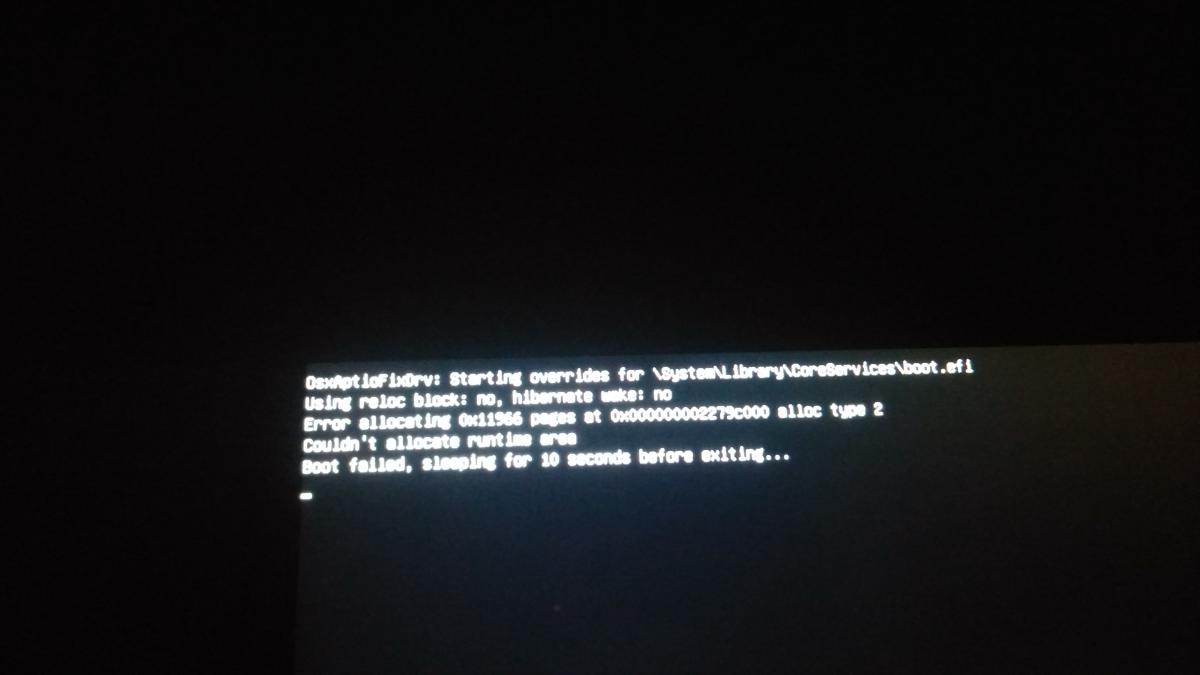

apianti Posted May 19, 2017 Share Posted May 19, 2017 Well even test2.efi and free2000.efi, etc. You can only use one memory fix. But not sure what's going on, where in the boot process is this memmap from? After the clover GUI? I see that you have plenty of memory here: Available 000000000EDE4000-000000002C941FFF 000000000001DB5E 000000000000000F Unsure why it's trying to allocate at the top of this available region instead of the bottom. What message are you getting with OsxAptioFixDrv, that message was from OsxAptioFix2Drv, right? Can you please start clover, enter the shell, get memmap, then boot with both using each driver and post memmaps and result images? EDIT: Wording. Link to comment Share on other sites More sharing options...

Sherlocks Posted May 20, 2017 Share Posted May 20, 2017 Well even test2.efi and free2000.efi, etc. You can only use one memory fix. But not sure what's going on, where in the boot process is this memmap from? After the clover GUI? I see that you have plenty of memory here: Available 000000000EDE4000-000000002C941FFF 000000000001DB5E 000000000000000F Unsure why it's trying to allocate at the top of this available region instead of the bottom. What message are you getting with OsxAptioFixDrv, that message was from OsxAptioFix2Drv, right? Can you please start clover, enter the shell, get memmap, then boot with both using each driver and post memmaps and result images? EDIT: Wording. here is result case OsxAptioFixDrv-64.efi zip 1. enter gui -> efi sell -> get memmap -> exit -> get preboot.log -> macos installer -> memory error -> take a pic efi file list AppleImageCodec-64.efi AppleKeyAggregator-64.efi AppleUITheme-64.efi DataHubDxe-64.efi EmuVariableUefi-64.efi FirmwareVolume-64.efi FSInject-64.efi HFSPlus.efi OsxAptioFixDrv-64.efi OsxFatBinaryDrv-64.efi SMCHelper-64.efi case OsxAptioFixDrv2-64.efi zip 1. enter gui -> efi sell -> get memmap -> exit -> get preboot.log -> macos installer -> memory error -> take a pic efi file list AppleImageCodec-64.efi AppleKeyAggregator-64.efi AppleUITheme-64.efi DataHubDxe-64.efi EmuVariableUefi-64.efi FirmwareVolume-64.efi FSInject-64.efi HFSPlus.efi OsxAptioFixDrv2-64.efi OsxFatBinaryDrv-64.efi SMCHelper-64.efi thanks in advance OsxAptioFixDrv-64.efi.zip OsxAptioFixDrv2-64.efi.zip Link to comment Share on other sites More sharing options...
apianti Posted May 20, 2017 Share Posted May 20, 2017 Well, that makes very little sense. There are two problems I see in both, there appears to be some weird page count computation error, and looks like an allocation is being made inside the region that needs allocated. Seems that printing out the memmap when this error happens would be more useful since maybe also other stuff changed.... Damn. Anyway here's the current issue: As you can see for AptioFix, the relocation block appears to be cut off by a driver, or maybe even clover itself. What's really weird is that the region it wants is completely available according to your memmap, I have a feeling that there must be another allocation here between these two not seen when your memmap was captured. Requested mem: 5D9C000 - 17701FFF, Pages: 11966, Size: 11966000 Reloc block: 17020000 - 2C97AFFF, Pages: 1595B, Size: 1595B000 Available 000000000EDE4000-000000002C941FFF 000000000001DB5E 000000000000000F LoaderCode 000000002C942000-000000002CADCFFF 000000000000019B 000000000000000F Then AptioFix2, Error allocating 0x275 pages at 0x0000000000ed28000 alloc type 2 Available 0000000000100000-000000000EDA3FFF 000000000000ECA4 000000000000000F BS_Data 000000000EDA4000-000000000EDE3FFF 0000000000000040 000000000000000F Available 000000000EDE4000-000000002C941FFF 000000000001DB5E 000000000000000F So, first, I think that there needs to be a better method of determining if the allocation will fail, I think it has to do with the page computation method(s). There's something weird going on there.Second, and I think this is probably the big thing, need to probably prevent boot time allocations from happening in lower memory where the kernel/device-tree/runtime/etc is going to try to be allocated. This can be easily achieved by hooking the memory allocation functions and modifying boot time allocations to be made above 4GB. Although I'm not sure if this is entirely possible/would not break stuff, but I also don't see why it would since all code should, in theory, be 64bit. Hmmmmmm.... 1 Link to comment Share on other sites More sharing options...
Sherlocks Posted May 20, 2017 Share Posted May 20, 2017 Well, that makes very little sense. There are two problems I see in both, there appears to be some weird page count computation error, and looks like an allocation is being made inside the region that needs allocated. Seems that printing out the memmap when this error happens would be more useful since maybe also other stuff changed.... Damn. Anyway here's the current issue: As you can see for AptioFix, the relocation block appears to be cut off by a driver, or maybe even clover itself. What's really weird is that the region it wants is completely available according to your memmap, I have a feeling that there must be another allocation here between these two not seen when your memmap was captured. Requested mem: 5D9C000 - 17701FFF, Pages: 11966, Size: 11966000Reloc block: 17020000 - 2C97AFFF, Pages: 1595B, Size: 1595B000 Available 000000000EDE4000-000000002C941FFF 000000000001DB5E 000000000000000FLoaderCode 000000002C942000-000000002CADCFFF 000000000000019B 000000000000000FThen AptioFix2,Error allocating 0x275 pages at 0x0000000000ed28000 alloc type 2 Available 0000000000100000-000000000EDA3FFF 000000000000ECA4 000000000000000FBS_Data 000000000EDA4000-000000000EDE3FFF 0000000000000040 000000000000000FAvailable 000000000EDE4000-000000002C941FFF 000000000001DB5E 000000000000000FSo, first, I think that there needs to be a better method of determining if the allocation will fail, I think it has to do with the page computation method(s). There's something weird going on there.Second, and I think this is probably the big thing, need to probably prevent boot time allocations from happening in lower memory where the kernel/device-tree/runtime/etc is going to try to be allocated. This can be easily achieved by hooking the memory allocation functions and modifying boot time allocations to be made above 4GB. Although I'm not sure if this is entirely possible/would not break stuff, but I also don't see why it would since all code should, in theory, be 64bit. Hmmmmmm.... first of all, thanks i tested many times. seems to get no memory error now. but i can't pass kernel log with -v Ram 8(4x2) dual channel 2. And dimm0,2 but onboard ram also my laptop has similar issue. i used aptiofixv2 here normal boot no problem. just can't boot if i use -x boot arg memmap.txt-laptop.zip Ram 8g single channel, has that can change ram slot. Link to comment Share on other sites More sharing options...
apianti Posted May 20, 2017 Share Posted May 20, 2017 Probably just a matter of luck that nothing is getting allocated in the region the kernel wants. As for the safe mode, something needs fixed there, you clearly have enough to allocate at 0x100000. Unless somehow now your memmap is allocating down there instead of higher..... It's hard to really say at that point. Since I don't think boot services are terminated yet, there is possibility to dump stuff when failure. This may be a better approach than the current screen printing, well in addition to. Link to comment Share on other sites More sharing options...
