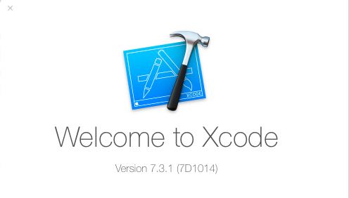

Guys I have updated xcode to 7.3.1 and now I receive this:

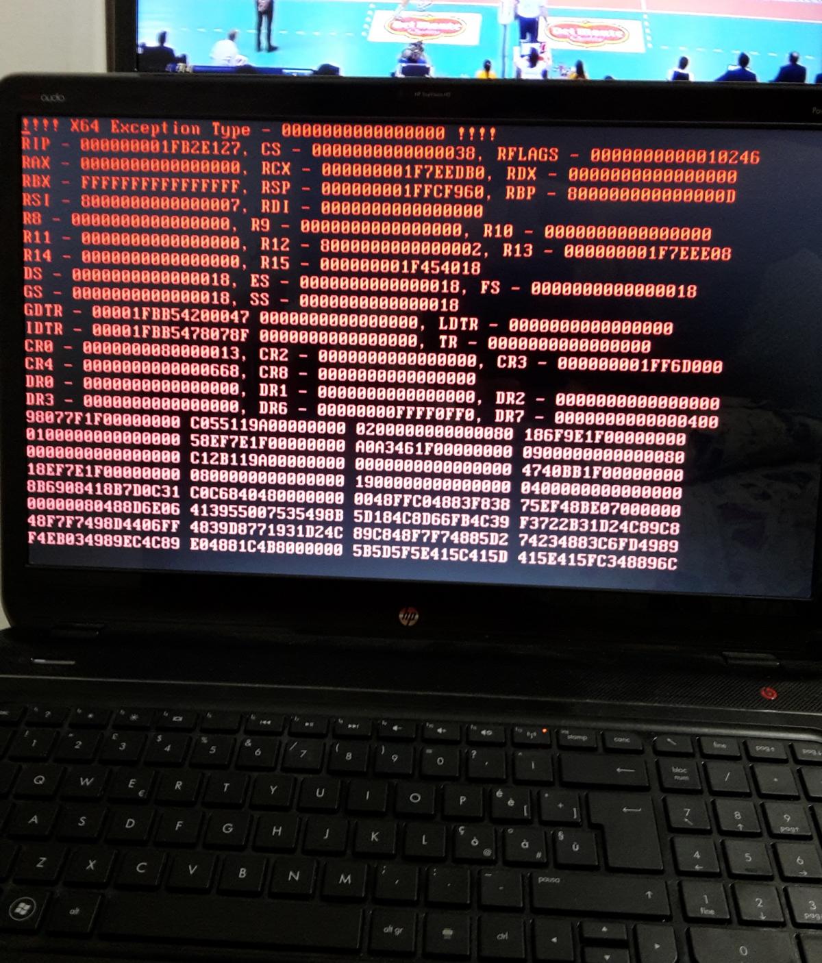

Build with: [Args: ./ebuild.sh -xcode5 -mc | Command: build -D USE_BIOS_BLOCKIO -D USE_LOW_EBDA -D CLANG -p Clover/Clover.dsc -a X64 -b RELEASE -t XCODE5 -n 5 | OS: 10.11.5 | XCODE: 7.3.1]
UEFI ok, boot6 ok, boot7 unfurtunately crash:
rev 3513

Clover 3513 (Compile XCODE7.3.1, OS X 10.11.5(15F31a)).
I don't have problems with loading boot7 on the desktop (Z77-ds3h) or on a laptop (N53sv).
(Clover on ESPHDD,ESPSSD,ESPUSBflash,USBflash)

Flag -mc usually requires --no-usb
Thanks, added but still crash  :(

Micky1979:  The exception is divide-by-zero, faulting instruction is '48F7F7' which is div rdx.
It comes from BlockIoDxe/BiosInt13.c function Edd11BiosReadBlocks, the following code
  if ((Lba + (BufferSize / BlockSize) - 1) > Media->LastBlock) {
    return EFI_INVALID_PARAMETER;
because BlockSize == Media->BlockSize == 0;
Looking over code I see this value comes BiosInitBlockIo call to Int13Extensions returns Bios->Parameters.BytesPerSector zero for some device.
Slice?

droples, the exception is triggered by BlockSize 0 being returned from Int 13 on Micky1979's system for one of the devices.  You can't reproduce it if your bios does not return such data.
