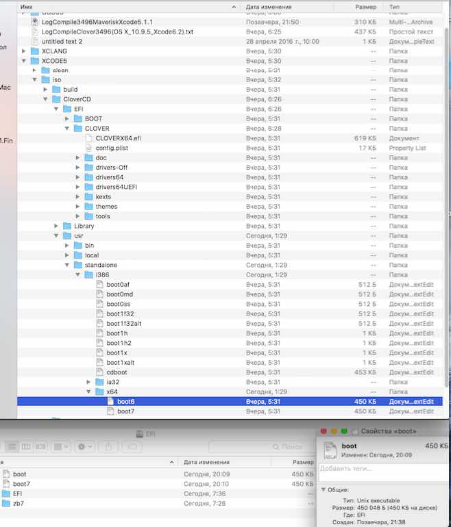

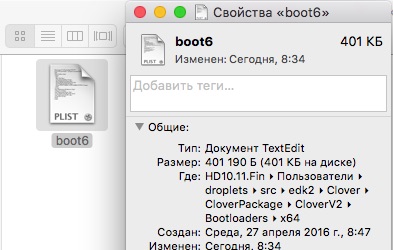

Clover3496.
I compiled clover 3496 (-t XCLANG,-t XCODE5,-t GCC53),using initially buildExtras.sh in the following systems - OS_X-10.9.5_Xcode6.2, OS_X-10.10.5_Xcode6.4,OS_X-10.11.4_Xcode7.3.
Boot the system  using boot6, boot7, UEFI succeeds.
I once again checked all.
Excuse me! I made a mistake.There are problems with Boot6 when compiling to OSX10.9.5 (Xcode4.6.2) and 10.10.5 (Xcode6.4) if you use the ToolChain XCODE5 . Everything else works.
Problems as in it's doing...[fill in blanks]...

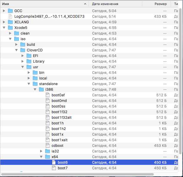

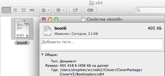

droples, chris1111, please post exact size of your boot6 that doesn't work.
Then please try this....
build with same compiler, but use --genpage option to ./ebuild.sh.  Note size of boot6 with --genpage, then check if it succeeds booting and if you encounter problems.

Ok this is the boot6
Now test --genpage
Is this normal its bif init T  :) not 6
But same result stuck at the same point
EDIT**
this is strange on El Capitan10.11.5 with the same compiler but Xcode 7.3  everything is perfect?
chris1111, 482816 = 471.5K is the size of --std-ebda.  But if --genpage ('T') does not give error message then ebda-overrun is not the cause of the hang.  It's something else.
What do you mean same compiler and Xcode 7.3?  They're both clang, but newer clang.  Can you upload the non-working boot6? I'll try to see if it hangs on my system too.

here the boot6

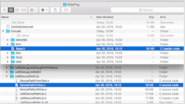

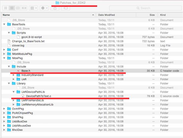

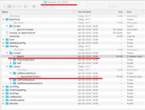

chris1111, droples: Do you have the latest Patches_from_EDK2 up-to-date?  Building with Xcode < 7.3 requires at least
MdePkg/Include/Base.h
MdePkg/Library/UefiDevicePathLib/DevicePathToText.c
to be patched.  Otherwise, it'll fail for sure.

I have these patches.
