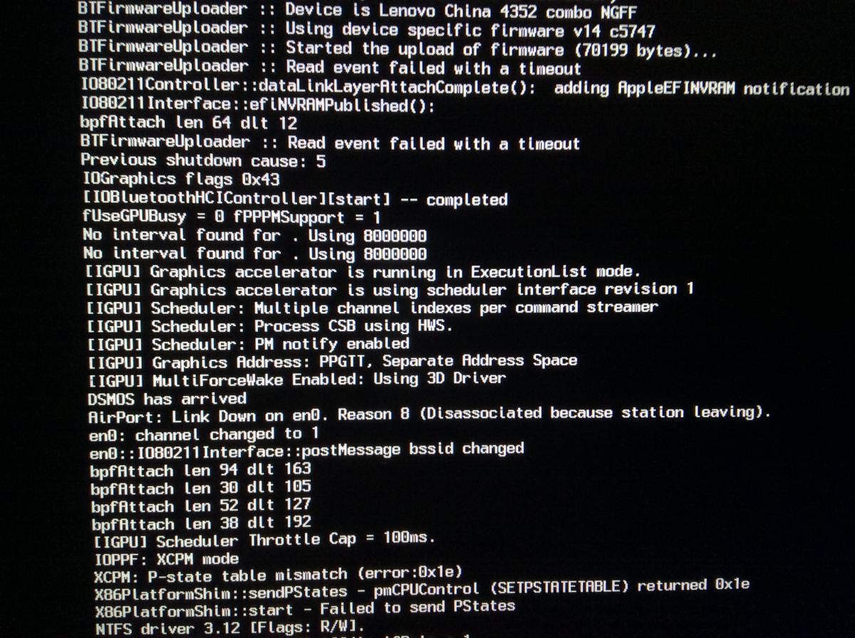

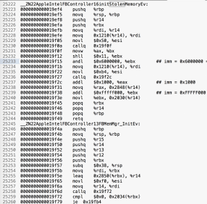

Austere.J Posted April 11, 2015 Share Posted April 11, 2015 I worked with @lisai9093 on this new Broadwell-based laptop. Hardware Configurations: i5-5200U with Intel HD Graphics 5500. / ALC3234 / BCM94352NGFF / 1920x1080 According to the kernel panic log, I figured out that the panic reason is "assertion failed minStolenSize <= fStolenMemorySize".So basically if we can pass this assertion, kernel panic will not happen and in theory framebuffer drivers will be loaded and our graphics cards will be happy. And actually it do work in this way.I tried to read the disassemble code and patch the AppleIntelBDWGraphicsFramebuffer binary on this Wednesday to pass the assertion and I succeeded, but IN A WRONG WAY, which led to that nothing shows up on the screen but a pointer. (It seems that I accidentally change the StolenFBMem to 0. (not sure)) (I should let this assertion always return true)According to the latest IOReg and verbose boot logs, Intel framebuffer drivers are loaded, the graphics card was recognized properly, the internal screen was detected correctly, the screen resolution seems right. (We used FakeID, hence the model in ioreg above shows Intel Iris Graphics 6100)So currently we get stuck here. I am not familiar with disassemble code and reverse engineering. (this is way beyond my current knowledge.)It will be great if someone can figure out which part of code is corresponding to the FBMemory assertion and patch it.Here is a quicklook of partial disassemble code of AppleIntelBDWGraphicsFramebuffer binary.And I guess offset 0x01a02c 0x01a02e OR 0x01a081 0x01a087 may be related to the FBMemory assertion. For the framebuffer data, you can check those in my blog. Framebuffer data extracted from AppleIntelBDWGraphicsFramebuffer binary Updated quick notes on this Broadwell-based laptop: Installation Notes: Hackintosh on a new laptop with Intel Broadwell processor Latest IOReg from this laptop: withBDWGraphicsPeter’s MacBook Pro(1).ioreg.zip Any suggestion will be great.Thanks in advance 1 Link to comment Share on other sites More sharing options...
vusun123 Posted April 11, 2015 Share Posted April 11, 2015 Rehabman and Piker should be here, for research purpose 1 Link to comment Share on other sites More sharing options...
intruder16 Posted April 11, 2015 Share Posted April 11, 2015 You'll need to increase "fStolenMemorySize" i think. Lowering fStolenMemorySize triggers that error. 1 Link to comment Share on other sites More sharing options...
Austere.J Posted April 11, 2015 Author Share Posted April 11, 2015 You'll need to increase "fStolenMemorySize" i think. Lowering fStolenMemorySize triggers that error. Yes, I know. But dell provides nothing in bios settings. For desktop, that will be easy. 1 Link to comment Share on other sites More sharing options...
intruder16 Posted April 11, 2015 Share Posted April 11, 2015 Yes, I know. But dell provides nothing in bios settings. For desktop, that will be easy. Correct. If you had a unlocked BIOS you could have had played with DVMT pre-alloc. It's still under development though. I don't have any more ideas. Lets see what others with same hardware says. Link to comment Share on other sites More sharing options...

lisai9093 Posted April 13, 2015 Share Posted April 13, 2015 So how did it go ? From my POV, when you change DVMT to 64MB, you need to use ig 0x16160002, right ? We did it! DVMT now is 64MB, confirmed in Windows. So Austere modified the fb to match 64MB in BIOS for 0x16160000. Then screen got garbled after restart. We fixed it by switching screen resolution to lower one and switch back. However, a new problem emerges: OS randomly freezes! I looked up the console and found it is cause by GPU hung. The logs are attached, one is from console, the other one from system report. Have no idea where the problem lies.... logs.zip Link to comment Share on other sites More sharing options...
