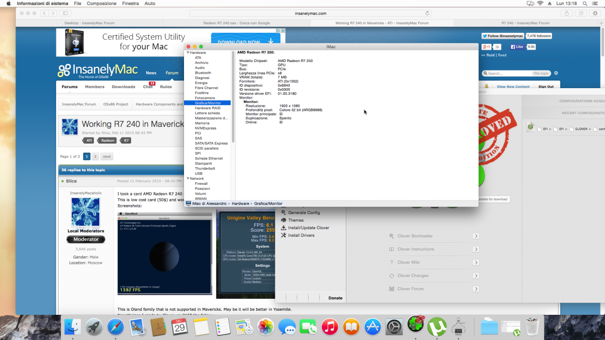

Did you patch Ati controller?
My monitor is VGA and im using HDMI converter its work normal but i can't get the qe/ci R7 240 DDR5 2Gb
No, I didn't patch anything. I did only those I said in the first post.
There may be a problem to get QE/CI by HDMI. The connector is not intended for 3D graphics.
You'd better look for DVI->VGA converter.

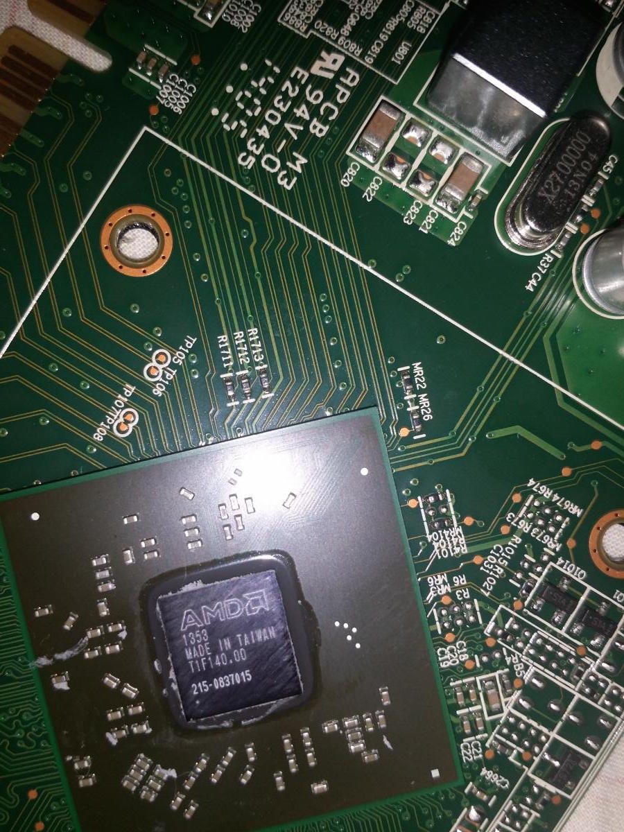

I tested with cI tested with clover , putting fakeid
This is the processor amd
in tin ffijfin the video card is a label that says 11202407
Make DSDT fix for Display
Apply DsdtFixMask=0x00000000 old way
And set FBName=Buri if this is mobile graphics.
