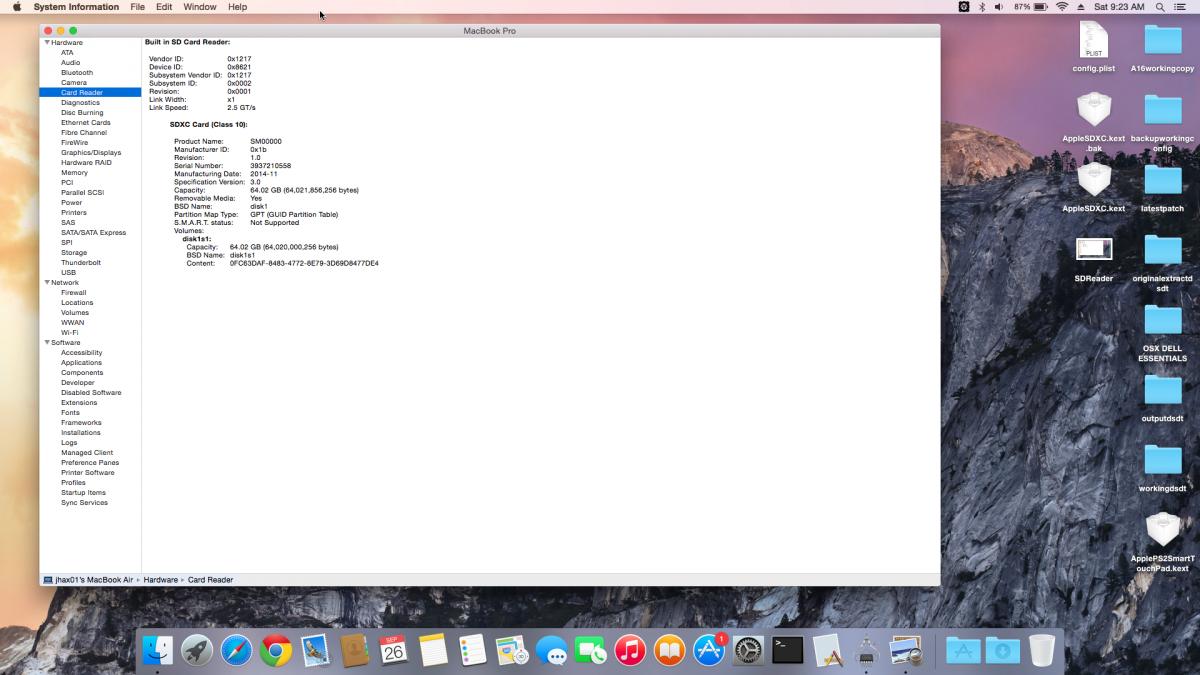

mac33 Posted September 22, 2015 Share Posted September 22, 2015 In case someone is looking for a solution for the micro sd slot on your Venue Pro: O2 Micro SD Fix This worked for my Venue Pro 11 7140. 1 Link to comment https://www.insanelymac.com/forum/topic/302665-guide-1010-yosemite-on-the-dell-venue-11-pro-core-ix/page/9/#findComment-2169577 Share on other sites More sharing options...
blankmac Posted September 26, 2015 Share Posted September 26, 2015 In case someone is looking for a solution for the micro sd slot on your Venue Pro: O2 Micro SD Fix This worked for my Venue Pro 11 7140. Confirmed, working on the Venue 11 Pro 7139! Thanks for this! 1 Link to comment https://www.insanelymac.com/forum/topic/302665-guide-1010-yosemite-on-the-dell-venue-11-pro-core-ix/page/9/#findComment-2170430 Share on other sites More sharing options...
