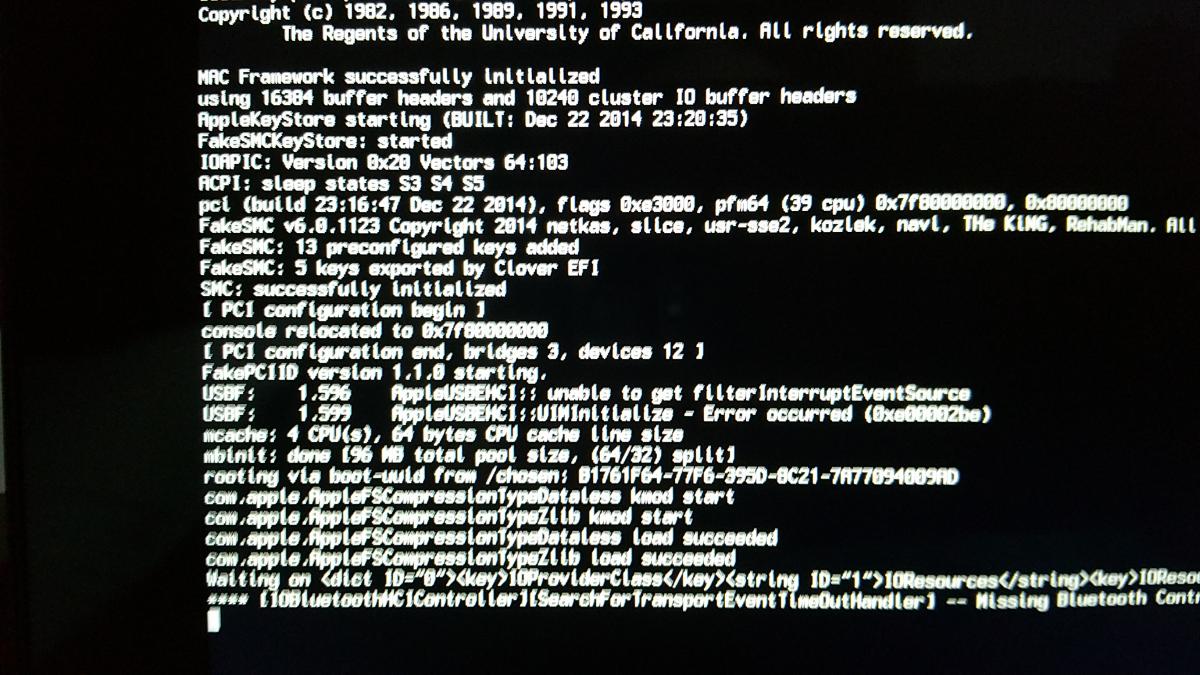

alex.daoud Posted March 11, 2015 Author Share Posted March 11, 2015 Ok, so no change when using an actual hard drive, regardless of whether its through a USB hub or directly plugged into the DV11. No combination of kexts or booting in safe mode changes the end result. It always fails at waiting for root device. Trying to boot without caches cause it to fail immediately without attempting a thing. I'm using 10.10.2 downloaded yesterday from the app store as my base and am creating the installer on a real mac. Since you guys have success with this particular setup, I'm starting to think that I have a motherboard variant or something. Here's a pic of my latest fail. I wish I knew more about this stuff, I can follow instructions with the best of them, but I'm pretty much useless at troubleshooting this type of install. GenericUSBXHCI.kext is not loading I believe. Here are a few ways to check: during the boot process, does the caps-lock light on the battery keyboard ever work? (try toggling it). Also try booting into single user mode, are you able to type? Also, what happens if you disable the USB 3.0 controller in the BIOS? Link to comment https://www.insanelymac.com/forum/topic/302665-guide-1010-yosemite-on-the-dell-venue-11-pro-core-ix/page/6/#findComment-2118794 Share on other sites More sharing options...
blankmac Posted March 11, 2015 Share Posted March 11, 2015 GenericUSBXHCI.kext is not loading I believe. Here are a few ways to check: during the boot process, does the caps-lock light on the battery keyboard ever work? (try toggling it). Also try booting into single user mode, are you able to type? Also, what happens if you disable the USB 3.0 controller in the BIOS? I think you're right, the caps lock light works in the bootloader, but does not during the boot process at any point. It also won't boot into single user mode -- fails at the same point. Weird. When the kexts get copied to the EFI partition, the perms get changed to 777 so it shouldn't be a permissions issue I wouldn't think, although I'm not able to change the user or group to root:wheel. I've tried it with USB 3.0 enabled/disabled to no avail. Is there a method to force it to load? Link to comment https://www.insanelymac.com/forum/topic/302665-guide-1010-yosemite-on-the-dell-venue-11-pro-core-ix/page/6/#findComment-2118798 Share on other sites More sharing options...

blankmac Posted March 13, 2015 Share Posted March 13, 2015 Ok, back from Europe and have a little time to work on this. I put the Venue in airplane mode, lo and behold there's an attempt to load a kext related to USB. Still gets an error and eventually times out with "waiting for root device" regardless of whether it's an actual drive or USB thumbdrive. Pic attached, any thoughts on what I should try next? Link to comment https://www.insanelymac.com/forum/topic/302665-guide-1010-yosemite-on-the-dell-venue-11-pro-core-ix/page/6/#findComment-2119623 Share on other sites More sharing options...

blankmac Posted March 14, 2015 Share Posted March 14, 2015 Triple checked everything, tried every bios option/USB hub port/USB device option I can think of to no avail. Either the kext fails during loading or doesn't attempt to load at all. I think I'm going to try a more hybrid approach. I was able to install OS X initially using Un**east, but after installation, I couldn't boot to the drive to get clover installed. Or rather, it would eventually boot to the desktop, but everything was frozen up, etc. I'm going to try installing via my first method and then try using my clover install drive to try booting the internal ssd. Thanks for all your assistance. Link to comment https://www.insanelymac.com/forum/topic/302665-guide-1010-yosemite-on-the-dell-venue-11-pro-core-ix/page/6/#findComment-2119647 Share on other sites More sharing options...
blankmac Posted March 14, 2015 Share Posted March 14, 2015 This is unbelievably frustrating. OS X is successfully installed. Utilizing @Altleet's config and clover settings, my OSX partition boots like lightning; however, USB is still not functioning and I cannot use a mouse or keyboard of any type. I don't see how it could be the USB drive or the copy of GenericUSBxHCI -- I have used multiples of each. I can only guess that there is some subtle difference in my motherboard or I have something set differently in my BIOS that is not immediately obvious to me. If you guys have any other random thoughts, throw them out there, I'm so close I can almost taste it. Link to comment https://www.insanelymac.com/forum/topic/302665-guide-1010-yosemite-on-the-dell-venue-11-pro-core-ix/page/6/#findComment-2119665 Share on other sites More sharing options...

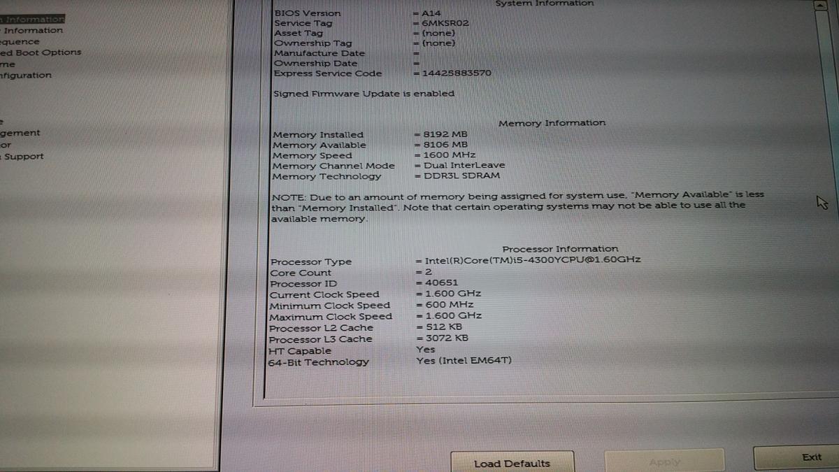

blankmac Posted March 16, 2015 Share Posted March 16, 2015 Somewhat in order: Boot Options: - Enable Legacy Option ROMs is checked. USB: - Boot Support is checked - Enable External USB Port is checked. - Enable USB 3.0 controller is checked. - Enable USB Powershare is NOT checked. Audio: - Enable Audio is checked. Miscellaneous: - Enable Microphone is checked - Enable Media Card is selected - Enable Camera is checked Security - The only thing that is enabled is CPU XD Support Secure Boot is disabled Performance - MultiCore Support is set to all - Intel Speedstep is enabled - C-states Control is enabled - Intel Turboboost is enabled - HyperThread control is enabled - Rapid Start Technology is NOT enabled Nothing is enabled under Power Management and the battery charge is set to adaptive POST behavior - Adapter warnings are NOT enabled - Fastboot is set to Thorough Virtualization Support - Virtualization is enabled - VT for Direct I/O is enabled Wireless Device Enable - WWAN, Bluetooth, and WLAN/WiGig are enabled - NFC is NOT enabled My model also has the fingerprint scanner as well as a SmartCard reader tho I use neither. I have an SD card in the slot and upgraded the hard drive to a 512GB model. Probably a shot in the dark, but if you guys see something different than what you're using, let me know and I'll match your settings to see if it makes a difference. Link to comment https://www.insanelymac.com/forum/topic/302665-guide-1010-yosemite-on-the-dell-venue-11-pro-core-ix/page/6/#findComment-2120292 Share on other sites More sharing options...
