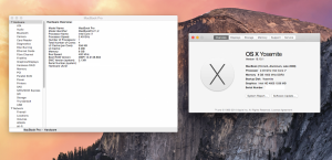

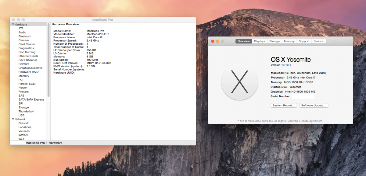

expertmac2 Posted January 4, 2015 Share Posted January 4, 2015 @expertmac2, At the moment no. ProductName in config.plist/SMBIOS can be MBP 11,x while using all other IDs from your MacBook 2008. However, if you want to go the cloning route, it is probably a good idea to take extra precautions to make the hack as close as possible to the original Mac and not have both machines logged in at the same time - see post#377 in AIO guides. Thank you, it worked perfectly! I went the extra cautious route and changed board-id and system serial in addition to the system ID. My About My Mac no longer has extra details like "Retina, late 2013" alongside "MacBook Pro" though, which is a little bit weird. Never mind, now my About My Mac shows that my Hack is the same model as my original MacBook! System Information's Hardware Overview still shows that i'm a MacBookPro11,2 though. 1 Link to comment Share on other sites More sharing options...
fusion71au Posted January 4, 2015 Share Posted January 4, 2015 @expertmac2, Everything looks OK . System serial determines the Mac model you see in the "About" screen but "ProductName" in config.plist/SMBIOS determines how the hack actually functions in OSX. LOL, thats one powerful MacBook 2008 . Link to comment Share on other sites More sharing options...
