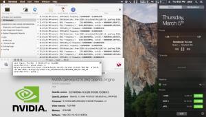

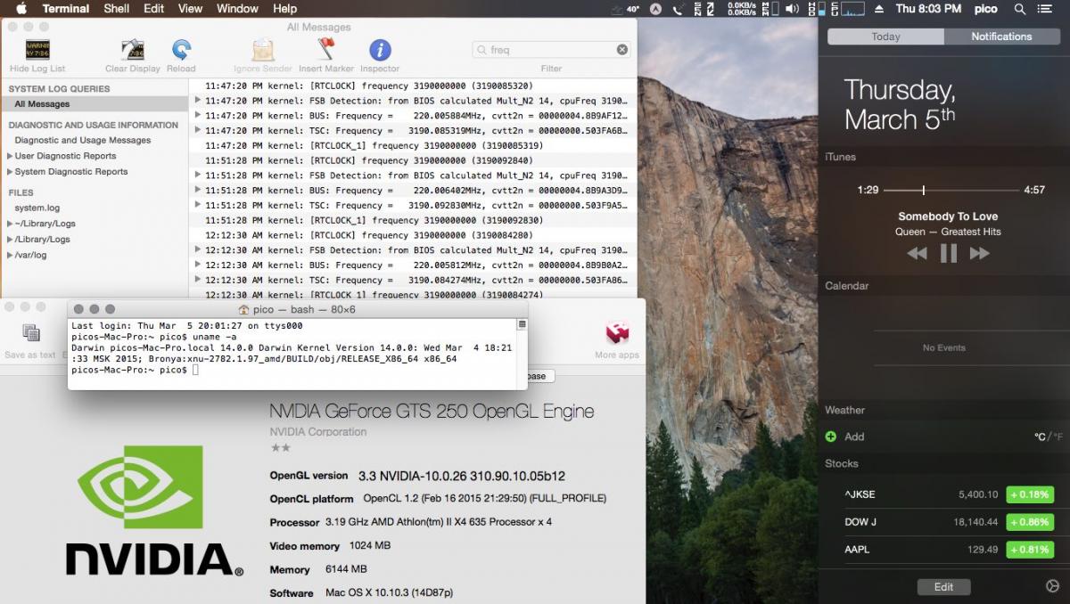

pico joe Posted March 5, 2015 Share Posted March 5, 2015 bronya_rc6 : no problem here too .. boot with Clover and Chameleon (didn't try with bronya "boot") 1 Link to comment Share on other sites More sharing options...

pico joe Posted March 6, 2015 Share Posted March 6, 2015 @Bronya, yes.. Those setting is correct.. Overclocked 10% so the bus speed is 220.. No problem issue too with the sound 1 Link to comment Share on other sites More sharing options...

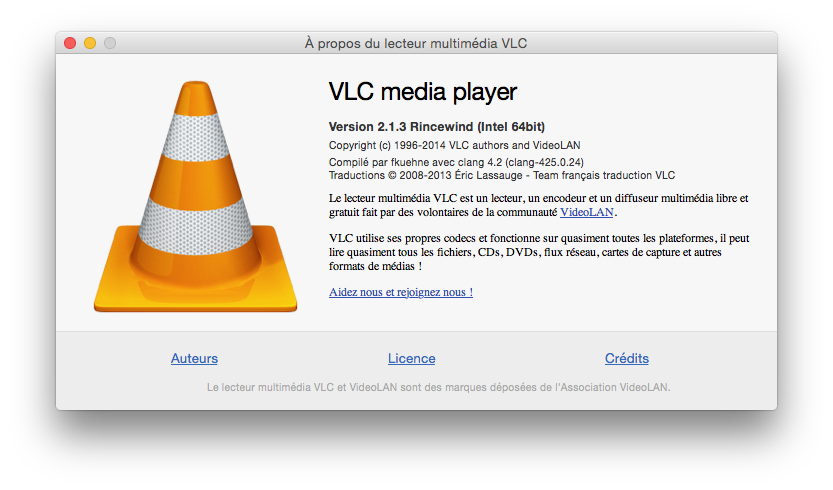

FlowLive Posted March 9, 2015 Share Posted March 9, 2015 Ok . Fixed tsc.c , rtclock.c ,opemu.c and trap.c. Is tested and is normal works without "opcode invalid ". But it can get problem sound ! On FX-cpu sound fine , but on old-cpus have problem sound . I will try did plan - this tsc.c will read fsb from bootloader . mach_10.10_all_amd_rc6.zip P.S. I tested vlc player version 2.0.9 on real iMac12,2 . I indeed received problem sound also how on AMD !!! Because vlc player version 2.0.9 - this vlc_player bad ! VLC version 2.1.2 is normal . Hi Bronya, the file isn't available anymore... can you repost? Thanks! Link to comment Share on other sites More sharing options...
gils83 Posted March 9, 2015 Share Posted March 9, 2015 10.10/10.10.1 UPD To 10.10.2/3 Patch Path: /System/Library/Extensions/pthread.kext thanks but invalid opcode on kabini Link to comment Share on other sites More sharing options...
gils83 Posted March 10, 2015 Share Posted March 10, 2015 Ok . Fixed tsc.c , rtclock.c ,opemu.c and trap.c. Is tested and is normal works without "opcode invalid ". But it can get problem sound ! On FX-cpu sound fine , but on old-cpus have problem sound . I will try did plan - this tsc.c will read fsb from bootloader . mach_10.10_all_amd_rc6.zip P.S. I tested vlc player version 2.0.9 on real iMac12,2 . I indeed received problem sound also how on AMD !!! Because vlc player version 2.0.9 - this vlc_player bad ! VLC version 2.1.2 is normal . hello Bronya no problem audio vlc / QuickTime / MPlayerX works very good look and listen video test_mediaplayer.mp4.zip 1 Link to comment Share on other sites More sharing options...

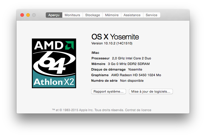

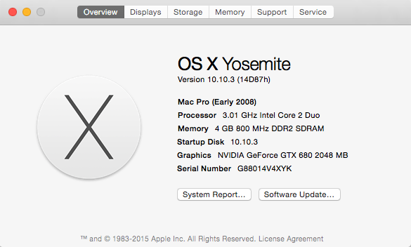

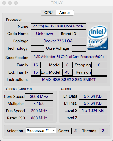

jsl Posted March 10, 2015 Share Posted March 10, 2015 10.10/10.10.1 UPD To 10.10.2/3 Patch Path: /System/Library/Extensions/pthread.kext Thanks for such an excellent kernel and kext which are working in 10.10.2 and 10.10.3 for my AMD Hackintosh with Asus M4A78 Plus MB, AMD Athlon 64 X2 6000+, and Nvidia GTX 680 GPU. Link to comment Share on other sites More sharing options...

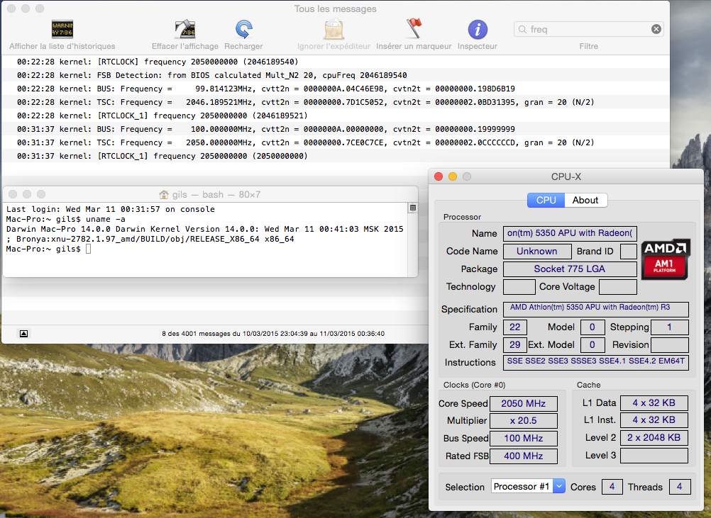

Bronya Posted March 10, 2015 Share Posted March 10, 2015 Hi ! This kernel rc7 read busFreq from only bootloader ! In trap.c delete "invalid rdmsr" and implement in opemu.c ! Bootloader chameleon version 2594 ! Please try ! mach_10.10_all_amd_rc7.zip Kernel mach_rc6 reupload in post #1036 ! 6 Link to comment Share on other sites More sharing options...
gils83 Posted March 10, 2015 Share Posted March 10, 2015 Hi ! This kernel rc7 read busFreq from only bootloader ! In trap.c delete "invalid rdmsr" and implement in opemu.c ! Bootloader chameleon version 2594 ! Please try ! mach_10.10_all_amd_rc7.zip Kernel mach_rc6 reupload in post #1036 ! hello , the kernel work good but fsb is not good 100 Mhz au lieu de 99,80 Mhz Link to comment Share on other sites More sharing options...
Bronya Posted March 11, 2015 Share Posted March 11, 2015 This external viewer. Example 100.0(99. 8). :-) Today will fix. 2 Link to comment Share on other sites More sharing options...

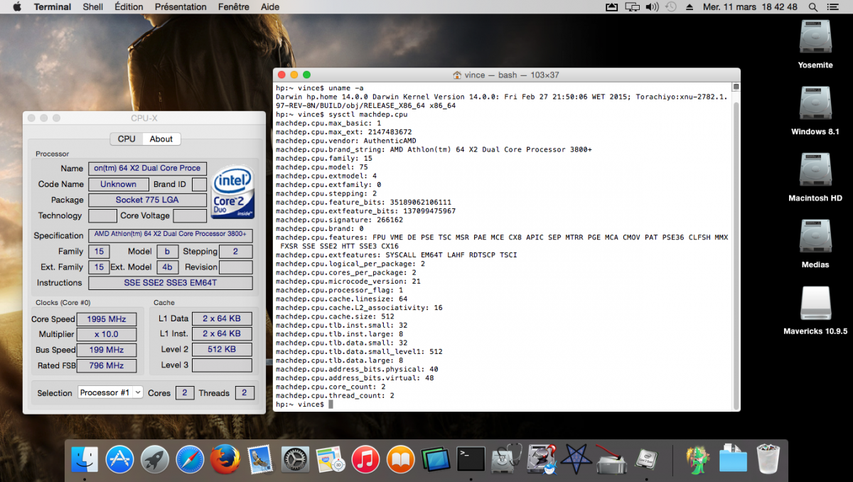

polyzargone Posted March 11, 2015 Share Posted March 11, 2015 Finally ! With 1010-kernel-REV-8N and 10102-UPD-Patch-pthread.kext, my Athlon 64 x2 3800+ works good with 10.10.2 and latest Security Update ! Great works and many thanks to all of you I just still have a little anoying problem with Time Sync… The clock doesn't update as it should. But I can manage that as it's not essential. 1 Link to comment Share on other sites More sharing options...
