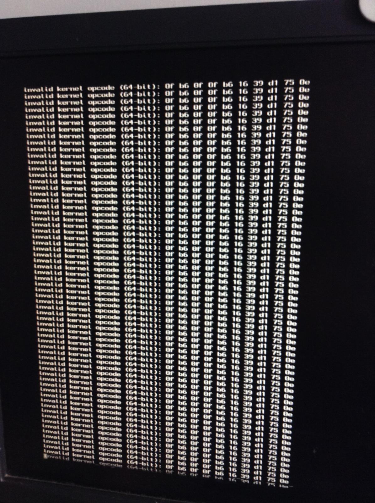

Meetesh Posted February 20, 2015 Share Posted February 20, 2015 I think invalid opcode 64 is the bootoader problem chameleon : opcode error (works good with fsb and bus ratio)enoch : works good (sound stuttering without fsb and busratio)Phenom ii x6 1055t @ 2.8GHZ - 4GHZ, all the frequencies work great but need to type fsb and bus ration what do you think ?? Link to comment Share on other sites More sharing options...

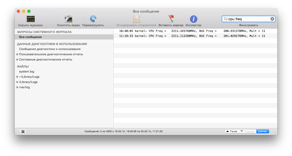

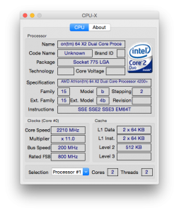

lpukraine Posted February 20, 2015 Share Posted February 20, 2015 I Divided into two code test it I tested two versions of this build. V1: no opcode 64 error), working well for me. but not quite right detect my fsb: my fsb=200 and busratio=11 V2: Opcode 64 error is present: Should I continue to use 1010-REV-8D or begin to use V1 of 1010-REV-8H? What difference between them for me? Link to comment Share on other sites More sharing options...

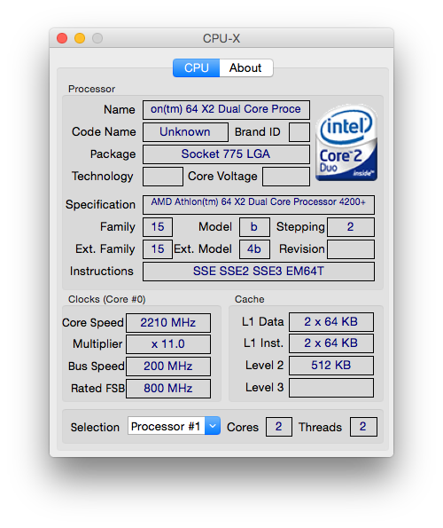

Meowthra Posted February 20, 2015 Share Posted February 20, 2015 I tested two versions of this build. V1: no opcode 64 error), working well for me. but not quite right detect my fsb: Снимок экрана 2015-02-20 в 11.22.45.png my fsb=200 and busratio=11 V2: Opcode 64 error is present: 2015-02-20 11.25.56.jpg Снимок экрана 2015-02-20 в 11.31.35.png Should I continue to use 1010-REV-8D or begin to use V1 of 1010-REV-8H? What difference between them for me? Hi lpukraine Real CPU Frequency Bus Speed is floating Not fixed 200 MHz On the Windows detected same result FSB(HT-Link) I don’t know where to modify I will try to fix reference Intel/AMD manual again You can use CPU-Z Dump AM2 CPU 「CPU-Z TXT Report」 Upload ?? And TEST It I probably know where the error I would like to further confirm Reduce error range 1010-REV-8I.zip 1010-REV-8I.diff.zip 4 Link to comment Share on other sites More sharing options...

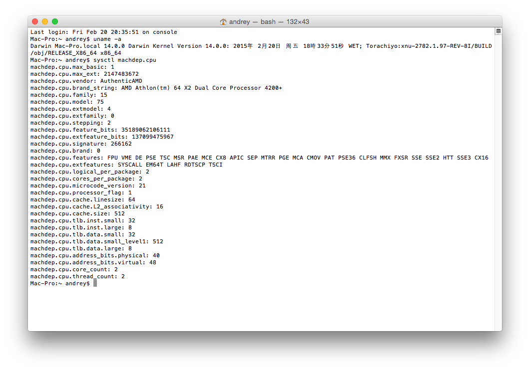

Meowthra Posted February 20, 2015 Share Posted February 20, 2015 Can USE CPU-X Screen shots ?? or Open Terminal $ sysctl machdep.cpu Thanks Link to comment Share on other sites More sharing options...
Meetesh Posted February 20, 2015 Share Posted February 20, 2015 here Link to comment Share on other sites More sharing options...

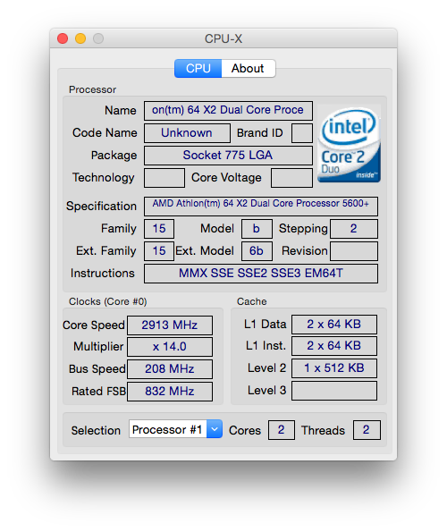

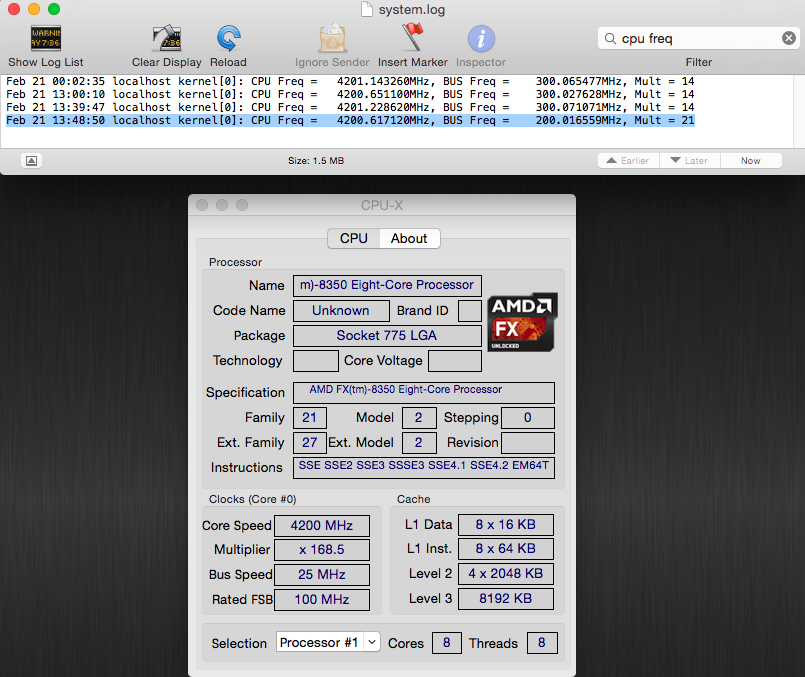

Mr___G Posted February 21, 2015 Share Posted February 21, 2015 For some reason Console reports correct but CPU-X stays the same ? FX8350 1 Link to comment Share on other sites More sharing options...
gils83 Posted February 21, 2015 Share Posted February 21, 2015 For some reason Console reports correct but CPU-X stays the same ? FX8350 Screen Shot 2015-02-21 at 13.51.17.png use Clover for cosmetic thread and speed Link to comment Share on other sites More sharing options...
Mr___G Posted February 21, 2015 Share Posted February 21, 2015 use Clover for cosmetic thread and speed Thanks Bro, will give it a shot !!! Link to comment Share on other sites More sharing options...

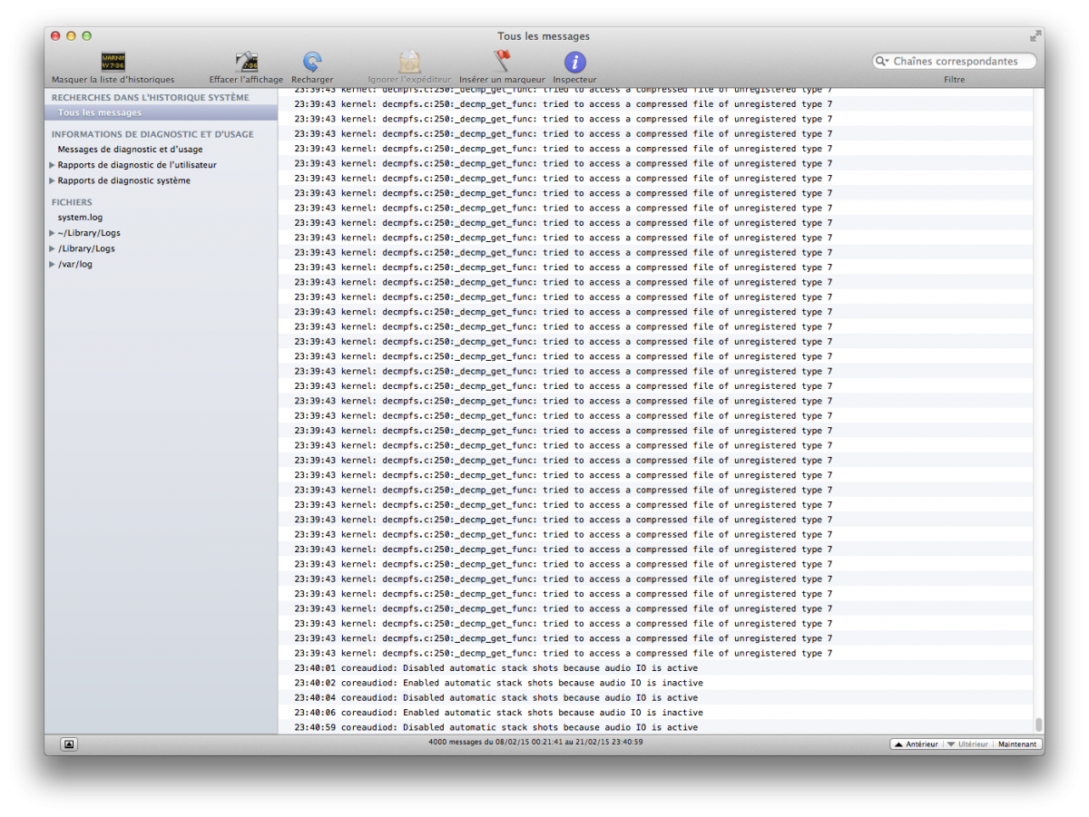

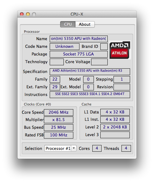

Bronya Posted February 21, 2015 Share Posted February 21, 2015 HI ! I tested sound on 10.8.5, 10.9.5 and 10.10 on my Athlon II X2 250 ! I have problem sound - "First, the audio plays and stops and again reproduced" . This is due to the power of the processor . But it could be a brake problem in the system or in the kernel ! On 10.7.5 not problem sound ! This strange ! If in cpu-x wrong freq - this problem only chameleon bootloader . I can fix this . 5 Link to comment Share on other sites More sharing options...
Bronya Posted February 21, 2015 Share Posted February 21, 2015 Try bootlooader rev.2583 and kernel for 10.8.5 ! I fix chameleon and implement for FX and k11 . And please check freq in cpu-x on FX . And check sound ! )) In archive include boot . ) This only beta ))) xnu-2050.48.11_10.8.5_rc6.zip 2 Link to comment Share on other sites More sharing options...
gils83 Posted February 21, 2015 Share Posted February 21, 2015 hello Bronya , audio crackle and fsb no fix . Link to comment Share on other sites More sharing options...

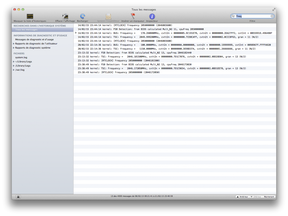

Bronya Posted February 22, 2015 Share Posted February 22, 2015 Hi gils83 , screenshot CPU-X ) Link to comment Share on other sites More sharing options...
gils83 Posted February 22, 2015 Share Posted February 22, 2015 Link to comment Share on other sites More sharing options...
Bronya Posted February 22, 2015 Share Posted February 22, 2015 gils83, i no did for cabini . Soon. ) Link to comment Share on other sites More sharing options...

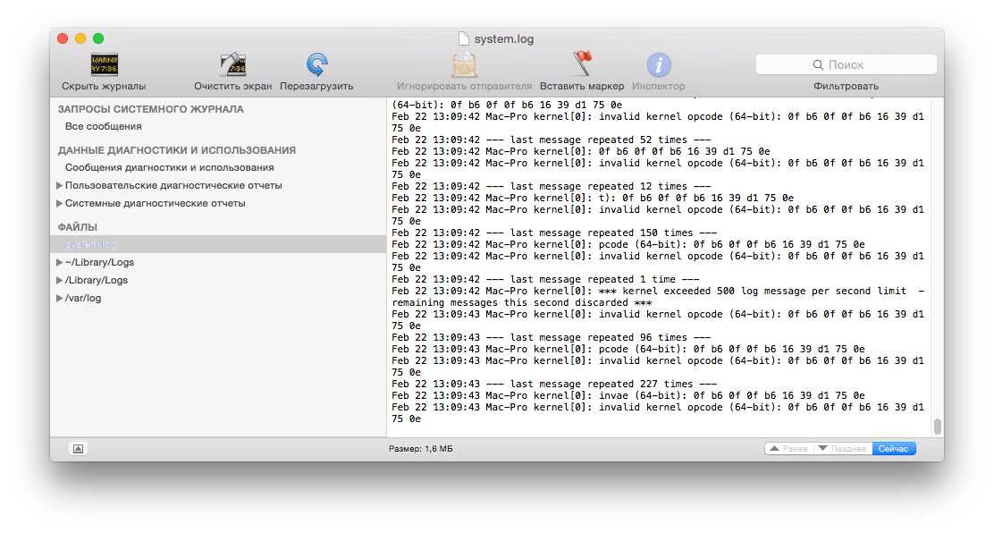

lpukraine Posted February 22, 2015 Share Posted February 22, 2015 TEST K8 invalid kernel opcode (64-bit) This situation will arise only K8 CPU opcode 64 error Link to comment Share on other sites More sharing options...

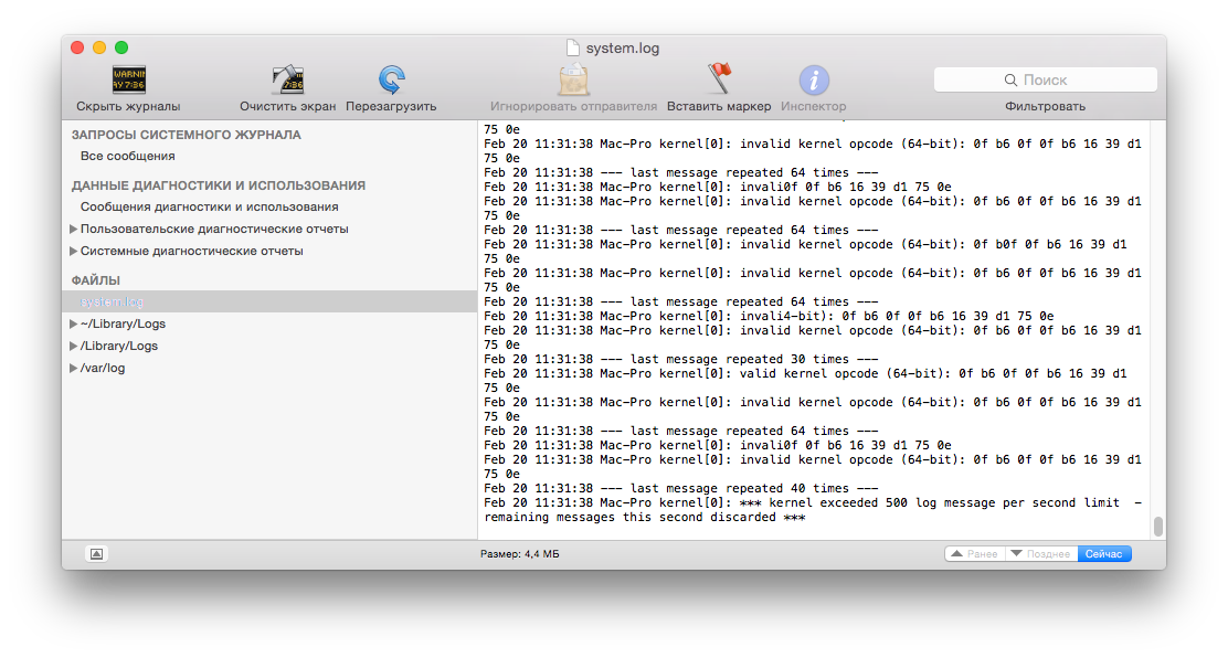

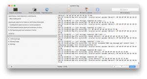

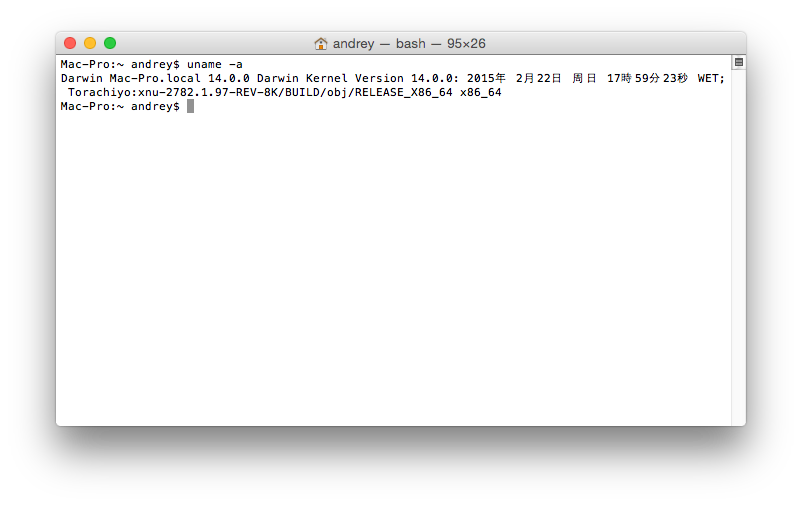

Meowthra Posted February 22, 2015 Share Posted February 22, 2015 opcode 64 error Снимок экрана 2015-02-22 в 13.11.57.png Снимок экрана 2015-02-22 в 13.09.38.png Because K8 missing some instruction Pointer type don’t allow 64bit to 32bit Perhaps it can be said that my mistake Kernel compiled I need to pay attention to whether there is 64Bit to 32 bit register opcode RETEST V1 & V2 Thanks 1010-REV-8L.zip 1010-REV-8L.diff.zip 3 Link to comment Share on other sites More sharing options...
lpukraine Posted February 22, 2015 Share Posted February 22, 2015 Because K8 missing some instruction Pointer type don’t allow 64bit to 32bit Perhaps it can be said that my mistake Kernel compiled I need to pay attention to whether there is 64Bit to 32 bit register opcode RETEST V1 & V2 Thanks My results: V1: System boots successfully with opcode error, works normally. A lot of opcode error in log. V2: System boots successfully and no opcode error. Seems that boot and work faster. Will use this kernel and will give you feedback if find any error. Thanks! 1 Link to comment Share on other sites More sharing options...
