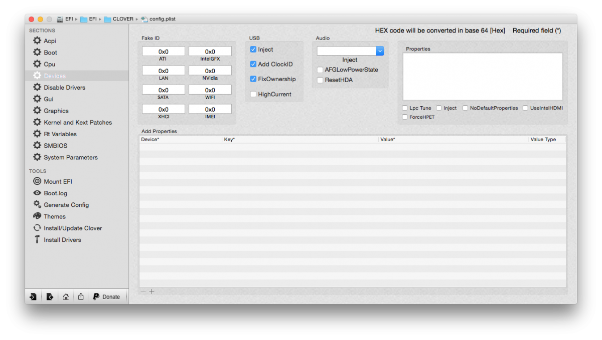

Make sure nothing is in the audio inject field of the devices panel.

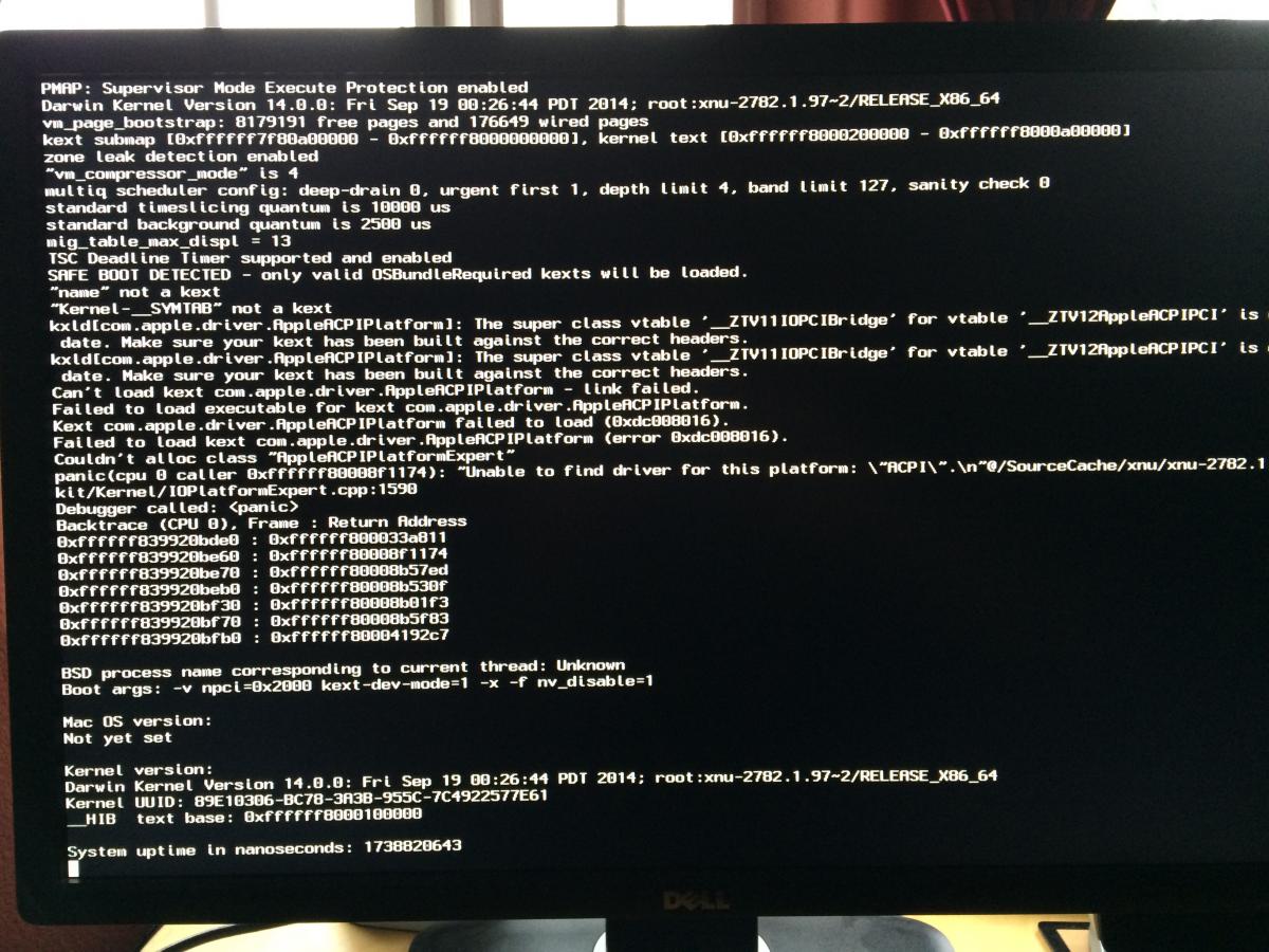

When trying to install from usb I get stuck here(attached). Looks to me like appleacpiplatform is the issue.  I tried booting with -x for safe and also tried -f thinking I may have had a cache issue. Then I just tried combinations of ge=yes and nv_disable=1 which I should not need for my 640.  I will say i screwed up trying to patch the kernel - got a bunch of errors.  Knowing that was bad, i copied the kernel from another USB and patched that one (went through without issue).  I did move the clean (patched) kernel using finder, is there something about needing to patch in place that i broke?...(yes grabbing at straws)
$ sudo perl -pi -e 's|\x74\x11\x83\xF8\x3C|\x74|\x11\x83\xF8\x3F
> sudo perl -pi -e 's|\x74\x11\x83\xF8\x3C|\x74\x11\x83\xF8\x3F|g' /volumes/usb/system/library/kernels/kernel
sudo perl -pi -e 's|\x74\x11\x83\xF8\x3C|\x74\x11\x83\xF8\x3F|g' /Volumes/USB/System/Library/Kernels/kernel
-bash: g /volumes/usb/system/library/kernels/kernel
sudo perl -pi -e s: No such file or directory
-bash: x11x83xF8x3F: command not found
-bash: x74x11x83xF8x3C: command not found
-bash: x74x11x83xF8x3F: command not found
-bash: x74: command not found
Password:
Backslash found where operator expected at -e line 1, near "s|\x74\x11\x83\xF8\x3C|\x74|\"
Backslash found where operator expected at -e line 1, near "x11\"
Backslash found where operator expected at -e line 1, near "x83\"
Backslash found where operator expected at -e line 1, near "xF8\"
syntax error at -e line 1, near "s|\x74\x11\x83\xF8\x3C|\x74|\"
Substitution replacement not terminated at -e line 2.
I know I missed something (probably very simple). Suggestions on where to start.  if nothing is obvious i can go back to scratch assuming it was my kernel patch fiasco that did me in

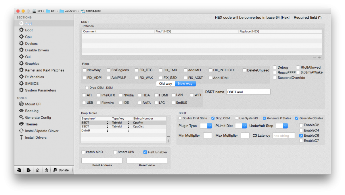

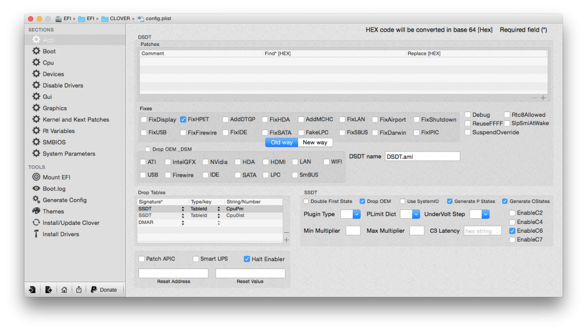

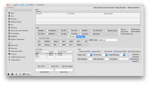

Can you help me then Cindori?  Would you mind letting me know what initial Clover settings you installed with and also mind posting your config.plist as a reference?  I am hitting this error:
OsxAptioFixDrv: AllocateRelocBlock (): can not allocate relocation block (0x16439 pages below 0x10000000): Not Found
Not sure about your error. You installed clover to your HD right?
My settings for clover:

BS_Code    0000000010000000-000000001000AFFF 000000000000000B 000000000000000F
to get larger available space. Sometimes such small areas can be released without issues.
You can do it by using OsxLowMemFix driver, but with few tricks:
1. edit OsxLowMemFix/OsxLowMemFixDrv.c and change line 48 from
#define KERNEL_TOP_ADDRESS 0x10000000 // 256MB
to
#define KERNEL_TOP_ADDRESS 0x20000000
2. compile Clover and you'll get OsxLowMemFix.efi
3. rename it to something else, for example Test.efi - this is needed since Clover will not load both OsxLowMemFix and AptioFix
4. try to boot with Test.efi and AptioFix in drivers64UEFI
But according to Rampagedev in the latest version of clover this error was fixed.
But not for the Asus x99 E-WS :(
Fixed for the Asus x99 Deluxe and other boards but not the baddest board on the market atm.
